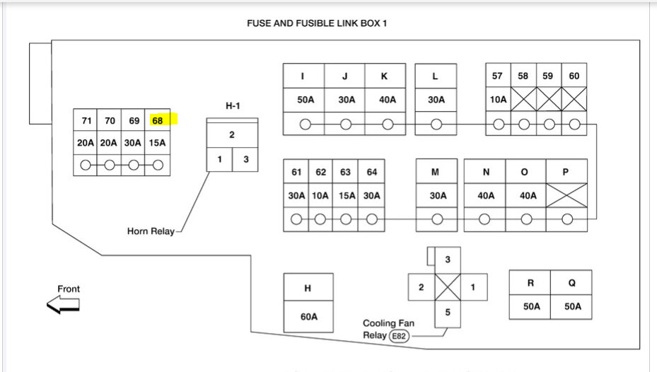

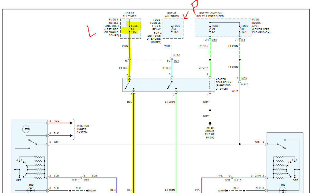

There is a fuse for the driver's side and a different one for the passenger side. I attached a few pics below. The first picture shows the location of the fuses. Check fuse 68 in the fuse/relay box under the hood, left side. Make sure there is power to and from it as well.
If the fuse checks out to be good, check the red wire under the seat which powers the heater.
Let me know what you find.

Fuse is good. I am not sure what red wire that you are referring to, but everything looks connected. I sent a video.

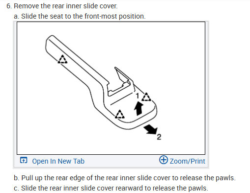

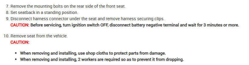

In order to check the control module for seat climate control, I will need to remove the seat. Do you have any instructions on driver seat removal or a way to check and if necessary, swap out the module?

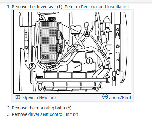

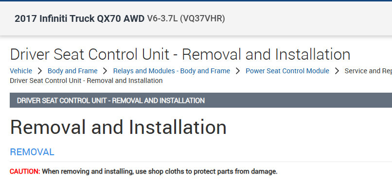

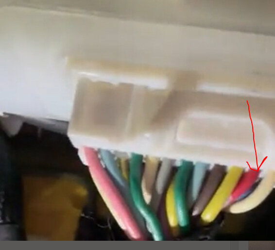

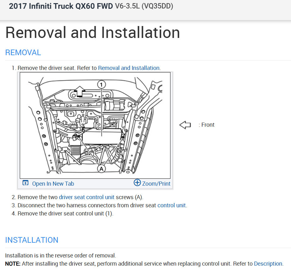

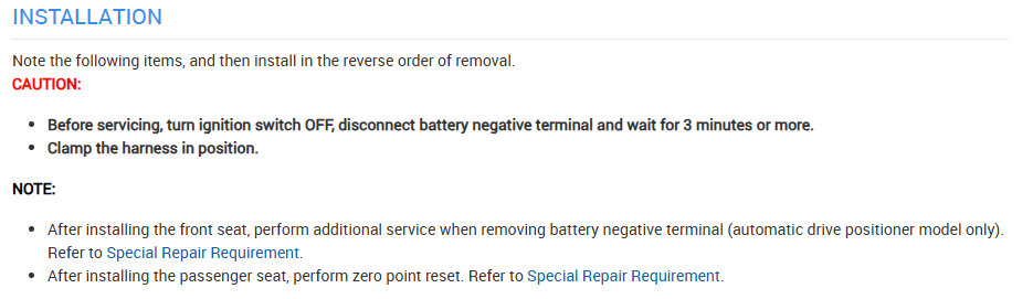

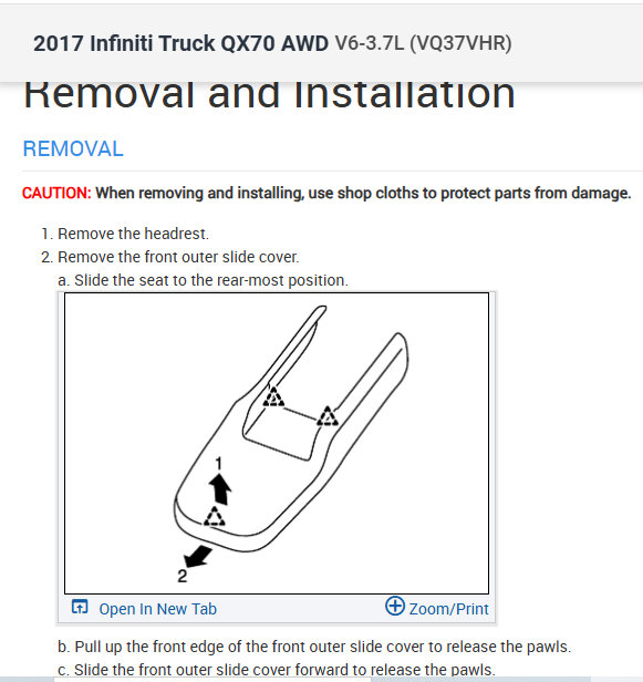

I copied from your video a pic. I have an arrow pointing to the red wire in question. Check to see if there is power present.

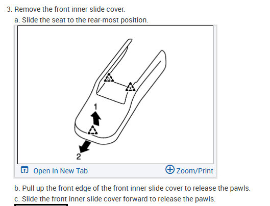

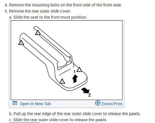

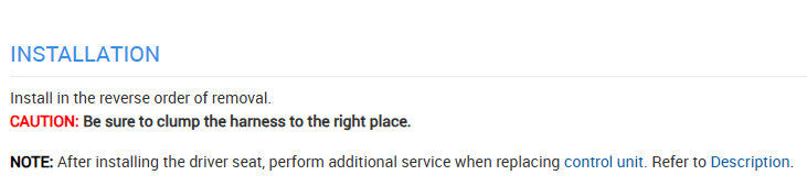

Next, I attached the directions below for removing the seat. The last three pics below are for the removal of the seat module.
Take a look and let me know if this helps.

I did not receive a picture showing the red wire to check. It is impossible to check any of the red wires without removing the seat to gain access. Unless you have a trick.
Dec 5, 2024 at 2:28 PM
  • 110,246 POSTS
I attached the picture below. Based on the picture, you should be able to reach the wire. If not, the seat will need to be removed.
Dec 6, 2024 at 9:56 AM
TOMR48
  • 16 POSTS
Yes there is power. I had to unplug the module to measure. While the module was unplugged, I lost control of seat adjustments. So, is this the correct wire? Next step?

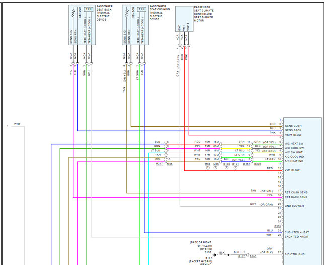

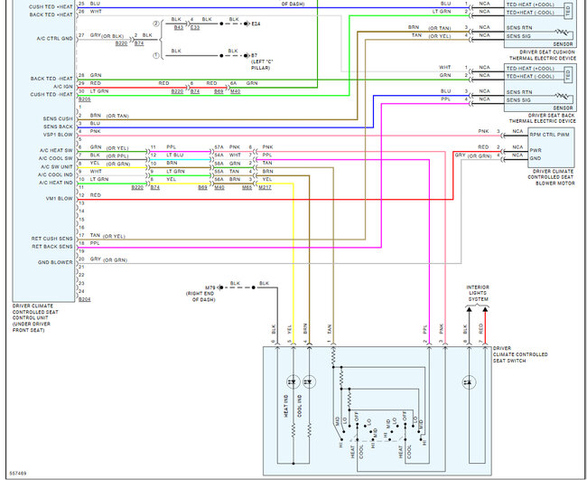

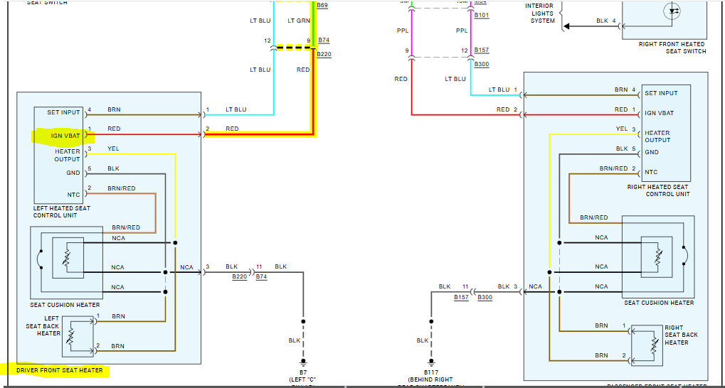

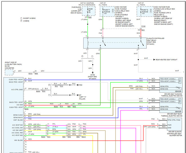

Yes, a shorted heating element or a fault in the seat heating/cooling circuit can prevent the seat control switch from functioning or lighting up. The driver and passenger seat modules are not interchangeable. Here are the wiring diagrams so you can see how the system works and a guide to help you check the wiring connections:
Dec 12, 2024 at 10:13 AM

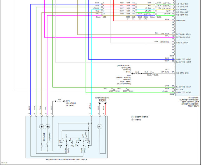

"other modules"? I am not sure what other modules you mean, there are only the seat modules in this system. You can use a voltmeter to test through the switch by looking at the wiring daigrams. Use the guide above to see how to test.

I noticed that the wiring diagrams that you sent all say passenger. Is the driver side is different because you told me that the control modules were not interchangeable.
Dec 14, 2024 at 4:48 AM
  • 55,583 POSTS
Please look again, the wiring is for both and you will notice the wiring is different from side to side.

Is my seat heated by the gentherm with blown air or are there wires in the cushions? No wiring diagrams show wires to cushion or seat back only to TED seat and TED cushion. Are both Ted’s in the same module under the seat. So how do I test if Ted is bad vs climate control module? Are both passenger and driver the same?
Dec 16, 2024 at 12:44 AM
  • 55,583 POSTS
The seat heating and cooling system is typically controlled by Thermoelectric Devices. These will be the same seat to seat. Have you run a CAN scan to see if any codes are present? You can get a CAN scanner (Controller Area Network) which will work on most cars from Amazon.
