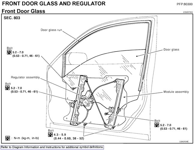

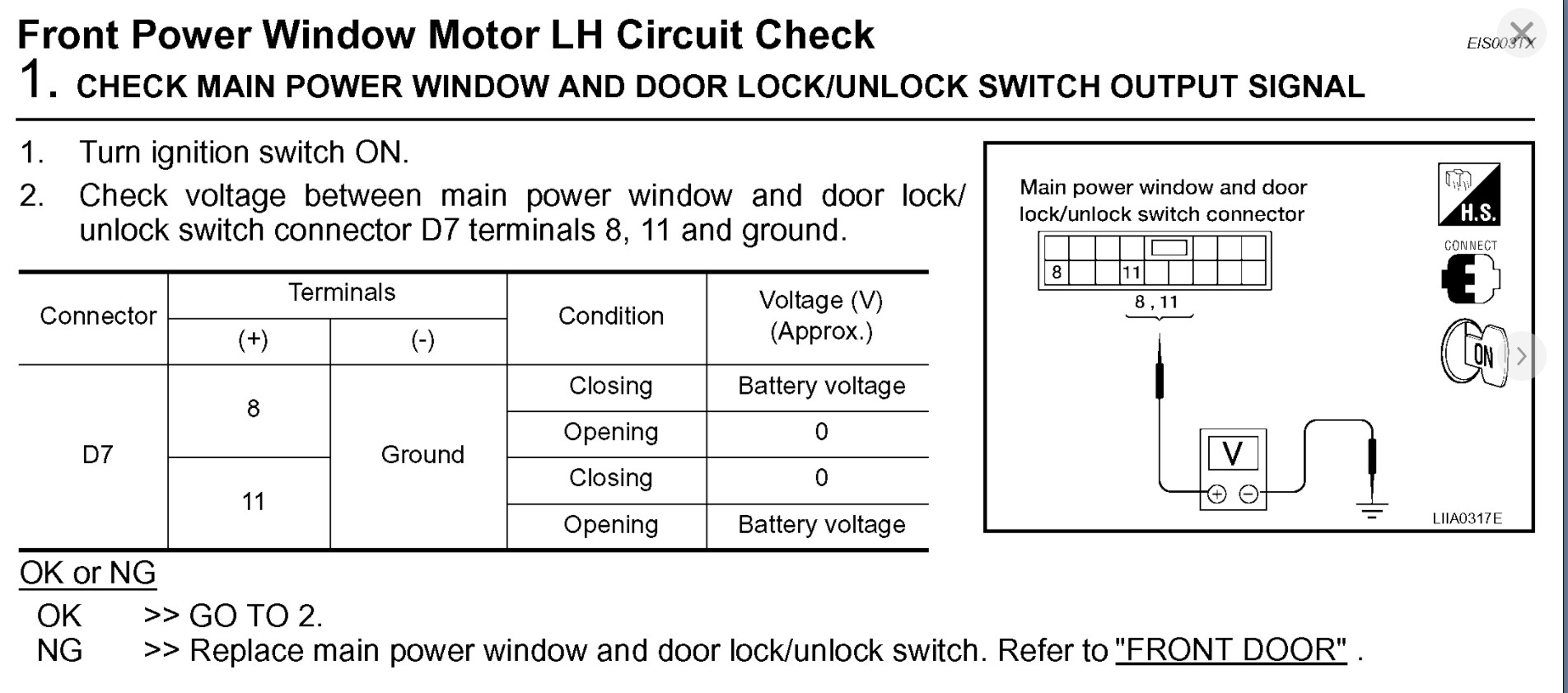

I can make the rest roll down and up with sitting in my driver's seat. Do you think it's the regulator or motor? how do i get to it?

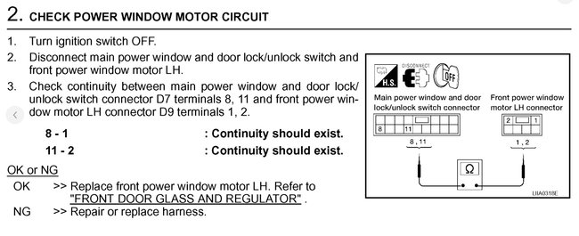

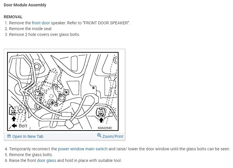

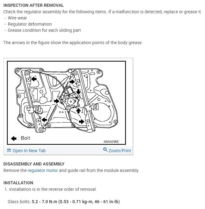

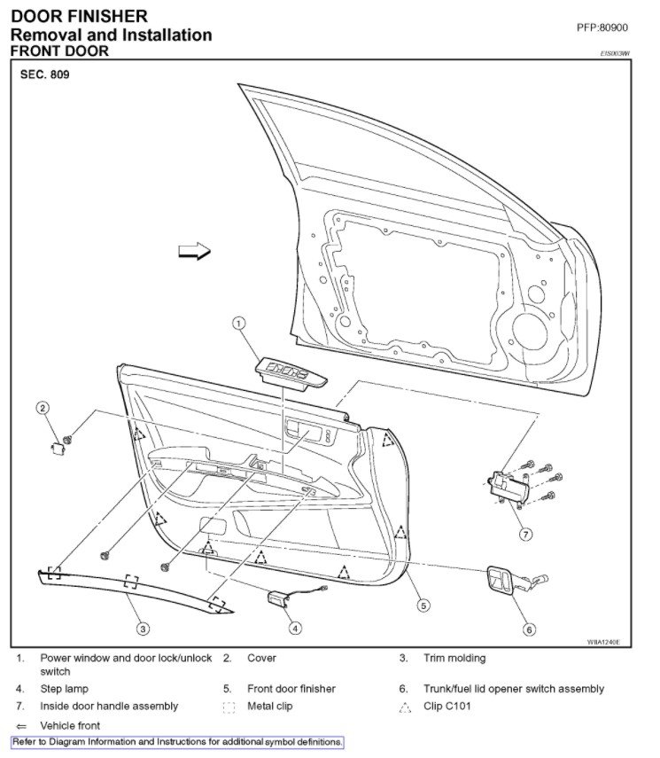

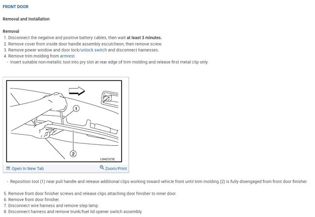

When you try to roll down the driver-side window, can you hear the motor trying to engage?

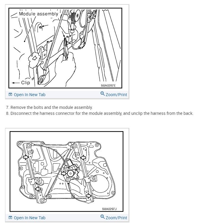

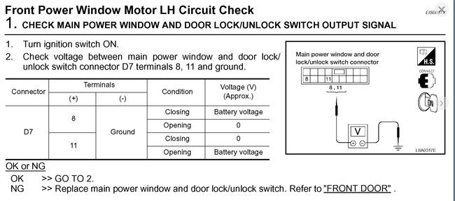

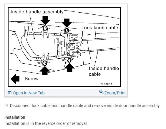

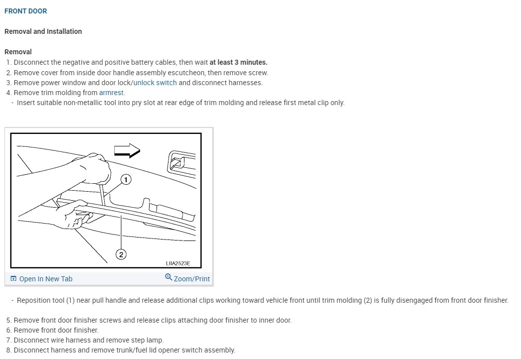

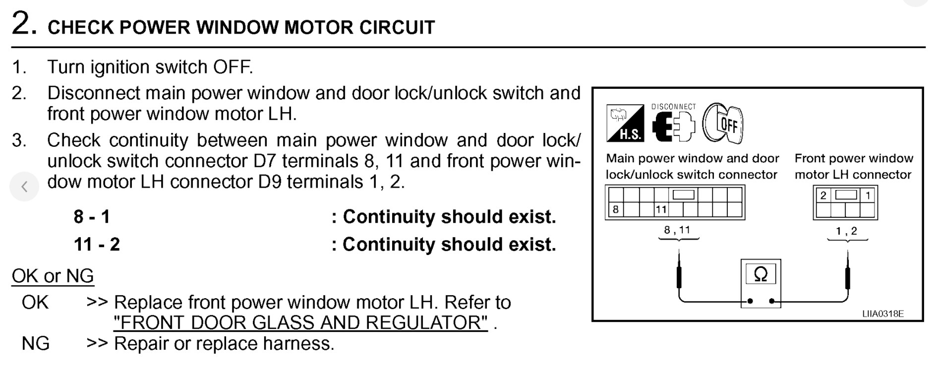

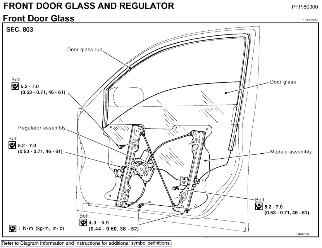

I've attached a troubleshooting guide, below, that may help you determine whether it is the window regulator or the switch. I've also attached diagrams that show how to disassemble the door panel and window regulator assembly in case you need that as well.
These guides might be helpful in diagnosing the issue:

No mam, there is no sound.

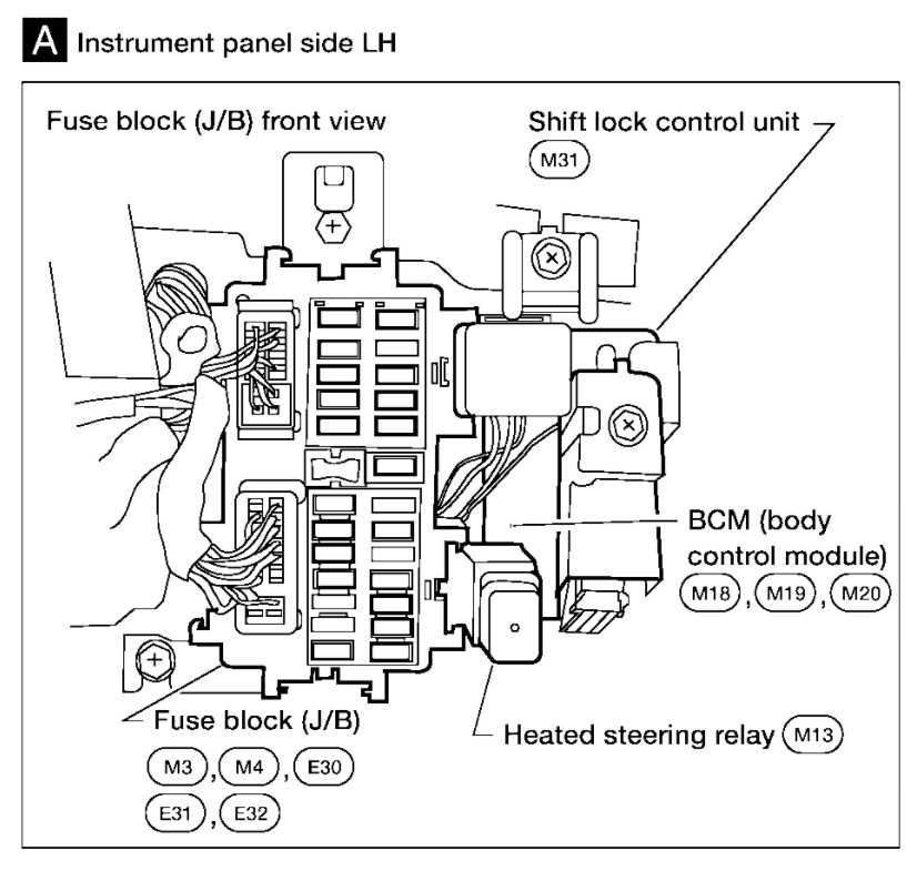

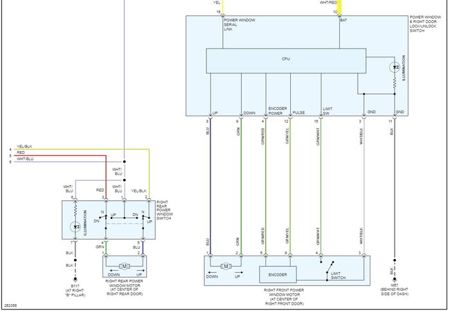

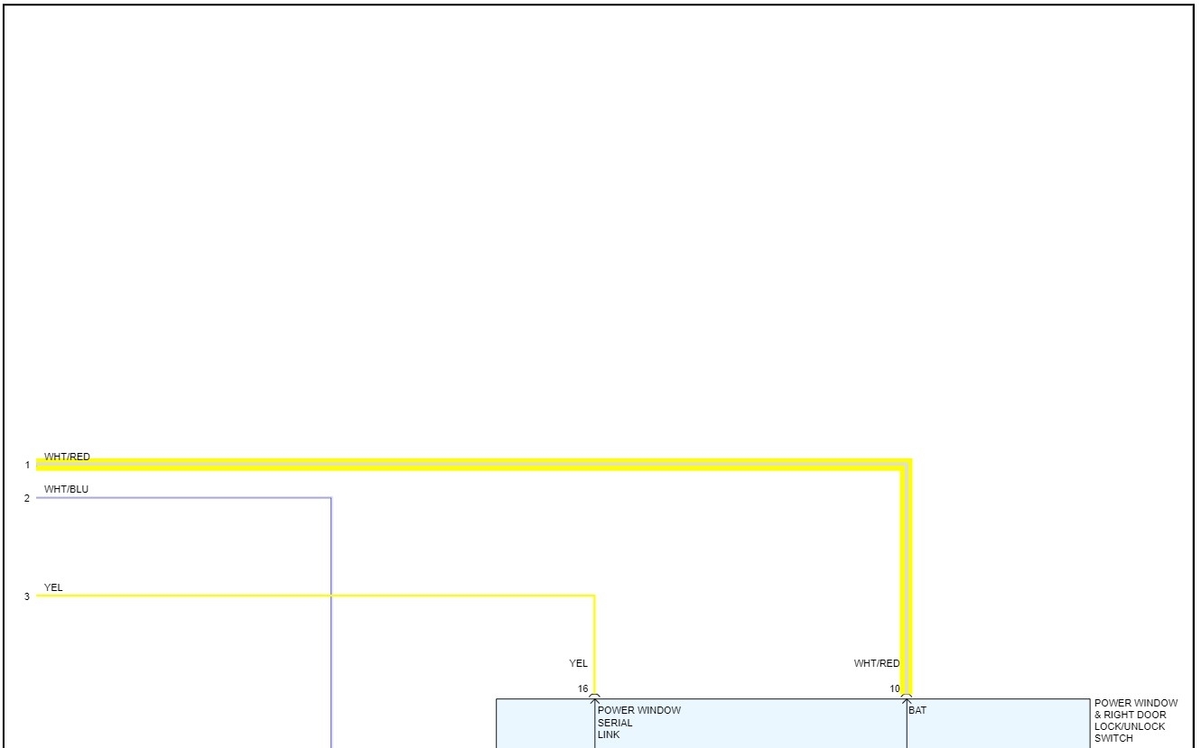

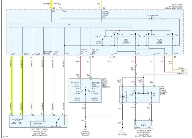

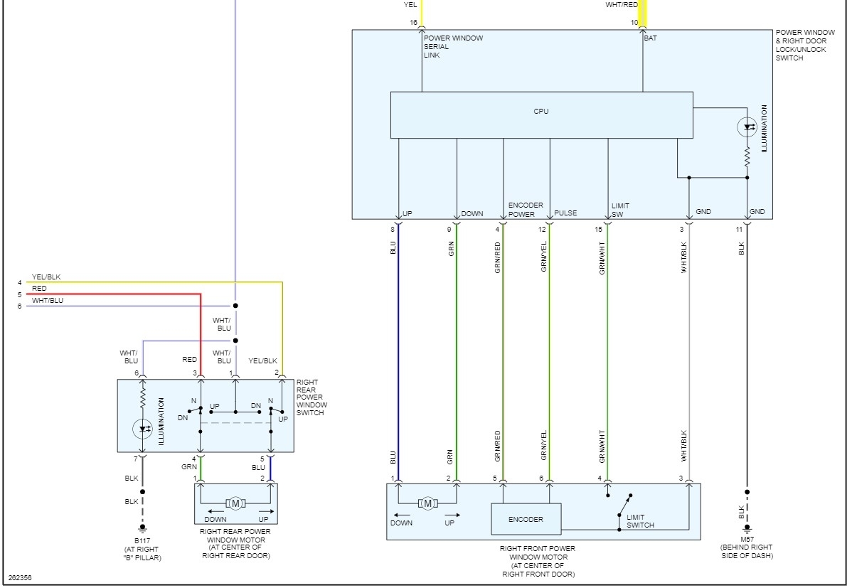

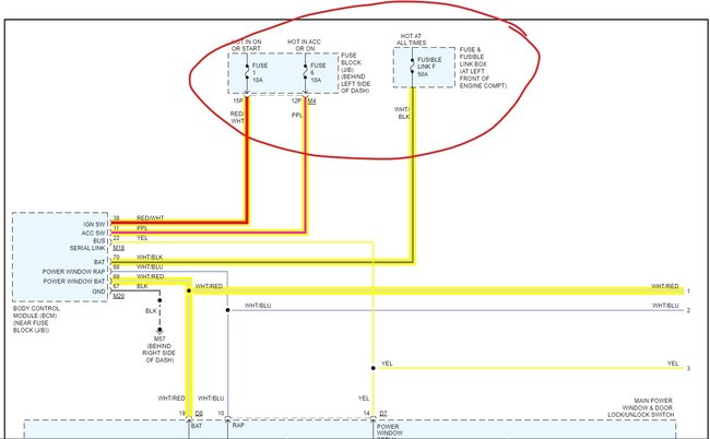

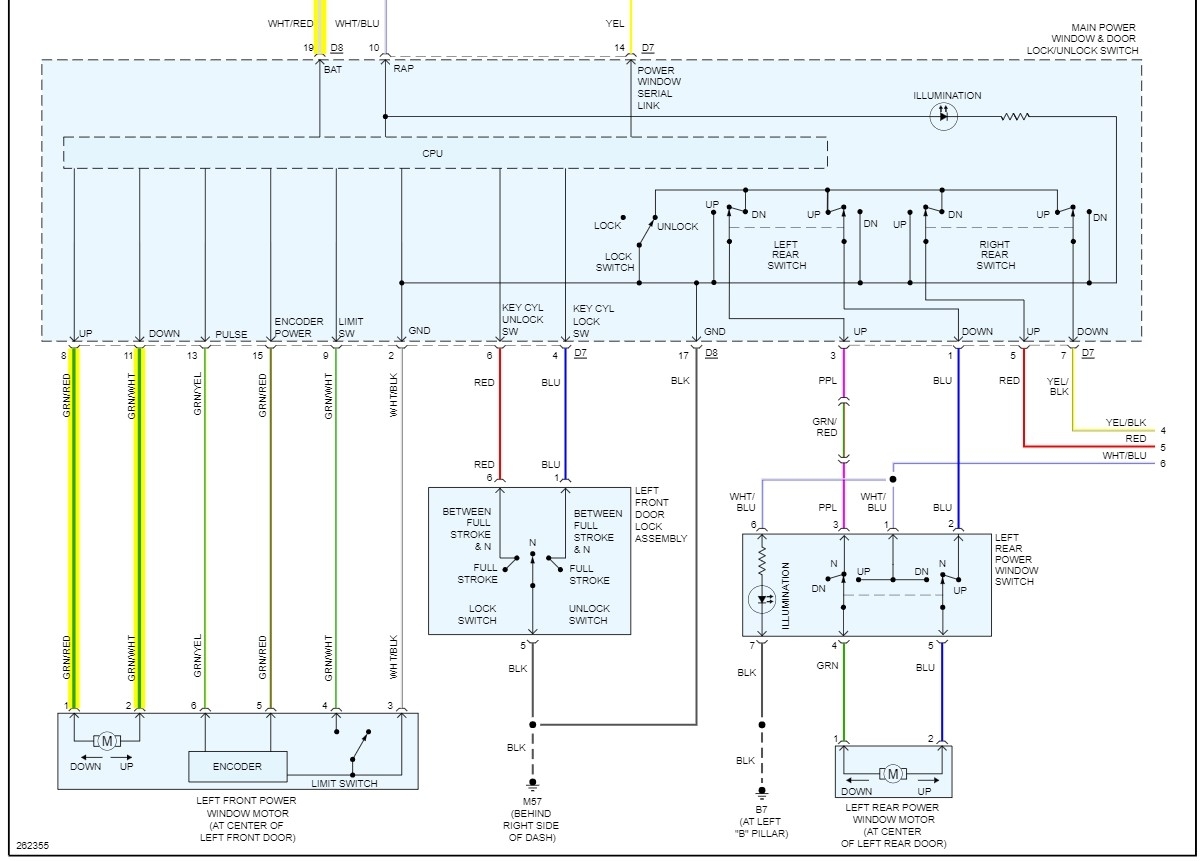

You may also want to check Fuse 1 (10 amp) and Fuse 6 (10 amp) in the fuse block behind the left side of the dash, and the 50 amp fusible link in the engine compartment on the same side (left side if you're sitting in the driver seat). I've attached the schematic for the power windows below.
This guide shows how to check fuses:
I hope this helps, Wendy W.
