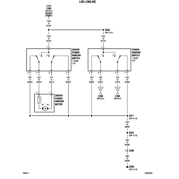

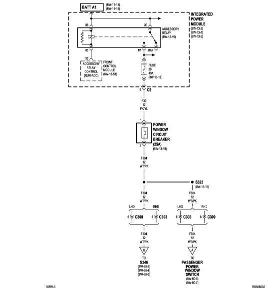

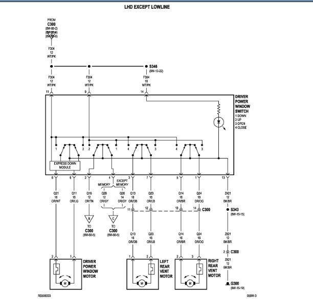

The driver side window does not work at all. Neither does the driver side sliding door. The passenger side is fine on both.
Jun 24, 2018 at 12:28 AM
Good morning.
Do you have a voltmeter to do some checks?
I attached a diagram for you to view and you need to check for power to the drivers window switch.
There is also the harness that goes through the door to the switch. That is common for wires breaking from flexing over the years.
