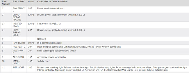

How do i troubleshoot my power seat on the driver seat? I cannot adjust it in any direction.
May 5, 2019 at 7:51 AM
  • 55,421 POSTS

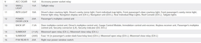

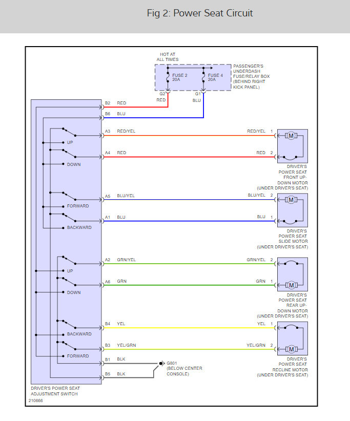

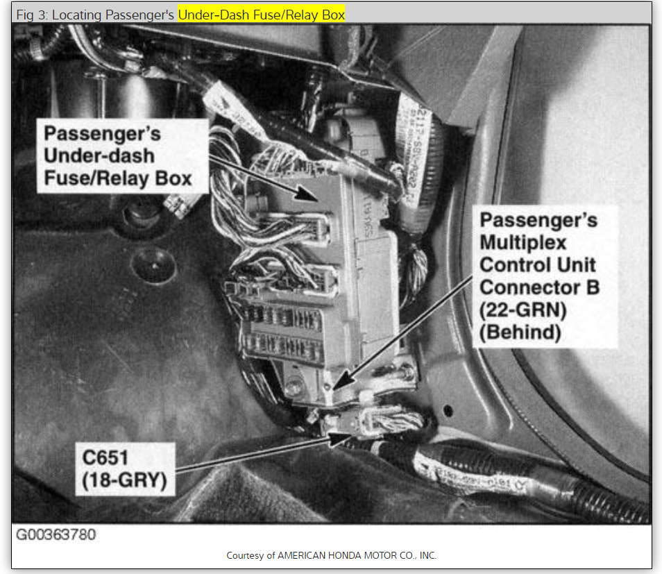

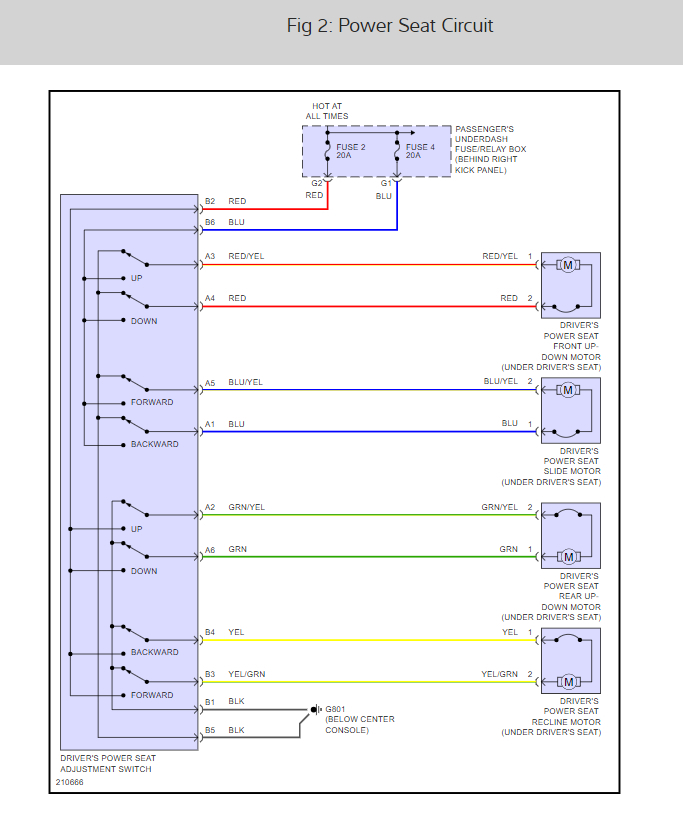

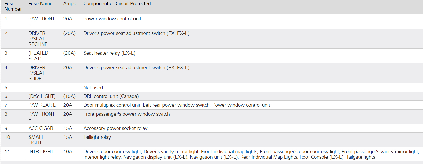

I would start by checking fuse #2 and #4 here is a guide to help check for power and the fuse locations below with the seat wiring diagrams so you can see how the system works.
Check out the diagrams (Below). Please let us know what you find. We are interested to see what it is.
