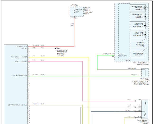

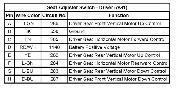

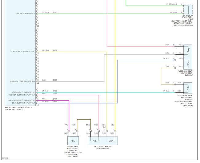

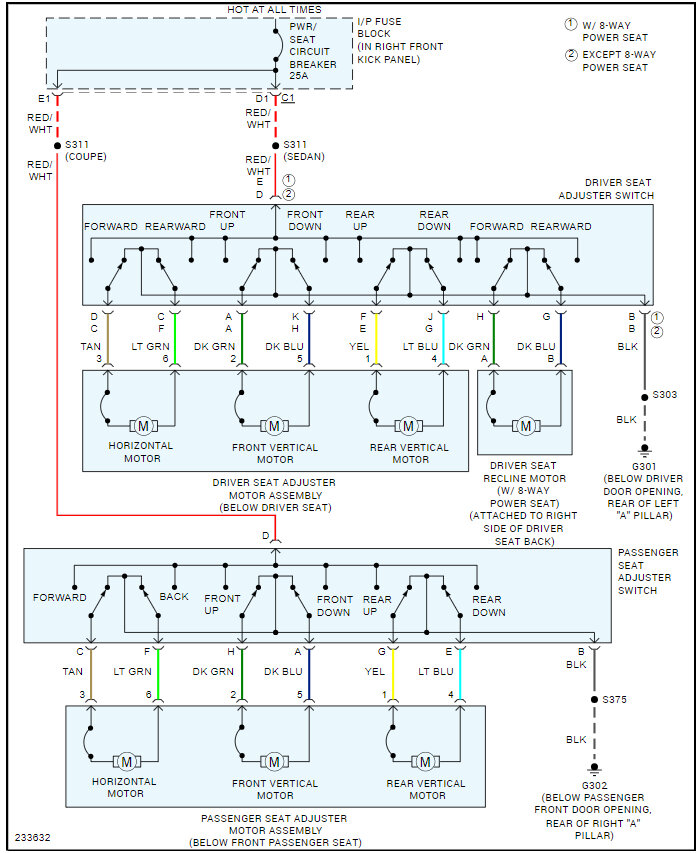

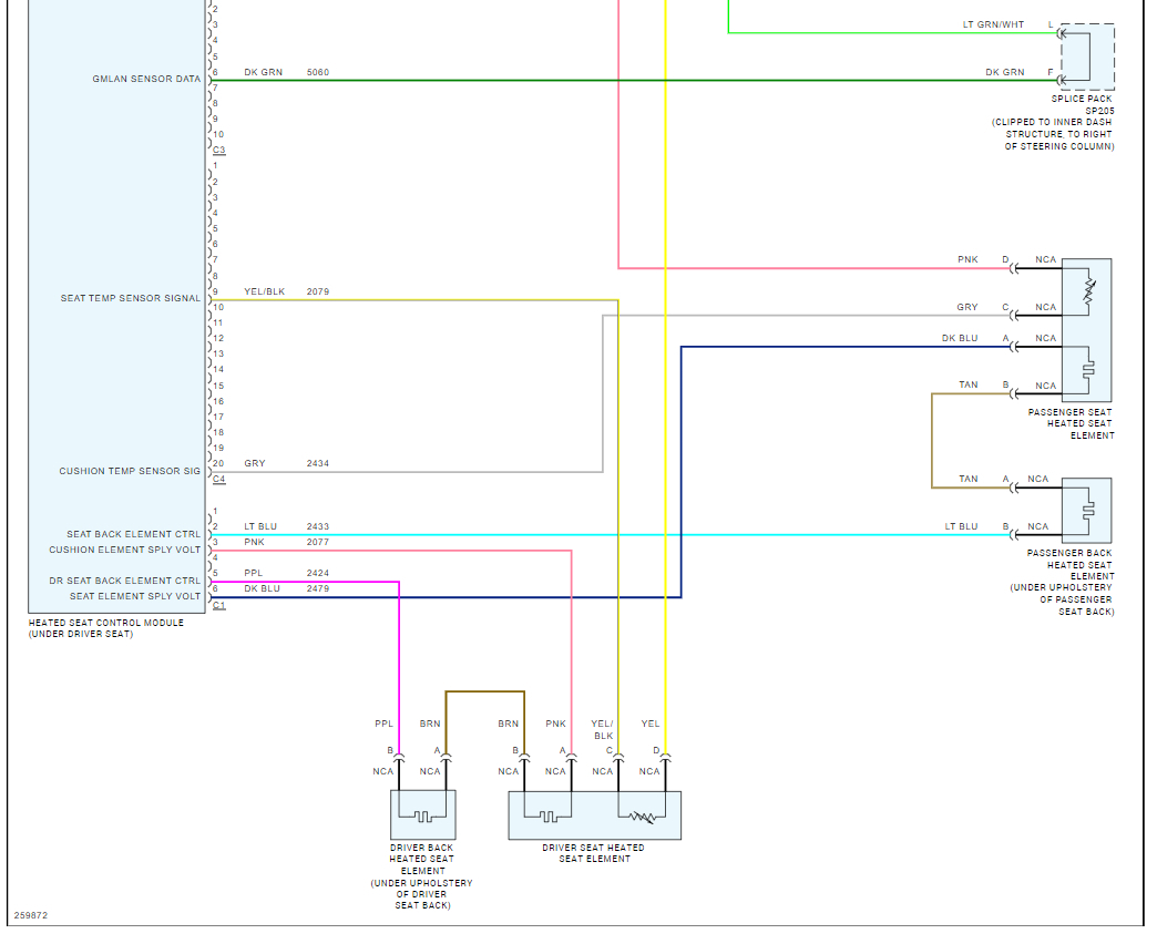

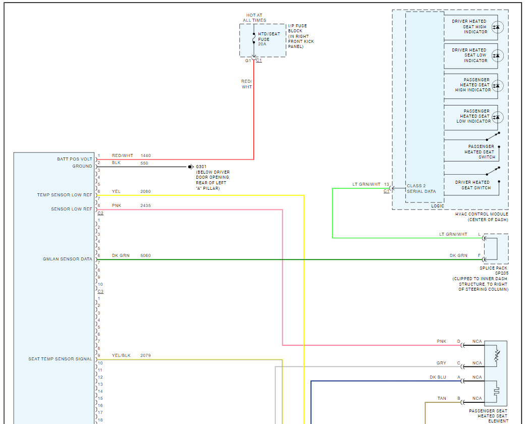

I need the electrical wiring and color coded diagram of the power seat system in my car so I can troubleshoot for a short in the power seat harness.

There are two sets of wiring diagrams, one is for the position motors and the other is for the heater seat feature, which I have included both in case you need them. Check out the images (below). Let us know if you need anything else.

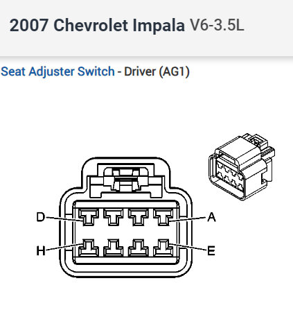

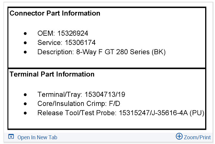

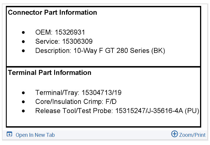

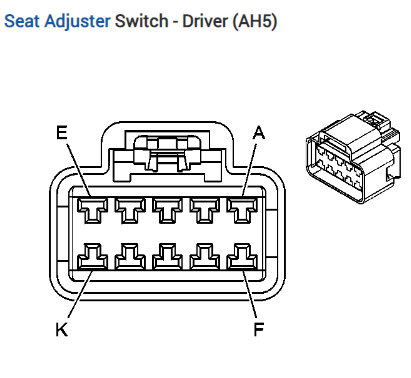

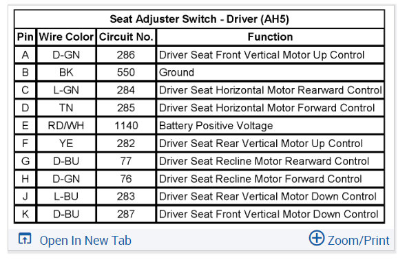

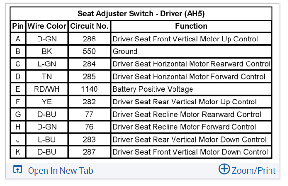

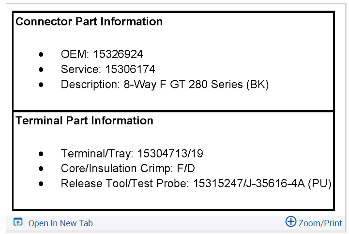

Awesome, that's what I needed, one more question is there a drawing of the wire harness connectors for this seat configuration?

Sure, here are the connector views, Check out the images (below). Let us know if you need anything else.
