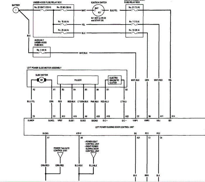

Ok I got the lock to unlatch tried so fuse tricks but pulled the #7 fuse (back up) from under dash and after putting it back in the electronic stopped working. The other passenger slider still has power to it but driver side don't. Did I mess something up pulling the #7 back up fuse and how can I get power back to slider door?
Jan 1, 2016 at 2:56 AM
check all fuses listed for power on both sides
start there
