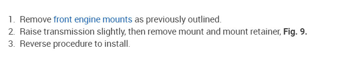

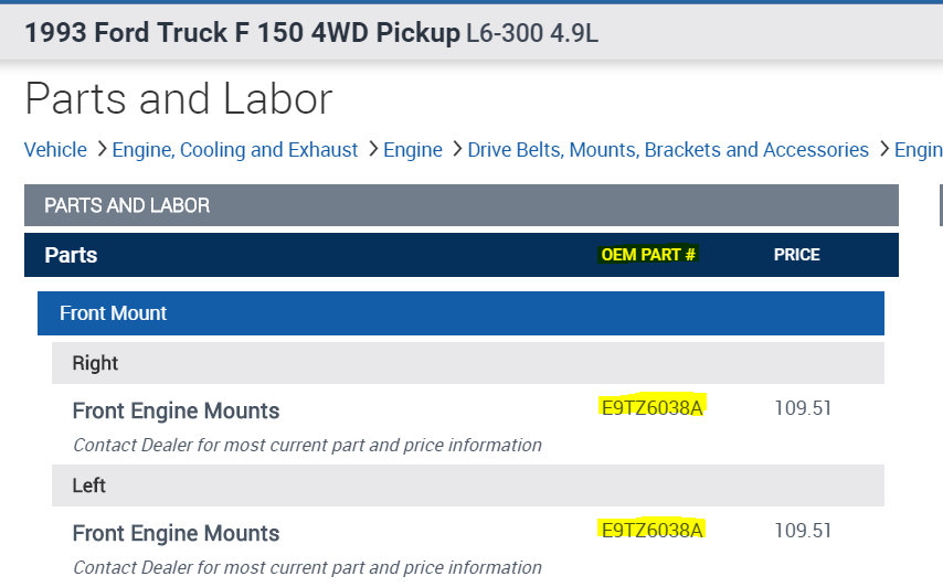

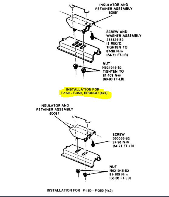

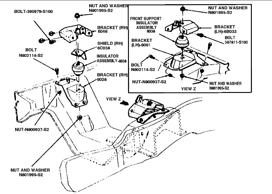

I recently installed new motor mounts and I noticed that the bolt hole on the driver side (frame mounted) support bracket for the engine mount is enlarged. Can you please send me technical diagram or a part number?
Aug 10, 2019 at 10:10 AM
SCGRANTURISMO
  • 4,897 POSTS

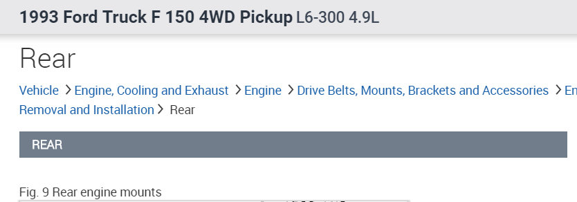

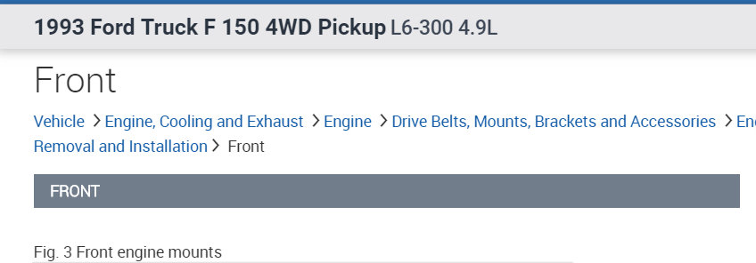

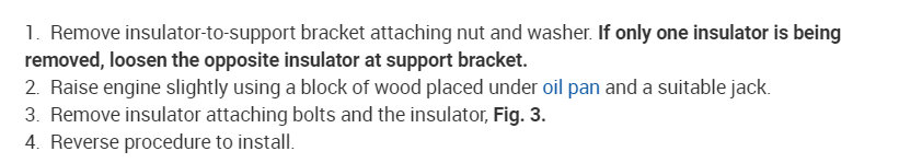

The information that you requested is in the diagrams down below. Please go through this guide for the front and rear motor mounts for your vehicle and get back to us with what you are able to find out please.
