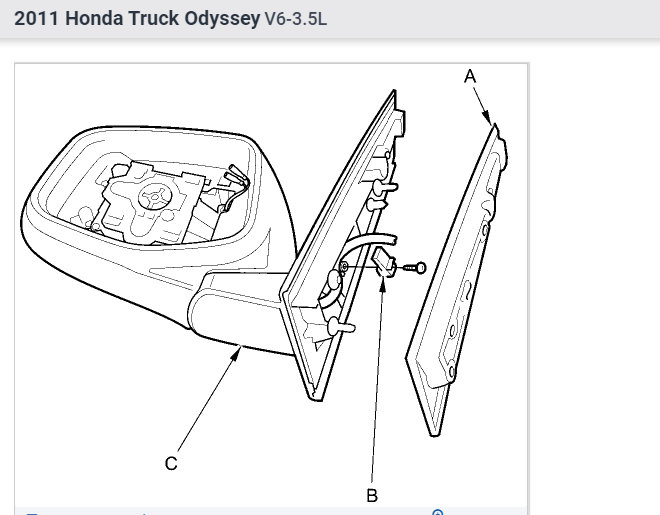

Another possibility is a broken wire, likely inside the mirror.
In order to find that you will have to remove the mirror and first inspect the wires for any corrosion or break.
If that is good, then the fix would be to replace the mirror assembly.

So it is likely the faulty heating element inside the mirror.
