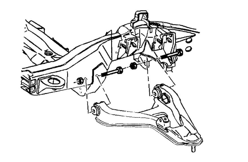

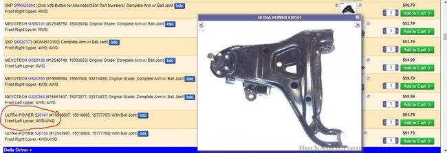

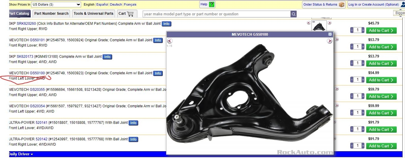

I damaged my control arm on my vehicle listed above. my question is, do you know if the parts off a 2WD Blazer interchange to fix my my control arm?
Oct 29, 2020 at 2:17 AM
Good morning,
No, they are completely different.
I attached pictures for you to view as well.

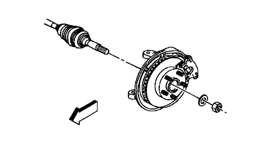

4. Remove the wheel driveshaft nut and washer.

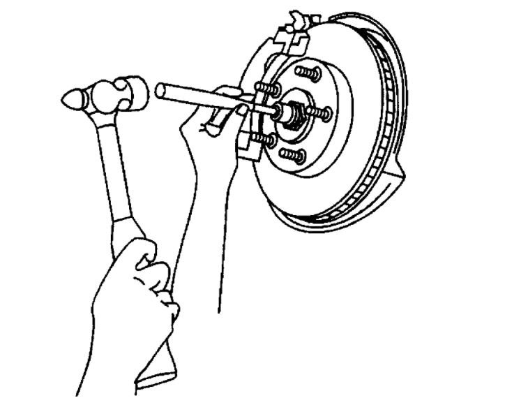

5. Disengage the wheel driveshaft from the wheel hub and bearing assembly. Place a brass drift against the outer end of the wheel driveshaft in order to protect the wheel driveshaft threads. Sharply strike the brass drift with a hammer. Do not attempt to remove the wheel driveshaft from the wheel hub and bearing assembly at this time.

8. Remove the nuts and bolts securing the lower control arm to the crossmember and the frame bracket.
9. Remove the lower ball joint stud from the steering knuckle. Refer to Lower Ball Joint Replacement (RWD) or Lower Ball Joint Replacement (4WD).
10. Remove the lower control arm from the frame.
