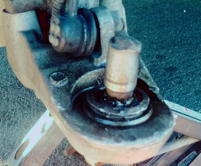

Driver side lower ball joint removal
80,000 MILES • V8 • 2WD • AUTOMATIC
177IGUEL

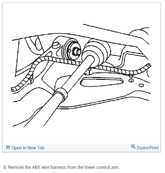

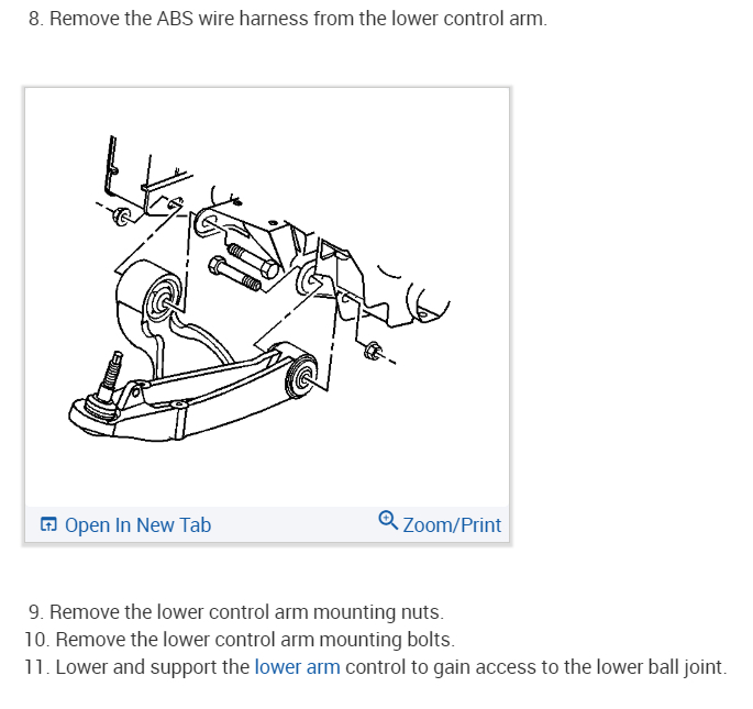

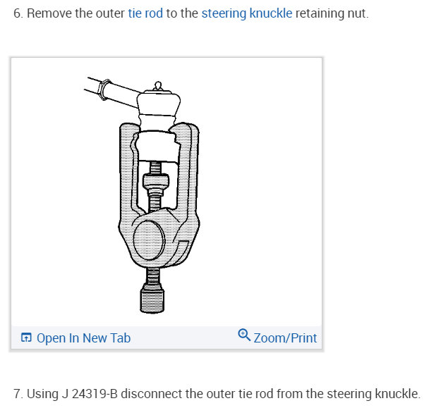

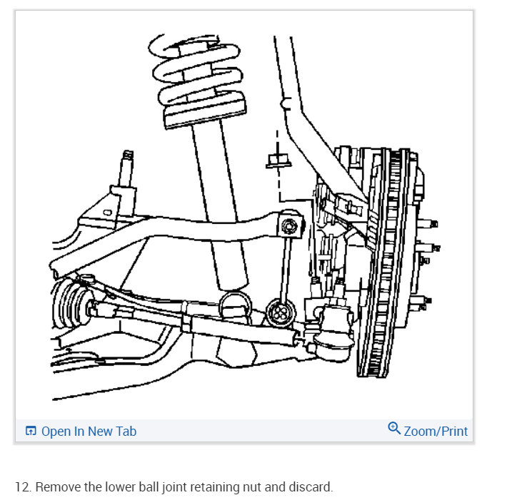

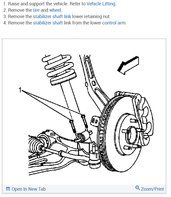

Having hard time removing is there a snap ring or a pin?
Jan 1, 2019 at 3:43 PM
MOTOR MASTER
  • 279 POSTS

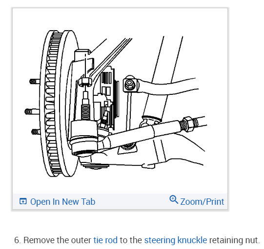

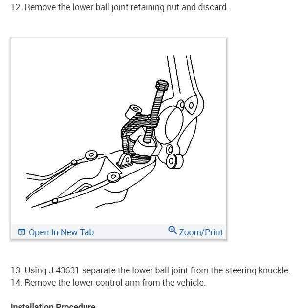

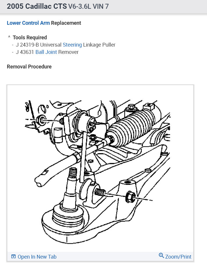

Hi my name is Dave. It looks like that is a non serviceable ball joint with the factory lower control arm so you'll have to replace the control arm.
Jan 1, 2019 at 6:07 PM
  • 55,721 POSTS

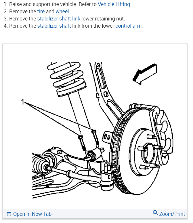

Here are the instruction and diagrams to show you how to do the repair below. Check out the diagrams (below). Please let us know if you need anything else to get the problem fixed.
