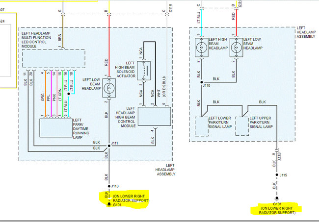

A while ago I hit a bump not huge and i noticed my directional marker in my driver side mirror flashed flashed on then off. finally it got to staying on and i noticed with it on if was like all the power to my again all driver side and only driver side. The fog light does not come on or high and low beam do not work. And also i noticed in the beginning before the marker mirror light the driver fog was dim. fast forward to now and the directional mirror is stuck on and no front facing driver side lights work? Please help i'm pulling my hair all out!

Wow, that must have been a big bump. I looked over the headlamp wiring schematic. It's two pages long. LOL The one thing that I see ties the things together regarding the problems you are having is the ground. It's located on the lower right side of the radiator support. Check to see if anything was damaged, has come loose, or if it's disconnected (broken).
Note: The lighting on the right side is separate.
See pic 1.
Let me know what you find.

Joe, I really appreciate the time and effort you put in to solving my problem 100% I really really appreciate it. besides having an issue locating the ground once did all was well! Thanks!
