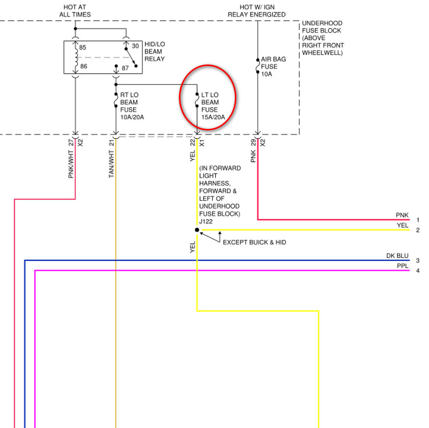

I replaced the ballast, and the light bulb still isn’t working. Should I change the igniter also being that I changed the ballast?
Aug 24, 2022 at 12:47 AM
BORIS K
  • 836 POSTS
I would suggest first checking that the left headlight fuse is intact, see image 1.

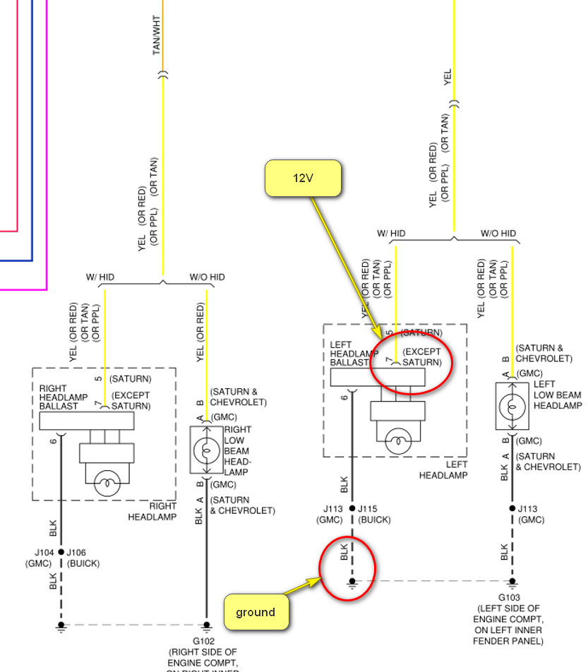

If in order, next check that you have 12V at pin 7 of the headlight connector, see image 2.
This can be done using a test light or voltmeter.
Also, check that the black ground cable at pin 6 has a good ground connection. Use the test light or voltmeter and check that you have the same result as using a good chassis ground.
How to:
and
and
Does the HID light up if you supply your own 12V at pin 7?
Hope this helps.
Cheers, Boris
