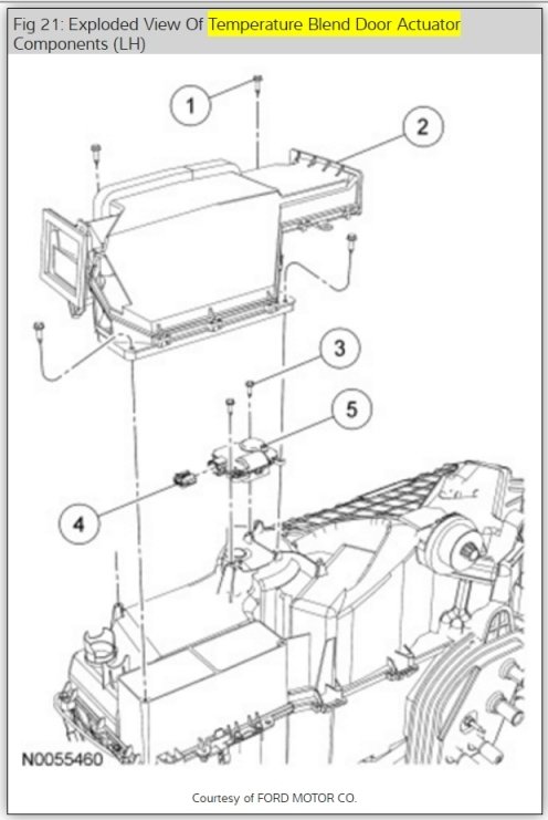

Driver side heat blows cold.
94,000 MILES • 5.8L • V8 • AWD • AUTOMATIC
RED37
The heat for the cabin of the truck works well, except for the heat vents on the driver side, it blows extremely cold. While I have looked at you instructions for the blend door actuator change, I am not sure that this is an accurate account of what needs to happen with my SUV. I am really stuck on this and need help.
Nov 19, 2016 at 6:16 AM
  • 55,721 POSTS
Hey Red,
Yes this sound like a classic blend door problem, I found this diagram for you and this guide which will help show you what you are in for.
Your looks a little rough to get to.
