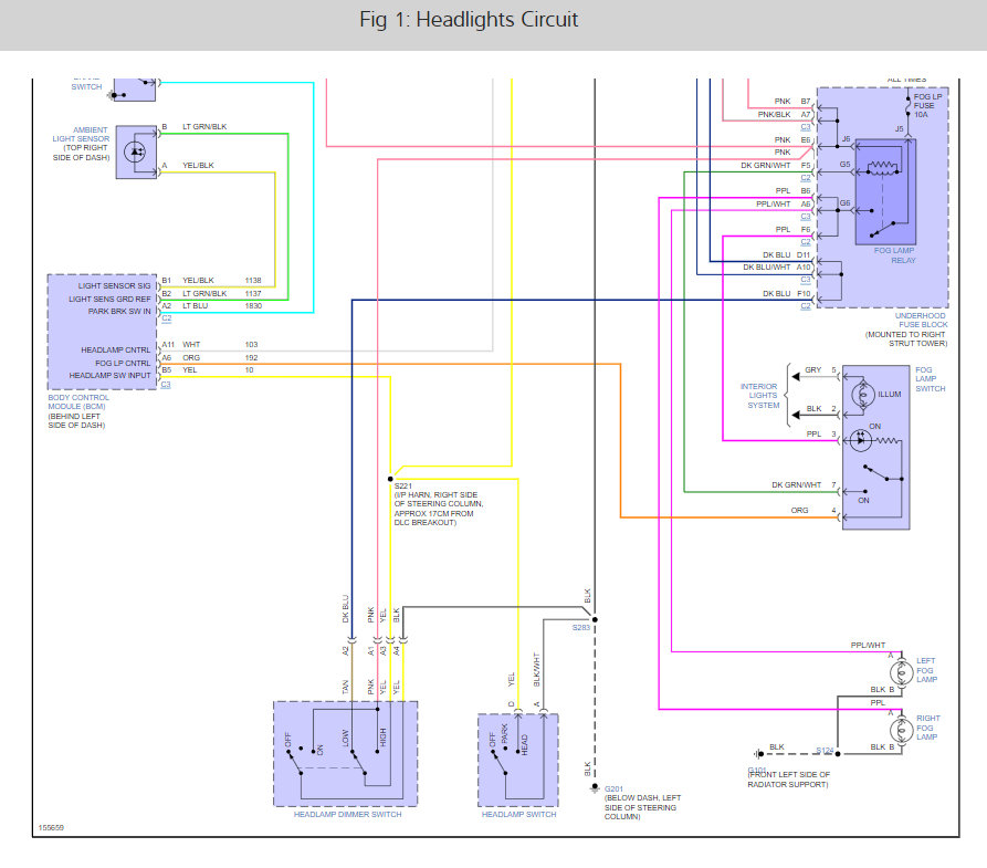

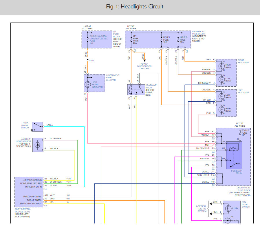

And they are both on at same time. This also affects my passenger side lights, making them not as bright as they should be, and they are both on. I disconnected the driver side and passenger side works fine. Seems to be grounding out somewhere between the two. How do I go about finding the problem?
Aug 12, 2022 at 9:37 AM
  • 55,433 POSTS
There are four fuses that run the headlight system we should check first, (radio, HVAC, RFA, Cluster, TEL - Park, HDLP-R and HDLP-L) if these are okay, we need to check the system ground which is below the left side of the steering column. Here is a guide to help use and I have included the headlight wiring diagrams so you can see how the system works:

All fuses were good. I replaced head light switch but that did not solve problem. I was about to replace turn signal/dimmer switch, I have sold car so they will have to figure it out.
Oct 19, 2022 at 2:32 PM
  • 55,433 POSTS
Is sounds like the BCM is out if they get back to you on the fix please let us know. Use 2CarPros anytime, we are here to help. Please tell a friend.
