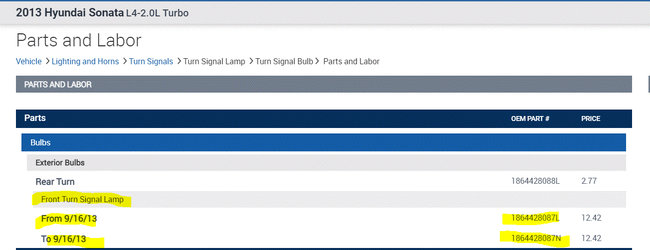

driver side front turn signal stays on and does not flash
2013 HYUNDAI SONATA
84,000 MILES • 2.0L • 4 CYL • 2WD • AUTOMATIC
BADBOUY55
After replacing bulb (it stopped working), the on the left front turn signal the new bulb just stays on and will not flash. The rear signal does flash.
Nov 28, 2021 at 4:21 AM
  • 110,194 POSTS
I have a feeling you may have gotten the wrong bulb. There are two choices for this model. The one needed is based on the production date. Take a look at pic 1 below.
The numbers on the right are the manufacturer's part numbers. First, locate the production date of the vehicle. There should be a label on the driver's side door frame. Locate that first. Next, determine where the production of your vehicle falls based on the pic below. Based on that, tell the parts store you need that specific bulb. There will be other part numbers based on the bulb manufacturer, but it has to cross with that OEM part number.
