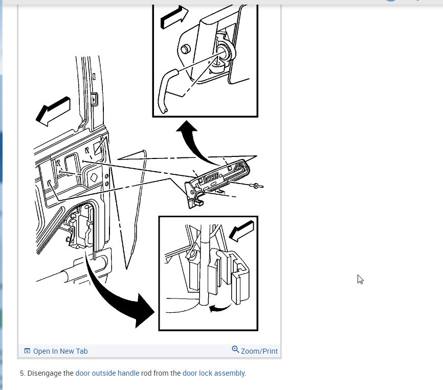

The inside auto door locks work to unlock all doors. My question is, will a remote work to unlock/lock the doors from outside the car in this case? The remote that came with the car is lost but can be replaced if that would work.
Sep 15, 2016 at 9:27 AM

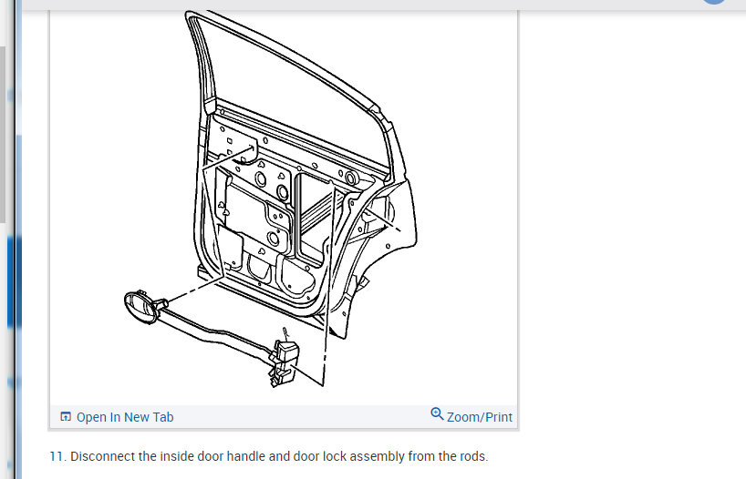

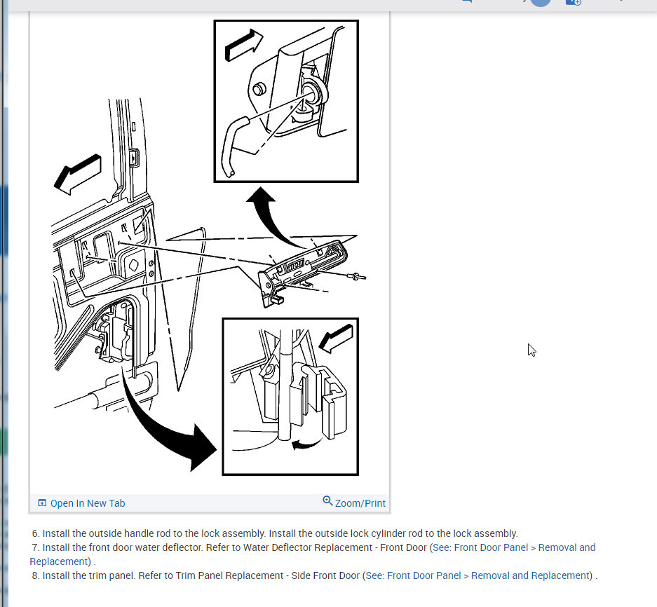

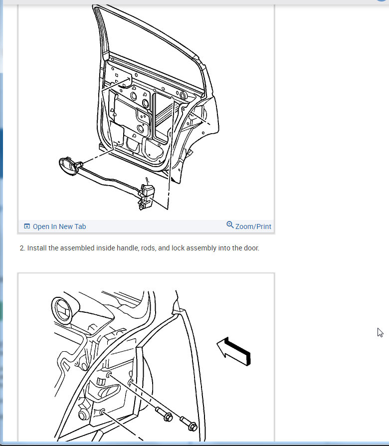

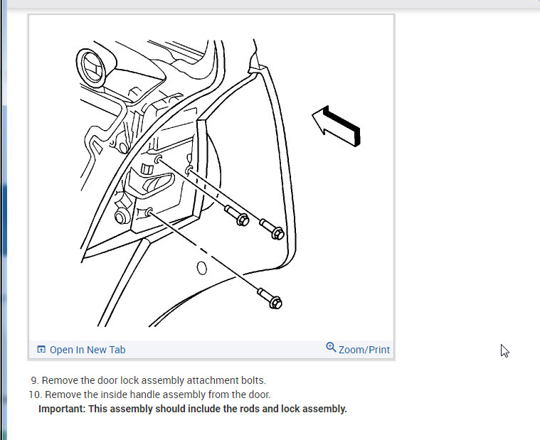

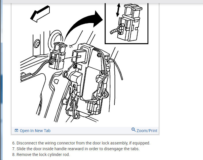

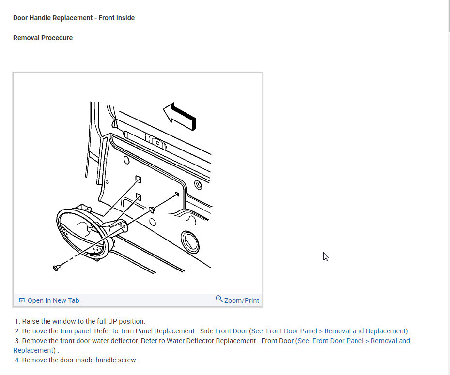

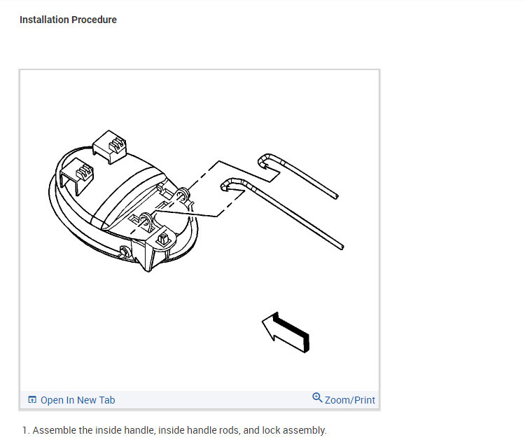

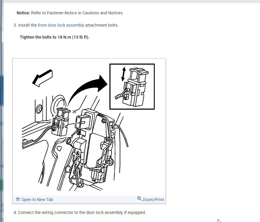

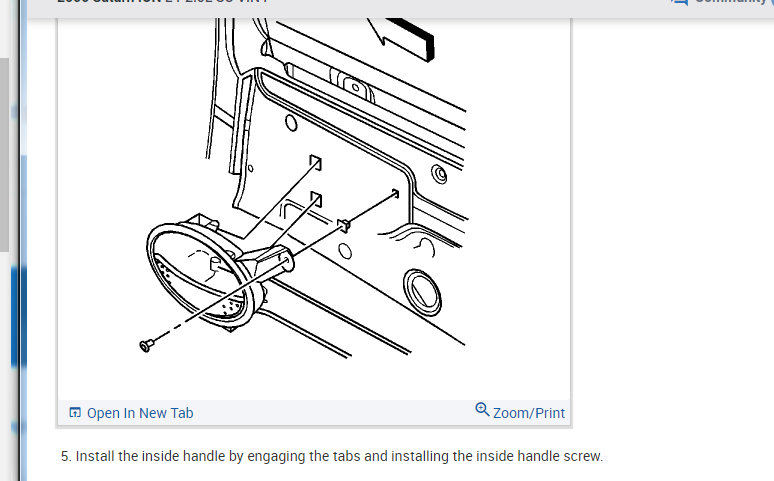

If the key will not lock or unlock then it is likely the locking rod has come off so the lock will not work with anything until this is reattached.
Here are some guides that will help with this:
https://www.2carpros.com/articles/test-or-change-electric-power-door-locks
https://www.2carpros.com/articles/door-panel-removal
Attached below are the instructions on how to remove this so that you can see how to remove the handle and lock rod to get it replaced or reattached.
Let us know if you have a question. Thanks
