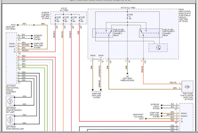

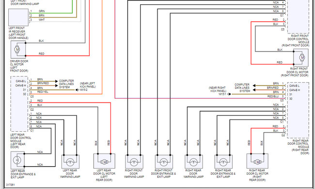

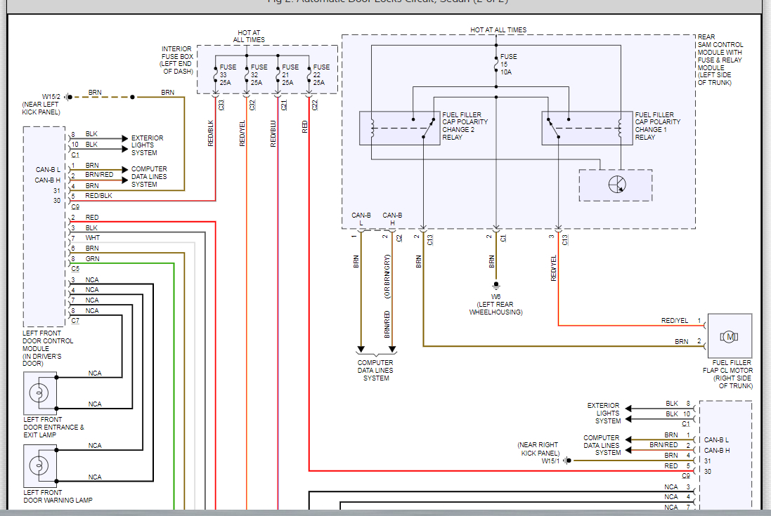

Need schematics for c6 on the DCM. And where the wires 1-10 on c6 go to. Same with 1-10 on c1 on the DCM.

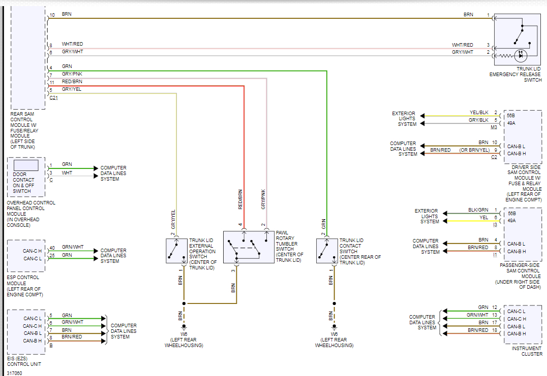

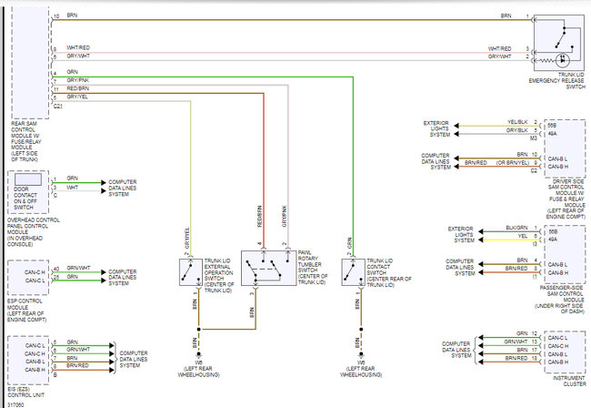

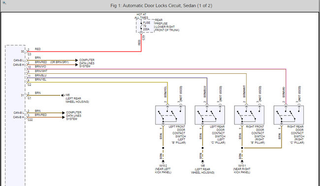

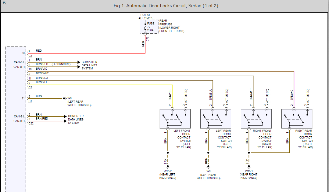

I hope this is what you need. We are here if you need any more information. Check out the diagrams (Below). Please let us know if you need anything else to get the problem fixed.
