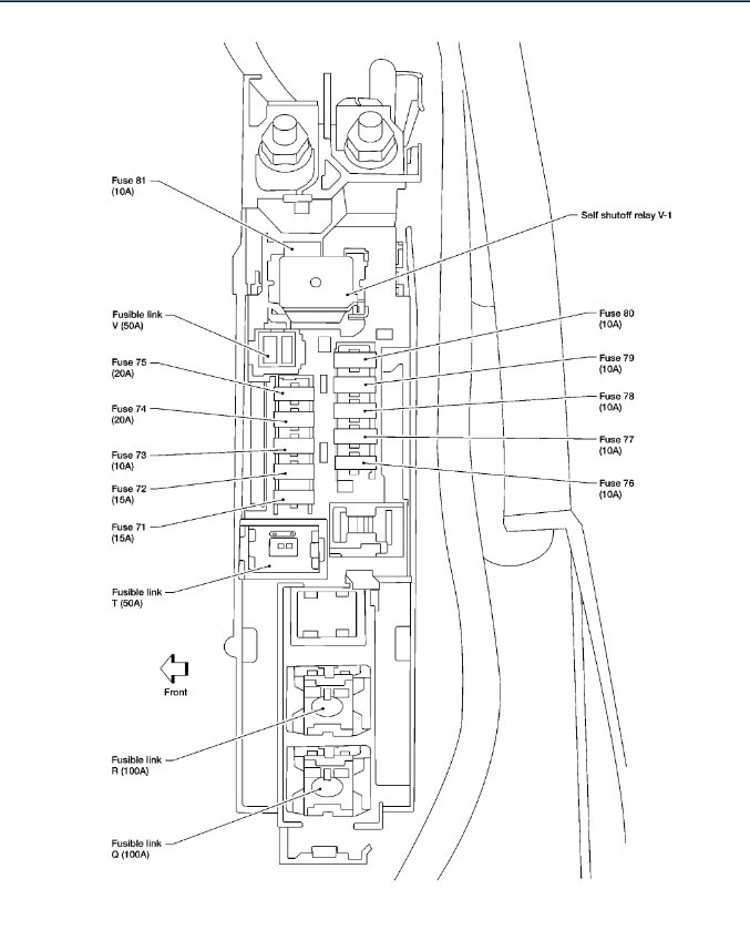

Abruptly, the driver's side climate control seat in my vehicle listed above Hybrid stopped functioning. When turning the dial to cool or heat, the light doesn't turn on.
Checked the fuse and it looked fine, even swapped with the passenger seat fuse and no change.
I have seen answers about the light coming on and shutting off quickly suggesting a bad module, and the car has a service bulleting from Infiniti for replacing the module and harness, but before a $1,500.00 repair, I am wondering if there is a simpler answer.
Nov 21, 2022 at 7:21 AM
  • 55,214 POSTS

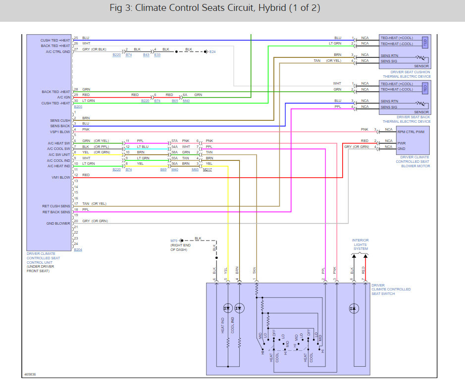

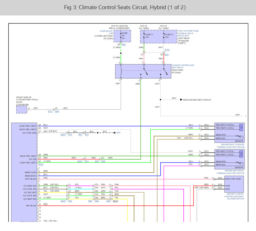

So, there are three fuses that run the system that need to be checked for power, fuse# 29 in the lower side of the dash fuse panel and fuses# 71 and #72 in the fuse panel in the left rear of the engine compartment. This guide will help, and I have included the fuse locations as well. If the fuses are good, there is a climate control seat relay that is on the right side of the dash I would swap out. I have included the climate-controlled seat wiring diagrams so you can see how the system works as well.
Check out the images (below). Let us know what happens and please upload pictures or videos of the problem.

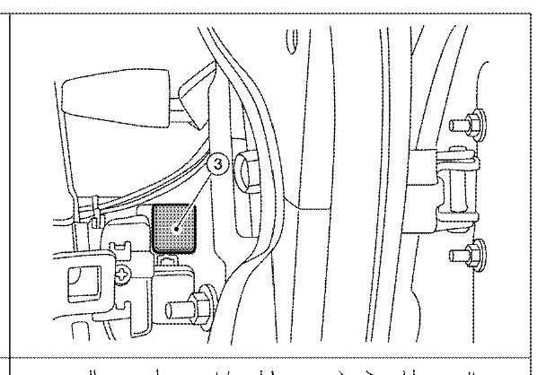

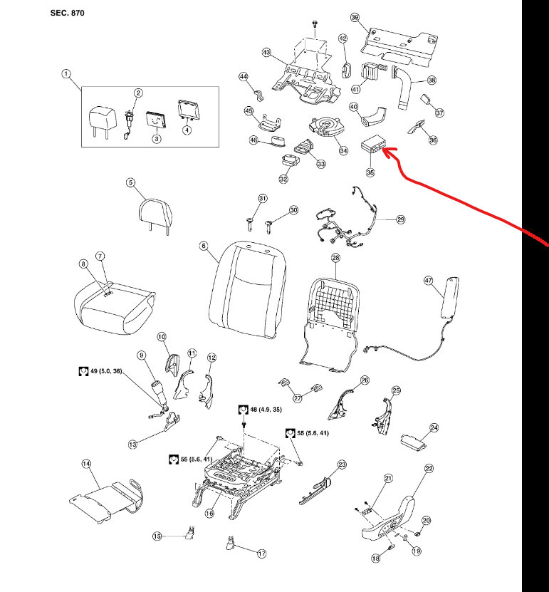

Okay, if the grounds are good and the climate control module of the seats is getting power this leaves the controller itself as being bad. Here is the location so you can change it out. Check out the images (below). Please let us know what happens.
Dec 12, 2022 at 4:27 AM

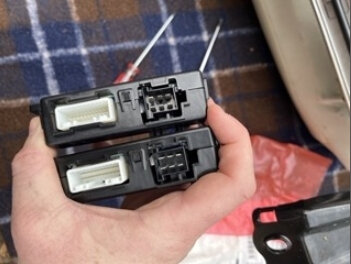

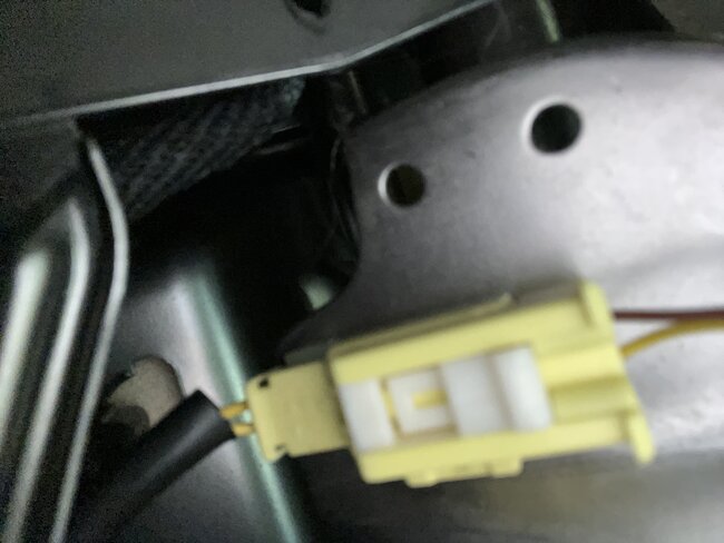

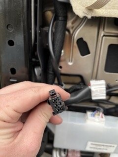

Took a while to get time to get the module and pull the seat, but this looks like it is likely the issue, there is definitely damage to the module.
Unfortunately, the wiring harness is damaged as well, and looks like it needs to be spliced in, so I am ordering a new harness. Hopefully, this will solve the issue.
Thanks again
Dec 26, 2022 at 6:08 AM
  • 55,214 POSTS
Yep, you have found the problem. I would get the new pigtail and splice it in this should fix the problem. It must have been a bad connection which caused the circuit to overheat, producing the damage you see here. Nice work.

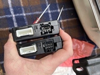

Good morning, I am new to this feed but I just bought a 2014 Infiniti qx60 hybrid, and it is having the same problem, I have seen multiple modules I am curious if you have some better pics of the module so that I get the right one. I seen quite a few on Ebay etc. that say they are compatible with my 2014 but bolt holes look different, so I was trying to see if you had some photos of the right one to get.
Mar 3, 2026 at 8:45 PM
  • 55,214 POSTS
Welcome to the site, here is an image of the user replacing the module, your should look like this as well. Let me know what happens please. Ken
