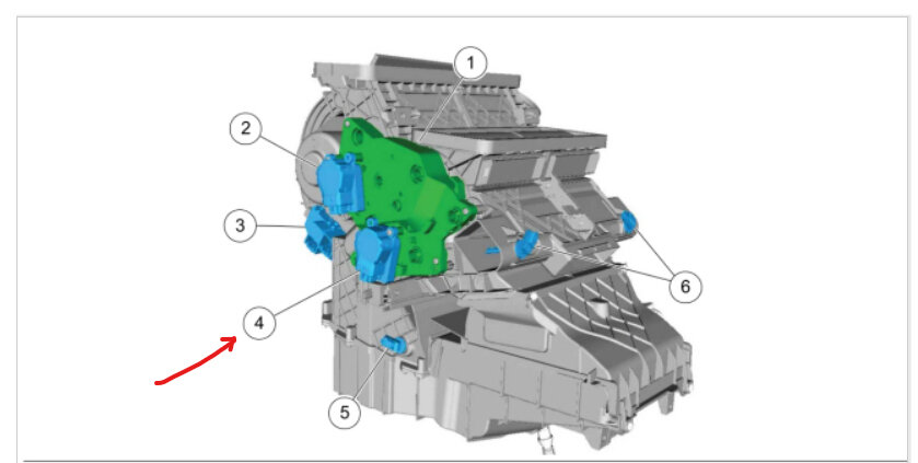

This car has dual climate control. With the AC on full blast, the driver side is blowing hot air while the passenger side is blowing cold air.
I replaced the cabin air filter and recharged the refrigerant but the problem persists. I'm thinking it is the blend door actuator broken and set to the wrong position to not close the "flap" all the way.
This is my SIL's car that I will work on so I am unsure if it was ever clicking.
Does anyone have a location and steps for the driver's side blend door actuator? I believe I need to remove the knee air bag so I will take that into consideration as well.

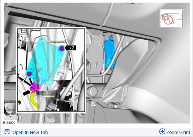

Yep, this does sounds like the drivers side blend door actuator is bad, here is the location and directions to help replace it. They don't always click when they go bad FYI. You will need to remove the lower part of the dash panel on the drivers side. The mounting screws might be a little tough to get to so be ready. Check out the images (below). Let us know how it goes, the actuator should self calibrate.

I did this yesterday. Here were the steps:
Disconnected battery
Pulled ODB port cover
Pulled panel underneath steering wheel and next to door
Pulled knee airbag
Accessed the blend door actuator
Undid both screws with a t-15 screwdriver
Plugged in new blend door actuator
Connected battery to get the teeth to the correct position on the actuator
Disconnected battery and reassembled everything in reverse
