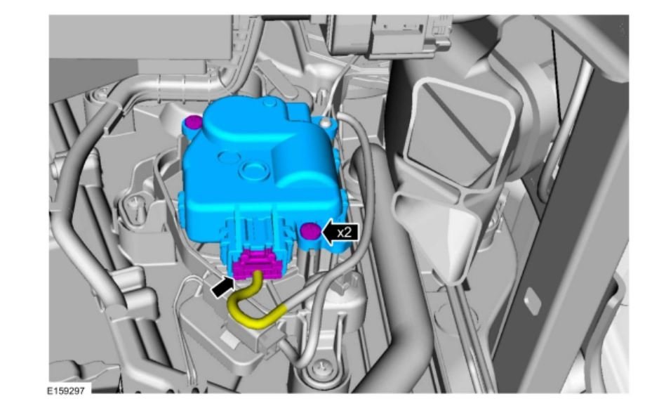

Sounds like the actuator is not working.
I attached the procedure with pictures below for you to view.

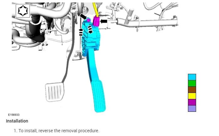

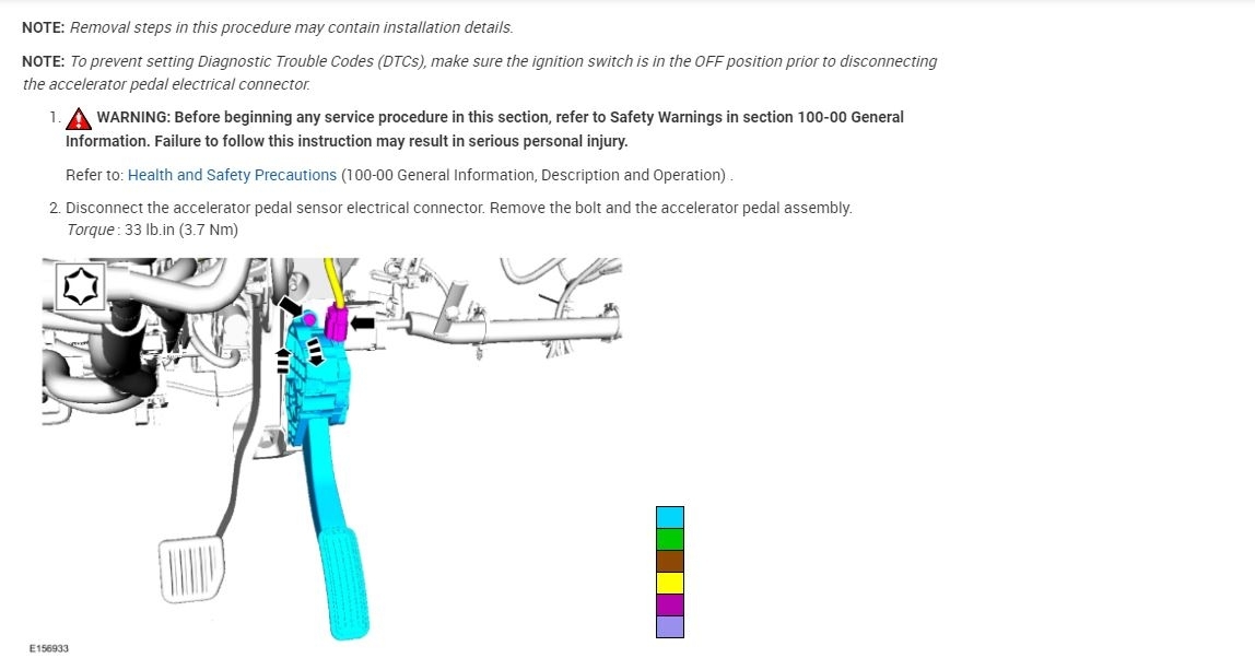

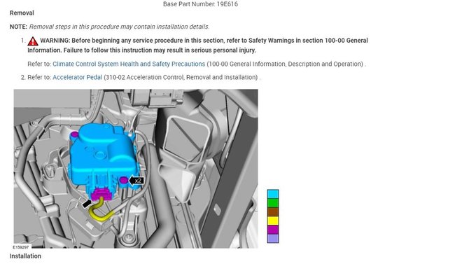

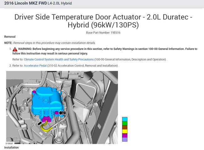

The procedure is the same for the Hybrid and regular vehicles. I found more diagrams for you. Check out the diagrams (below). Please let us know what happens.
