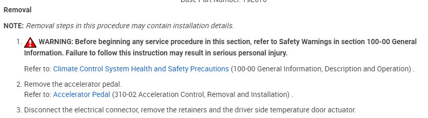

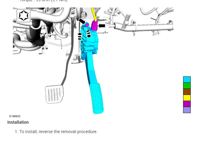

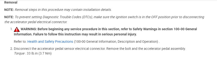

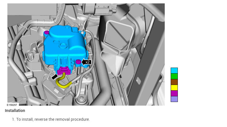

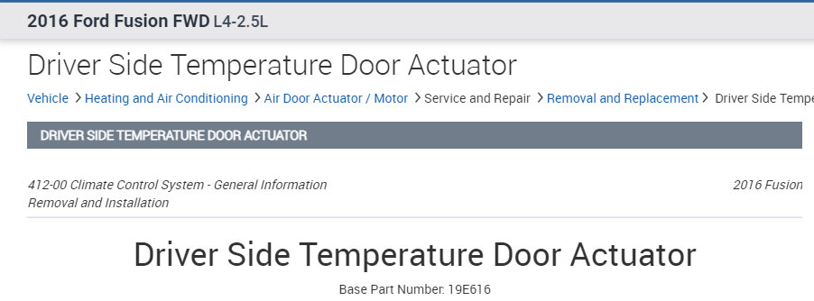

How do I remove the top left screw on the driver side blend door?
2016 FORD FUSION
90,000 MILES
2016FUSION
Driver side blend door.
Dec 26, 2022 at 6:51 PM
  • 110,194 POSTS

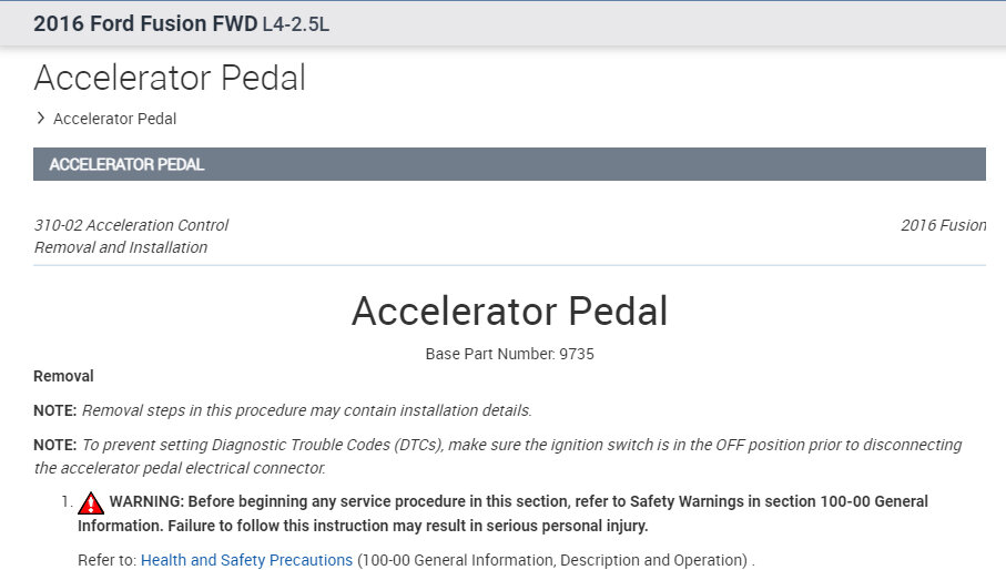

The accelerator pedal needs to be removed to gain access. If you look below, I attached the directions for the replacement of the actuator. See pics 1, 2, and 3.
Starting with picture 4 are the directions for removing and replacing the accelerator pedal assembly.
