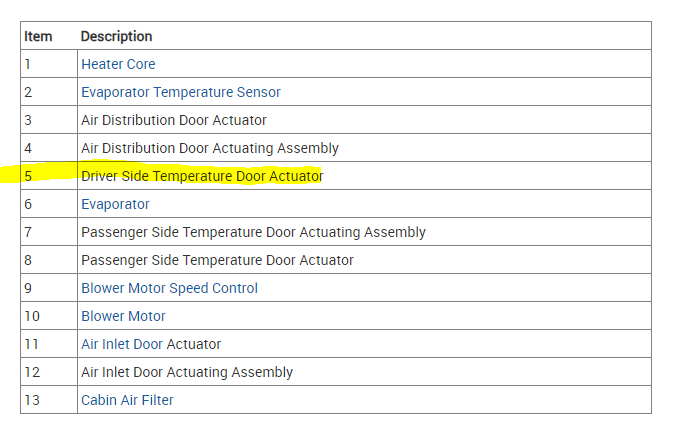

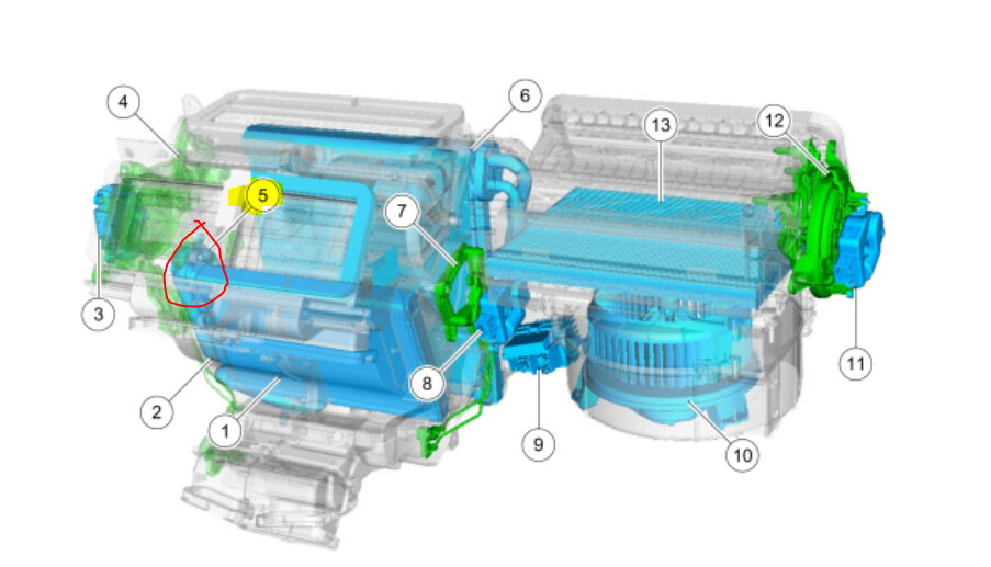

Driver side blend actuator, driver's side A/C blowing hot air?
2017 FORD FUSION
101,610 MILES • AUTOMATIC
RAYENR
I am getting mixed information for driver side blend actuator. My A/C is blowing hot only on the driver's side. Please advise if it’s the bottom abo.
Jul 1, 2024 at 5:31 PM
  • 110,194 POSTS
I suspect you have automatic climate control. If you look at the picture below, it shows the location of the actuator. Pic 2 is the legend for the pic.
According to the manual, number 5 is for the driver's side.
Let me know if this helps.
