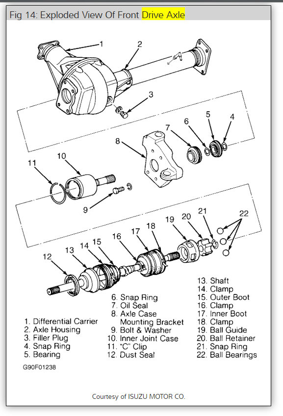

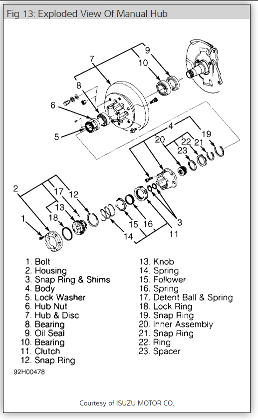

How do I replace the driver side front axle?
Nov 23, 2018 at 10:10 PM
Experienced Mechanic
55,658 POSTS
Here are diagrams to help you see how then front axle comes apart. Check out the diagrams (below). Please let us know if you need anything else to get the problem fixed.
