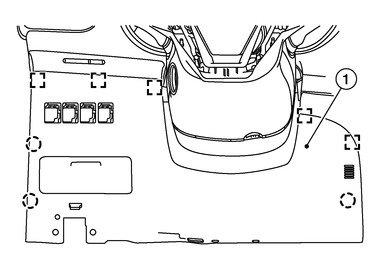

Can I access this from the glove box and do you have an exploded view and instructions? Thank you

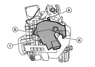

There are a couple of things that will need to be removed. Here are the directions. The attached pics will correlate with the directions.
____________________________
2016 Nissan-Datsun Maxima V6-3.5L (VQ35DE)
Air Mix Door Motor (LH) - Removal and Installation
Removal and Installation - Air Mix Door Motor (LH)
REMOVAL
Remove the instrument lower panel LH. Refer to Removal and Installation.
Remove the front floor connecting duct (LH). Refer to Exploded View.
Remove the screws (A) and the front foot duct (LH) (1).
pic 1
Remove the air mix door motor (LH) screws.
Disconnect the harness connector from the air mix door motor (LH) and remove.

Duct exploded view (pic 2)

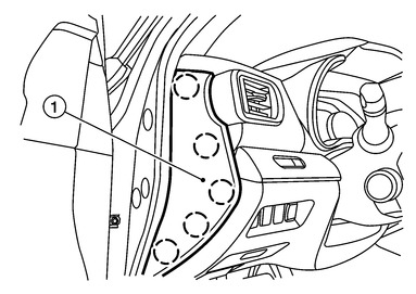

Lower panel removal:
Instrument Lower Panel LH - Removal and Installation
INSTRUMENT LOWER PANEL LH - REMOVAL AND INSTALLATION
REMOVAL
Release instrument side finisher (LH) (1) pawls using a suitable tool and remove.

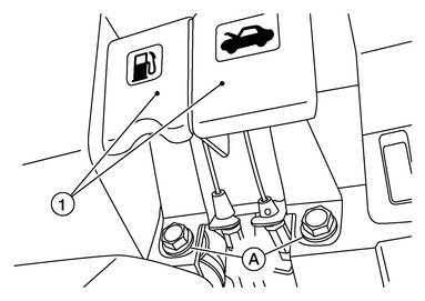

Remove bolts (A) and fuel filler lid/hood lock release handle (1) from instrument lower panel LH.

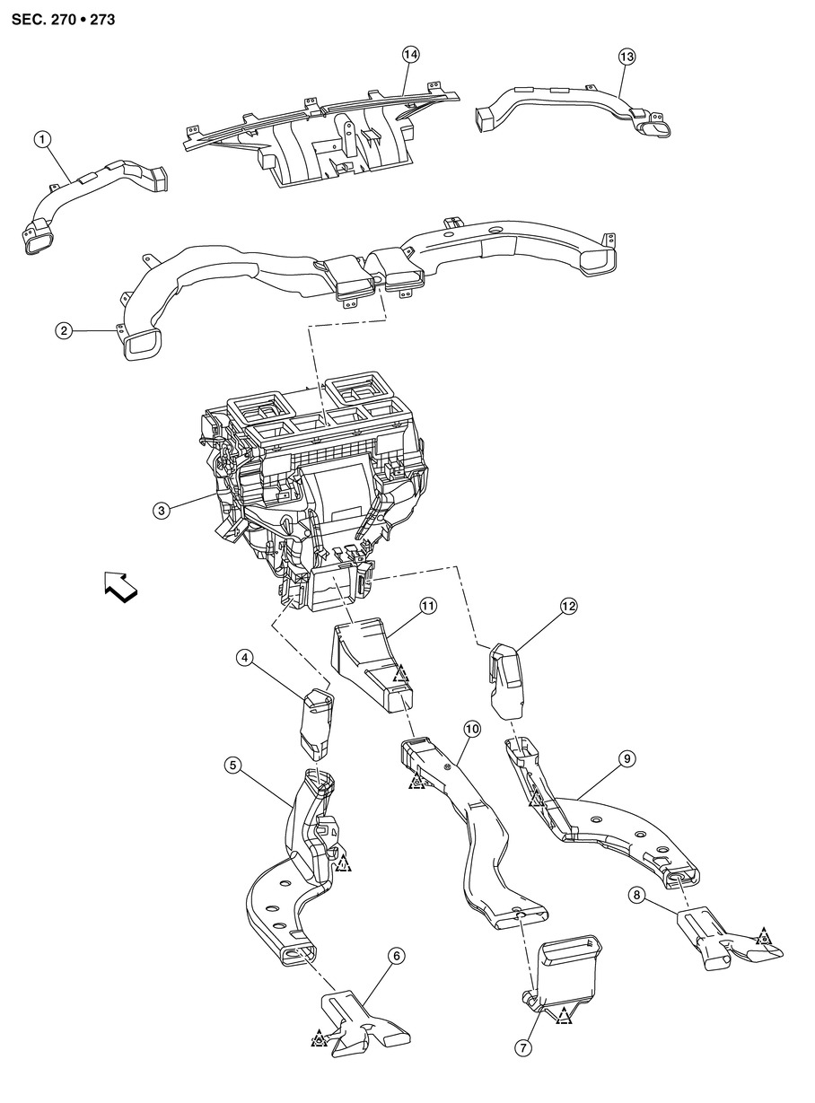

Release instrument lower panel LH clips and pawls using a suitable tool.
pic 5
Disconnect the harness connectors and aspirator hose.
Release gap hider and remove instrument lower panel LH.
If necessary, remove switch carrier. Refer to Exploded View.
