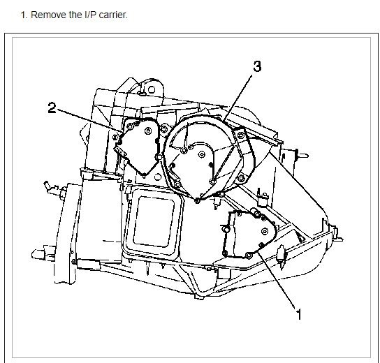

Hi, my vehicle is having temperature difference in A/C vents. driver side A/C vent is hot comparing passenger side. after searching internet i hoped the problem was with driver side temperature door actuator and decided to change it.
But i could not find the location of the actuator on the driver side.
Please guide me about the location of driver side actuator and access to it.
Thank you
Jun 27, 2017 at 3:18 AM
  • 55,710 POSTS
There are two on the drivers side, here is a diagram (below) that shows their location.
Here is a guide that may help you get the job done.
