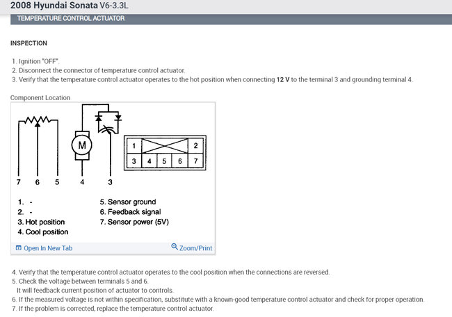

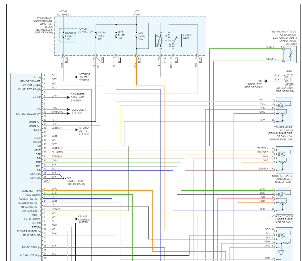

I have been troubleshooting my driver side A/C. So far, I have replaced the blend door, however it still won’t move. I’m not sure if there is a fuse or if there is a calibration. I tried hooking up my multi meter to the plug while the key was on and I didn’t seem to get anything though it was tough to get full connection with the meters probes into the tiny plug and I couldn’t find a diagram online. Thank you for your help!
Jun 23, 2023 at 3:33 AM
  • 55,224 POSTS

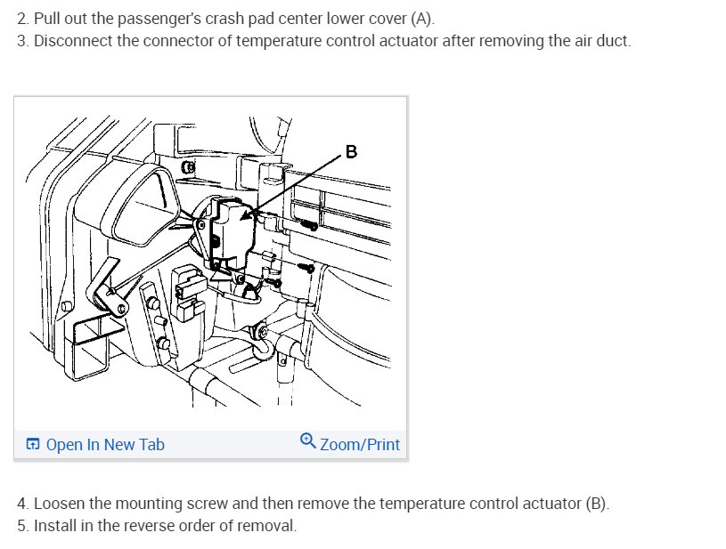

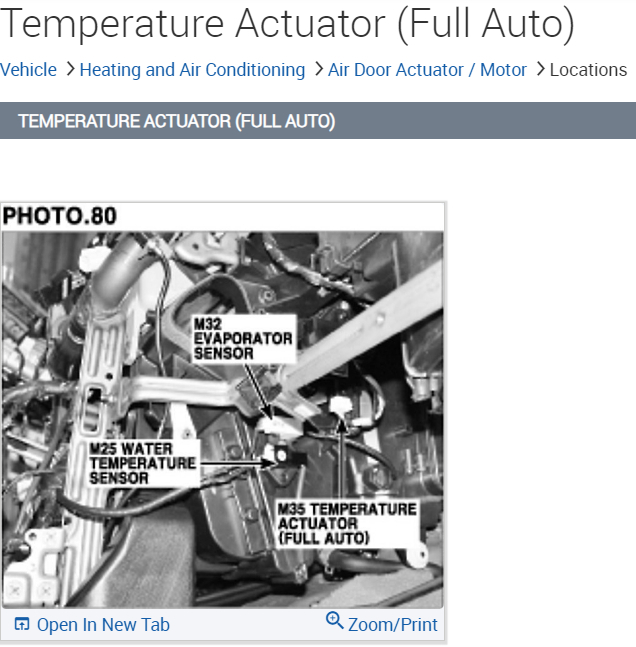

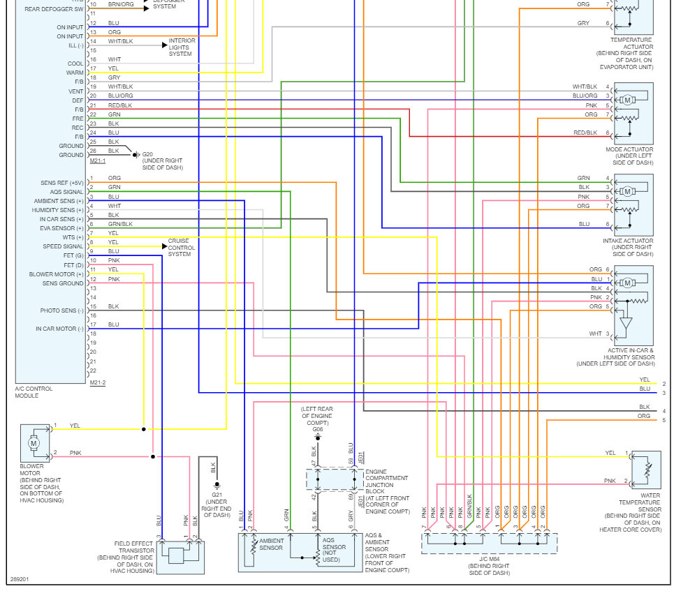

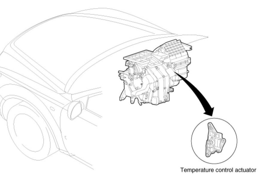

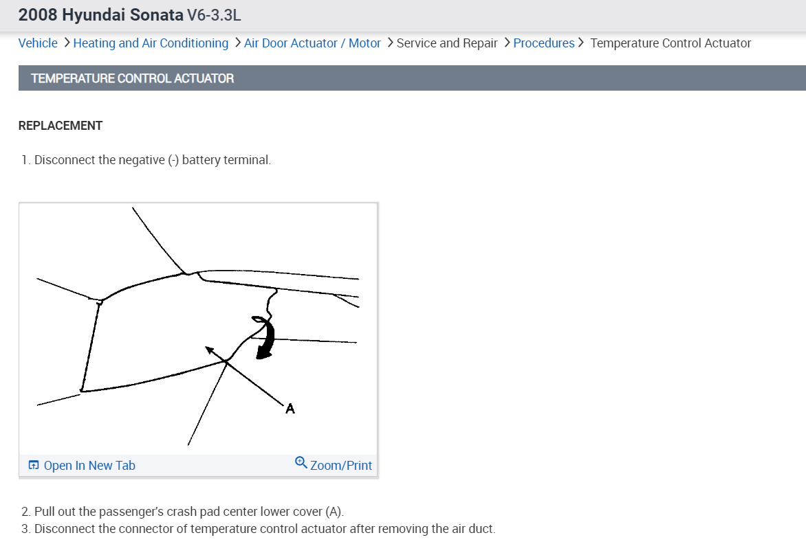

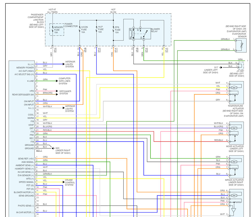

It says there is only one temperature control actuator, does your car have dual control? Here is the location of the actuators to make sure you have the correct one and the HVAC system wiring diagrams so you can see which wires to test and how the system works.

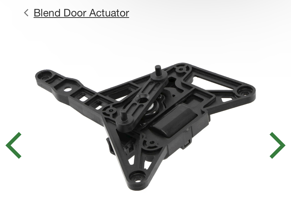

Hello Ken! Yes, I believe I have two then. The diagrams you listed say it’s on the passenger side however I replaced the blend door actuator that’s located on the driver side. The actuator I installed looked like this.
Jun 30, 2023 at 9:17 AM
  • 55,224 POSTS

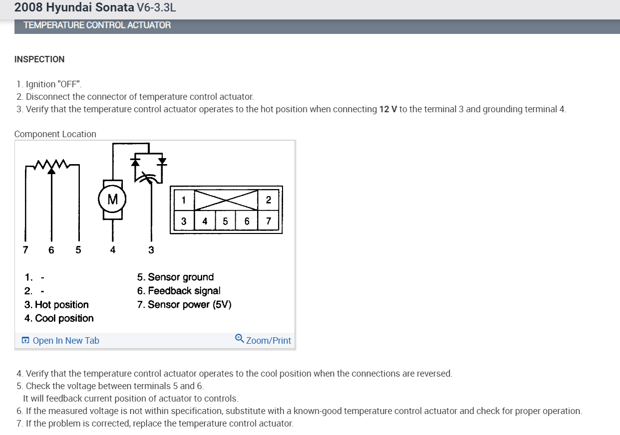

Yep, that looks like it, can you monitor the actuator when you work the controls to see if they move?
Jul 1, 2023 at 4:34 AM
OWARDIV
  • 5 POSTS
When I switched between hot and cold on the temp dial the actuator or the disk that it’s attached to did not move.
Jul 1, 2023 at 8:46 AM
  • 55,224 POSTS
Okay, let's remove the actuator and try to move the blend door by hand to make it is not obstructed. Also, plug in the actuator and work the controls to confirm the actuator failure. Also, my info tells me there is only one temperature actuator so you may have the A/C system low on charge which can case this is as well here is a guide to help you go over the system also, I found additional images for the blend door actuator for temperature.
