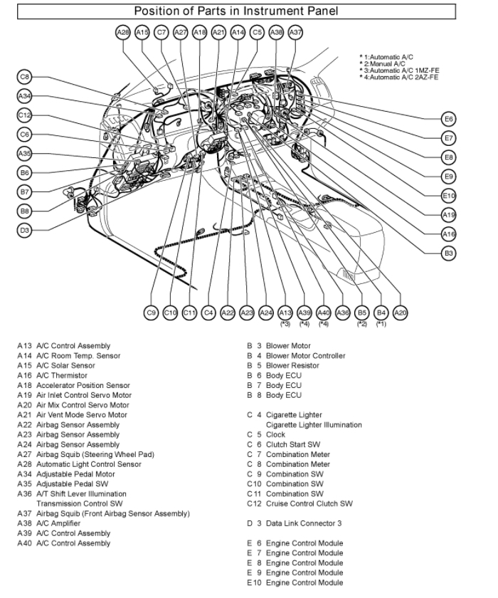

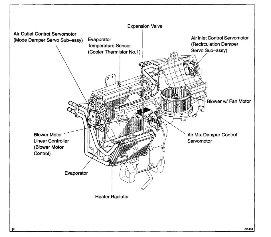

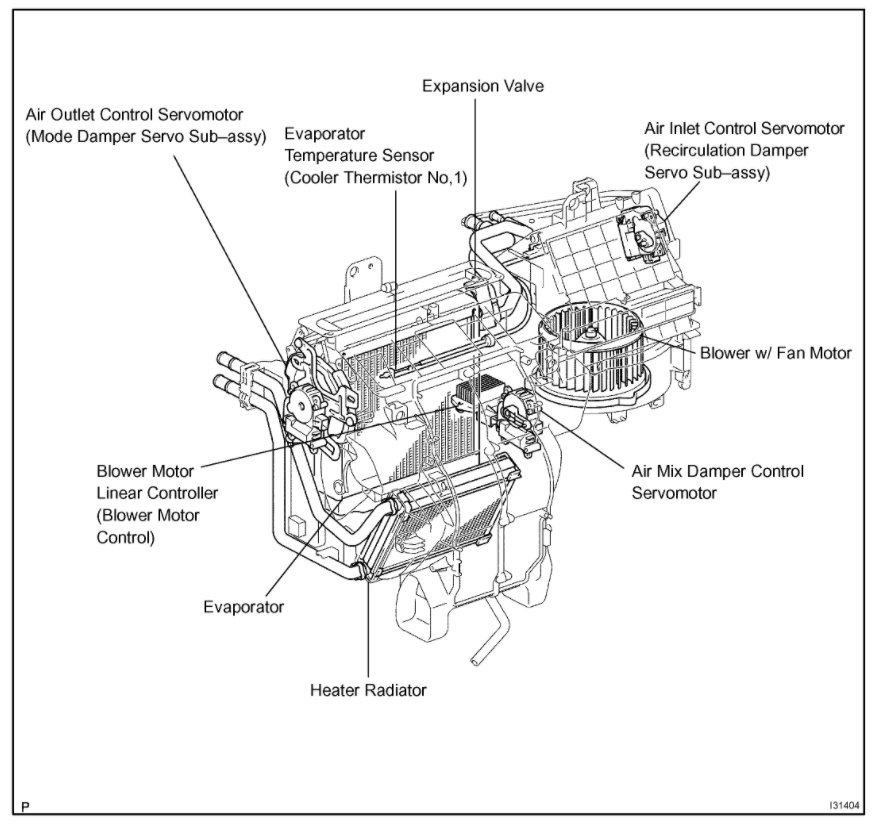

A/C blows cold on the passenger side but hot on the driver side. I was trying to find out what actuator that is and where it's located.
Jul 20, 2022 at 1:29 PM
  • 55,732 POSTS
Yep, it does sound like the driver side blend door actuator is not working. Here is a generic guide to help you see what you are in for with specific instructions in the diagrams below for your car:
