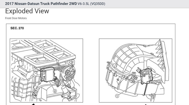

I need to know which blend door controls this problem, diagrams if possible.
Oct 11, 2022 at 1:53 AM
  • 55,412 POSTS

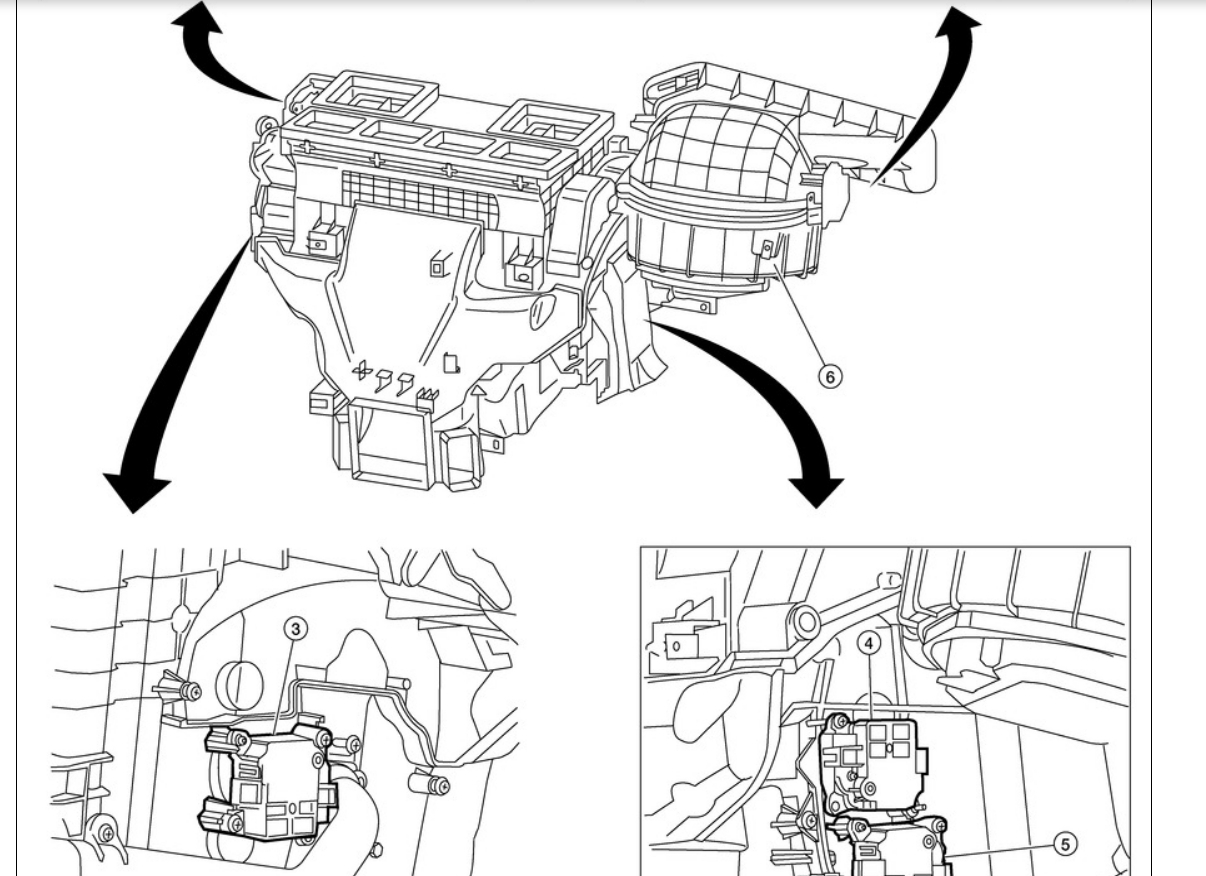

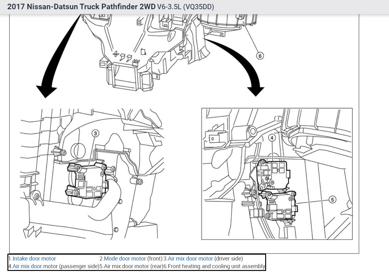

Yep, here is the location of the driver's side blend door actuator which it looks like controls the temperature of the rear HVAC unit as well.
Removal and Installation - Air Mix Door Motor (Driver Side)
REMOVAL
Remove the center console side finisher (LH). Refer to Exploded View.
Remove the front foot duct (LH). Refer to Exploded View.
Remove the air mix door motor (driver side) screws.
Disconnect the harness connector from the air mix door motor (driver side) and remove the air mix door motor (driver side).
INSTALLATION
Installation is in the reverse order of removal.
Check out the images (below). Please let us know if you need anything else to get the problem fixed.

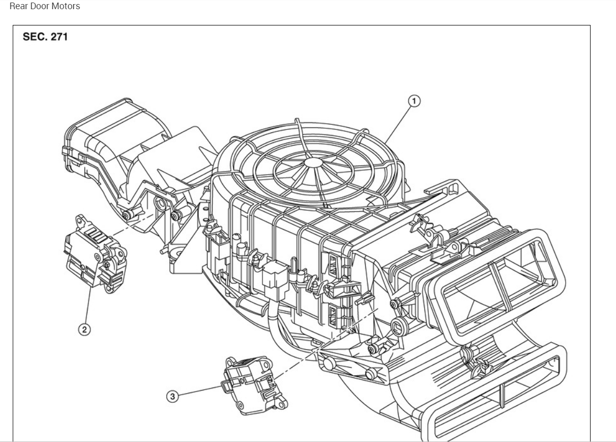

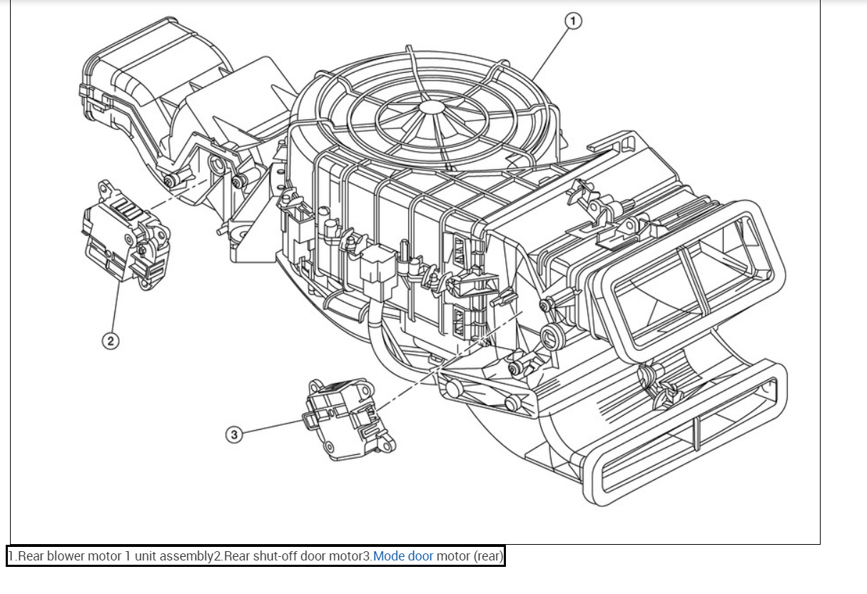

I took it off and left it plugged in and the blend door is still turning. Are there any other blend doors it could be? on the diagram you sent there's two number 3's which one is it?
Oct 12, 2022 at 8:24 AM
  • 55,412 POSTS
Did you try to turn the pivot on the HVAC plenum by hand to see if anything changes? It could be the actuator is working but the internal door is broken. The #3 is on the driver's side. The other #3 is for the rear system.
