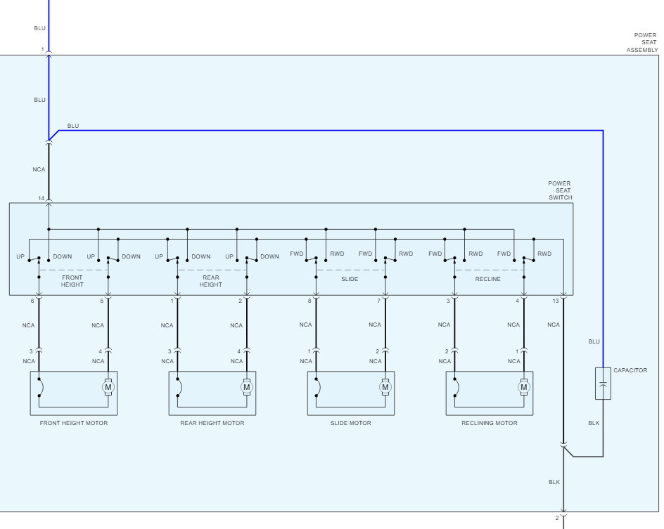

Engine listed above is a - 3.5L not 1.8. Drivers' seat chair will not move forward or back.
the lumber support works as it tilts and goes up and down for seat height just wondering what it could be?

This is likely an issue with the power
seat motor that controls the back-and-forth motion.
This power seat has four motors for different functions.
So, the issue could be a bad motor, or it could be a wiring issue, like a broken wire or corroded connector.
Since the Magna was not sold in the US, I do not have diagrams for the motors.
But those motors are located under the seat.
You will have to locate the motor and check to see if you are getting power to it. If there is power, then it is a bad motor.
Here is a wiring schematic for your reference.
