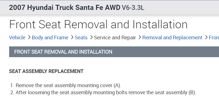

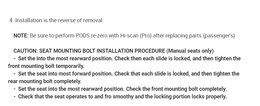

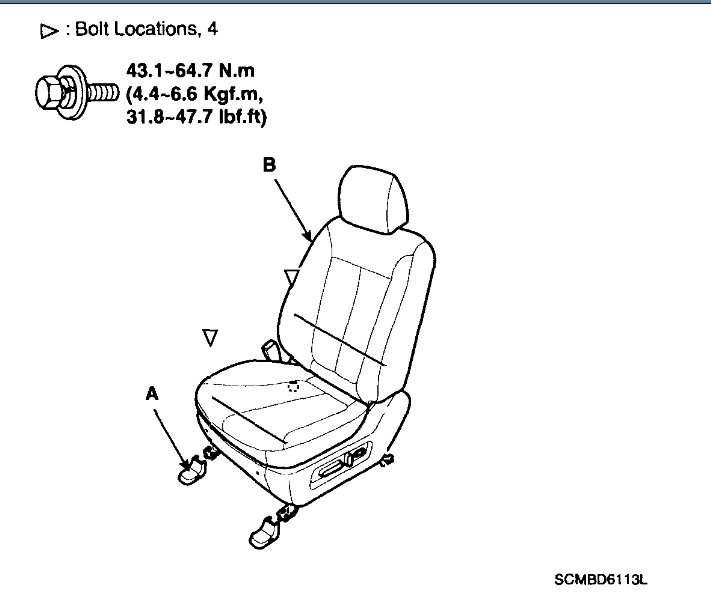

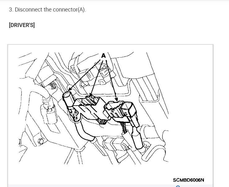

Trying to change out my driver seat with a used one. do you have an installation guide remove and put one in? thanks
May 30, 2019 at 5:57 PM
SCGRANTURISMO
  • 4,897 POSTS
I have included the guide that you requested in the diagrams down below for you. Please go through this guide and let us know how everything turns out.
Thanks,
Alex
