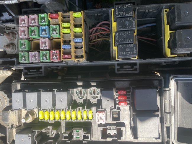

Every single one of my lights work except my driver's side rear running light, I put in a new connector panel on back thinking it may be the socket but no, I don’t know if it could be a fuse because everything, but one works, all new bulbs except the tiny little one. I didn’t see any problems with wires, there were trailer lights hooked up, but they were disconnected and just tied to the vehicle. I’m lost, I don’t know what it could be.

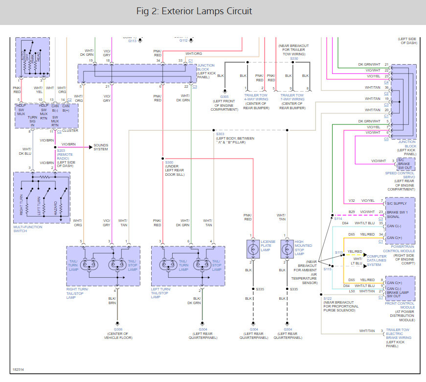

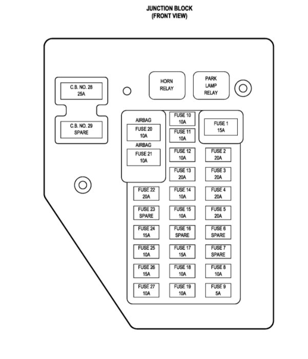

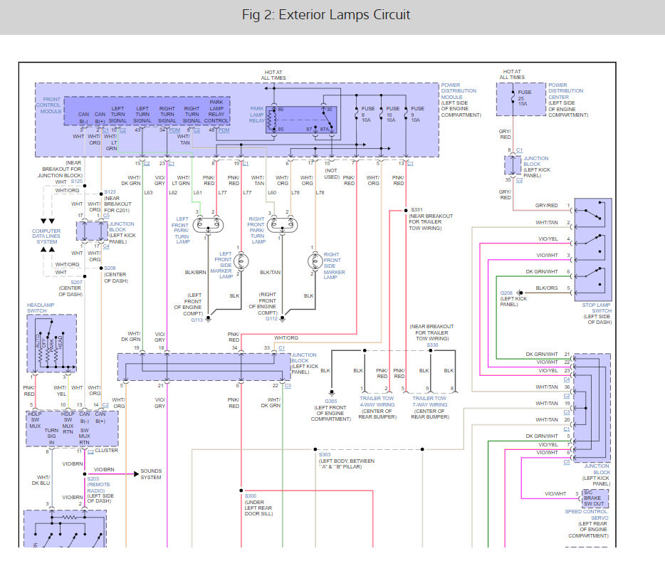

There is a fuse #8 in the power distribution module that needs to be checked for power. To see if the fuse is good this guide will help you test the fuse and for power as well. Also included the fuse location in the diagrams below, plus I have included the wiring diagrams for the system so you can see how it works.

I’m home in roughly two hours and will have an explanation. Thank you for pointing that out. I also went to use my multimeter at work today and it went down so I will not be able to do anything but pull and temp a proper fuse to get an answer.

The diagram doesn’t match.

The left box has a 10a fuse far right that has no continuity.
