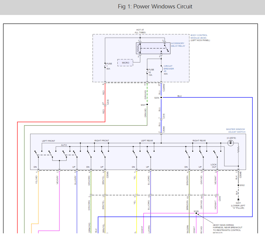

I have the door ajar sensor problem. So to fix it. I cut the wrong wire and ground it which caused a spark. Reconnected the wire. Now my driver power window will not work. Green purple wire.

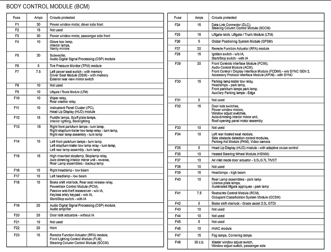

Check fuse 32 (15A) in the body control module.

I did almost exactly the same thing. I shorted the wrong wire to ground trying to fix the door ajar issue...which caused the driver side power window to stop working. I checked fuse #1 in the BCM and it was fine. Based on Steve W's suggestion, I checked fuse #32, and it was blown. I changed the fuse and the power window works again! As a side note, I did find the right green/violet stripe wire that goes to the driver door ajar sensor. There are two green wires with a stripe in the wire bundle behind the removable panel that runs along the floor by the driver door...as I recall the correct wire for the door ajar sensor is slightly thinner.

I have Ford Edge Limited 2013, also almost exactly the same thing. I shorted the wrong wire to ground trying to fix the door ajar issue.
But I checked fuse 32 it was fine, so only window drive not work to now, what I do, please?

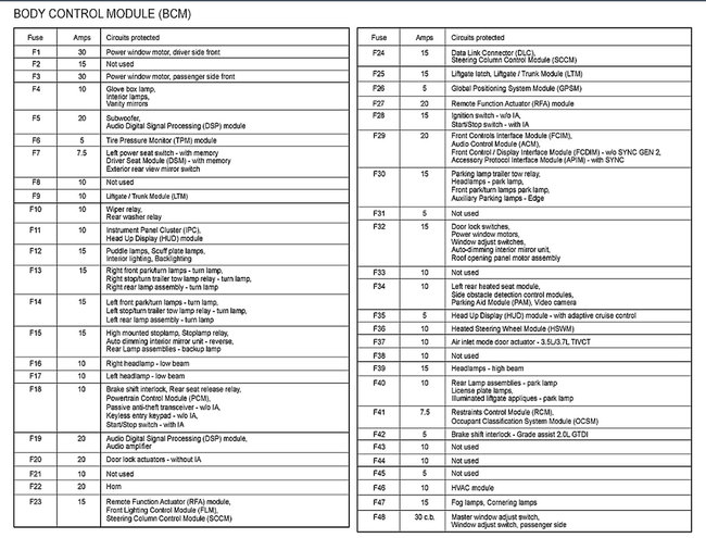

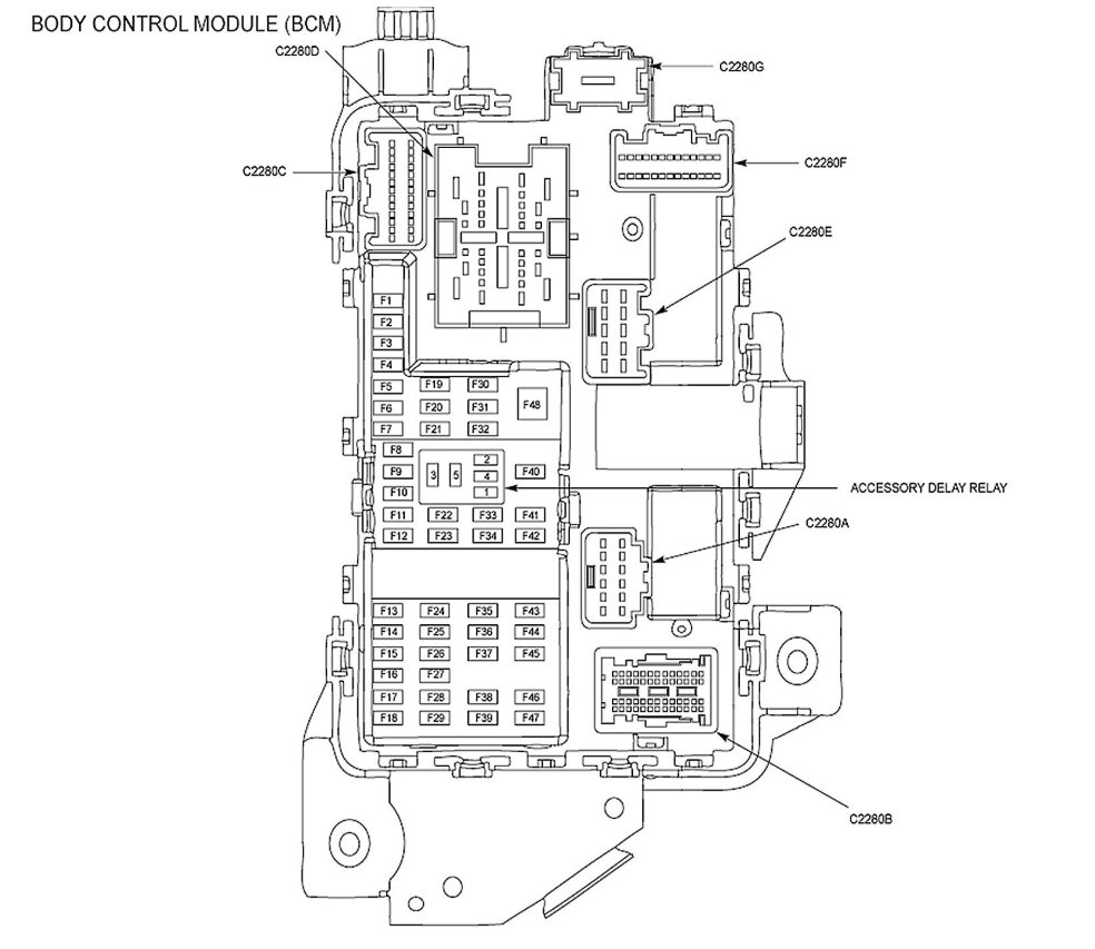

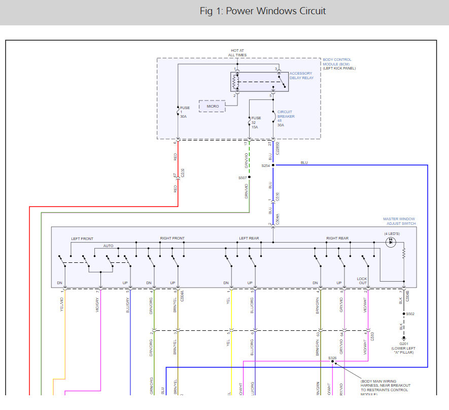

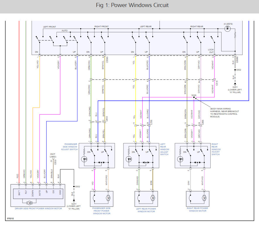

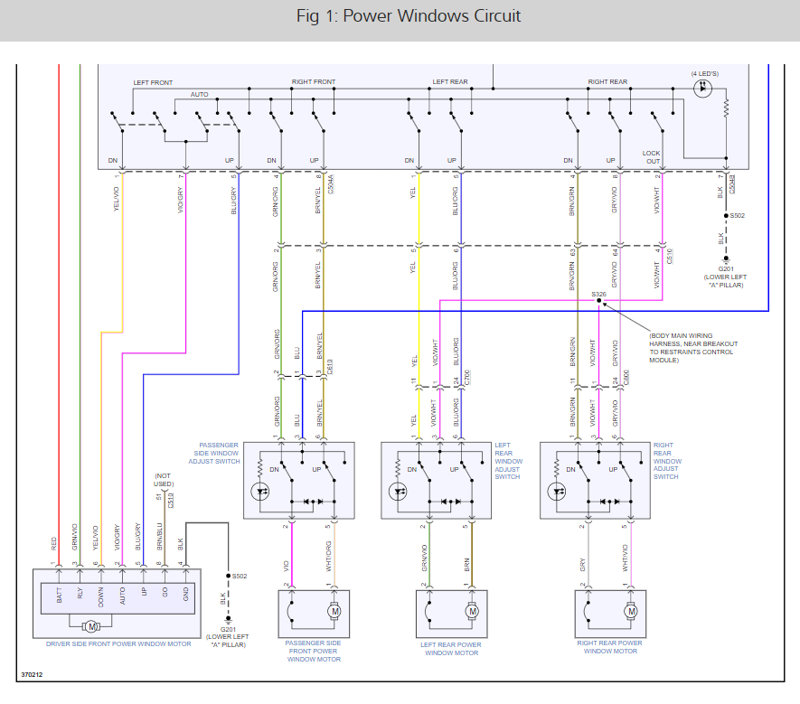

There is a circuit breaker #48 and an accessory delay relay that need to be checked. here is a guide and the location of the breaker and the relay with the window wiring diagrams so you can see how the system works:
and
May 18, 2020 at 4:21 AM
