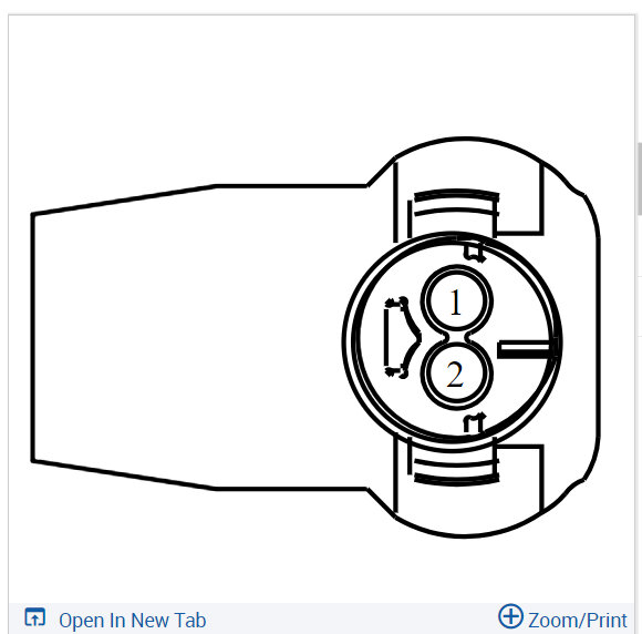

I’m trying to locate the correct airbag connector for the driver knee airbag.
Feb 14, 2024 at 6:35 PM
  • 55,423 POSTS
Sure, here you go:
Service Part Number: BU2Z-14S411-BHA
Gauge:20
Pin material:FCI - Airbag
Cavities:2
Vehicle Uses:
Airbag - Knee
Airbag - Side Curtain
Pretensioner - Seat Belt (Driver)
Pretensioner - Seat Belt (Passenger)
Sensor - Crash (Side Seat Airbag)
Sensor - Side Impact
Squib - Airbag (Driver)
Squib - Airbag (Passenger)

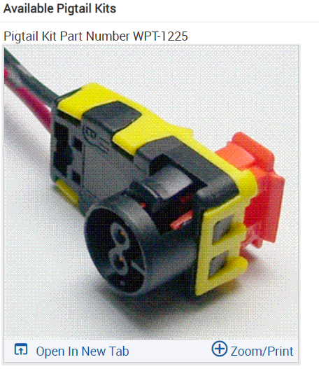

Pigtail Kit Part Number WPT-1225
