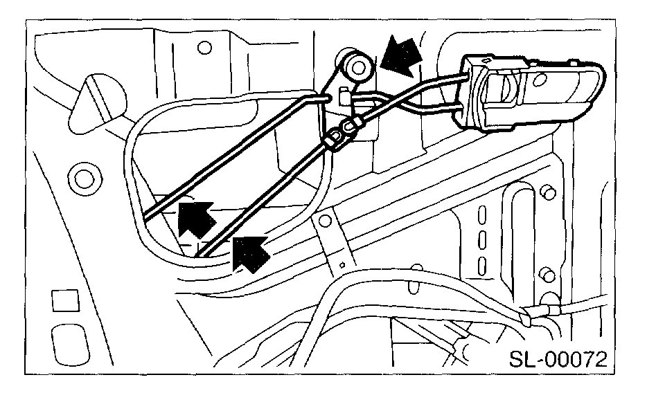

The driver side inside door handle broke off. How do I replace it?

Here are the directions. The attached pic correlates with the directions.
2003 Subaru Legacy F4-2.5L SOHC
Removal and Replacement
Vehicle Body and Frame Doors, Hood and Trunk Doors Front Door Front Door Handle Front Door Interior Handle Service and Repair Removal and Replacement
REMOVAL AND REPLACEMENT
Front Inner Remote
REMOVAL
1. Remove the door trim.
2. Remove the sealing cover.
3. Remove the two rod joints.
pic 1
4. Remove the screw, and detach the front inner remote.
INSTALLATION
Install in the reverse order of removal.
NOTE: Make sure the inner remote works properly after installation.
