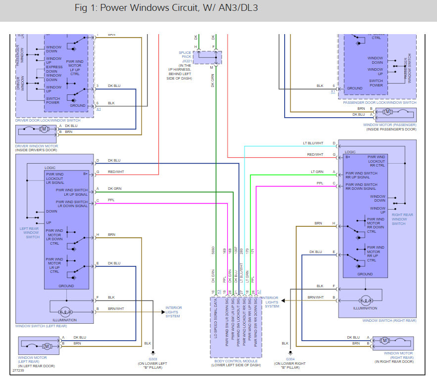

on a crew cab all the windows but the left front work. I have replaced the switch panel and the regulator and nothing happens except other three windows work perfectly.

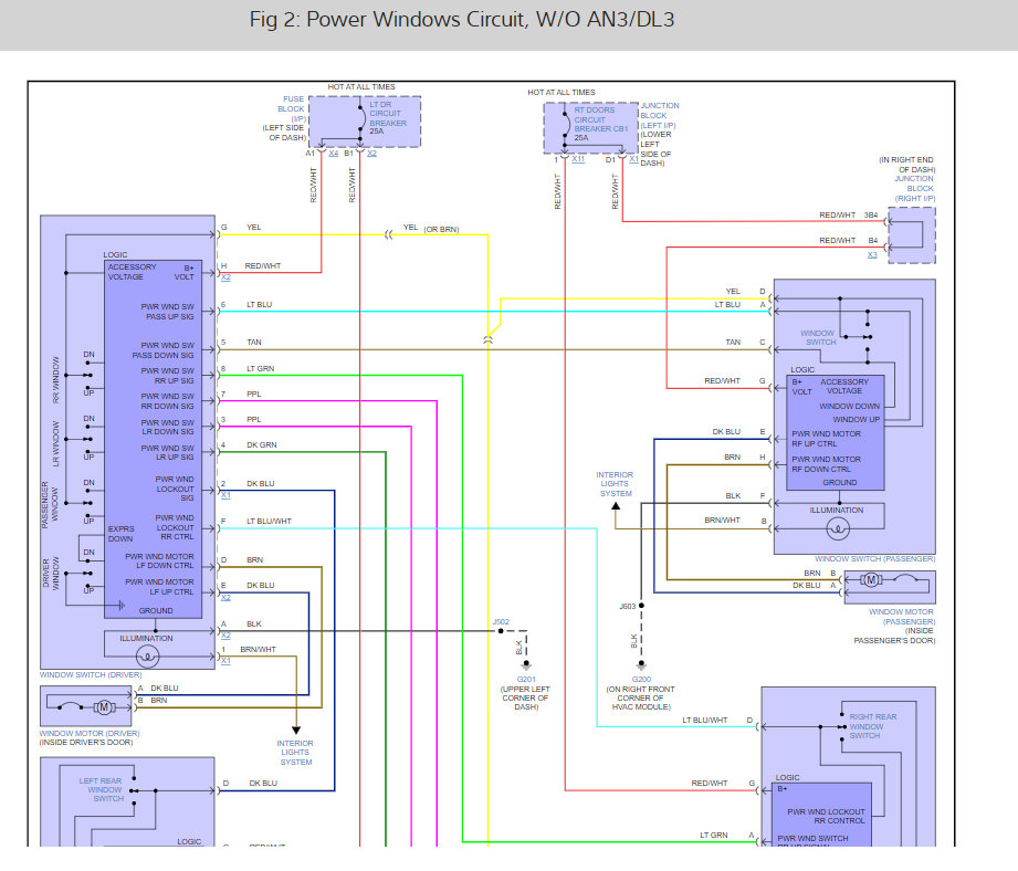

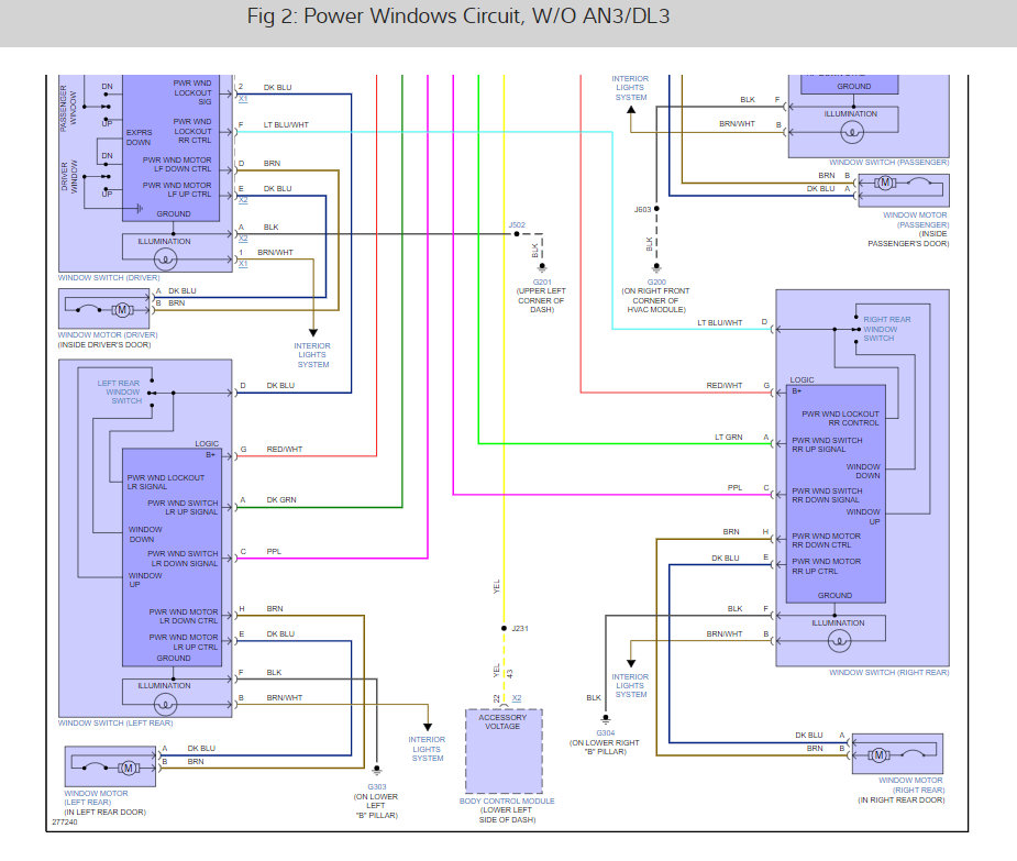

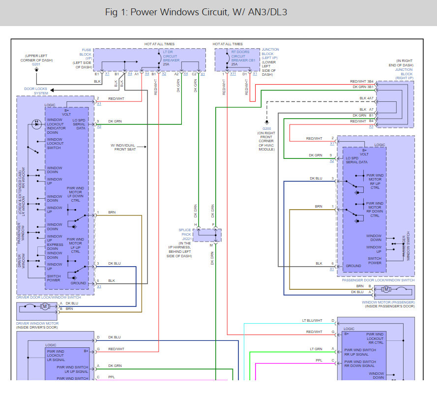

We need to check for continuity between the dark blue and brown wires going from the motor to the switch. This guide will show you how and I have included the wiring diagrams so you can see how the system works. it sounds like the wiring in the door jamb may have broken.

My son had a little time today when he found the black wire wasn't tight in the switch plug and I have five broken wires going through the door. Thanks for your help.
