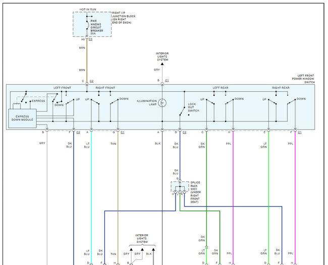

My front driver side window rolled down and I had to pull it up and now it doesn't work.
Friday, November 15th, 2024 AT 2:00 AM
KEN L
MASTER CERTIFIED MECHANIC
54,255 POSTS

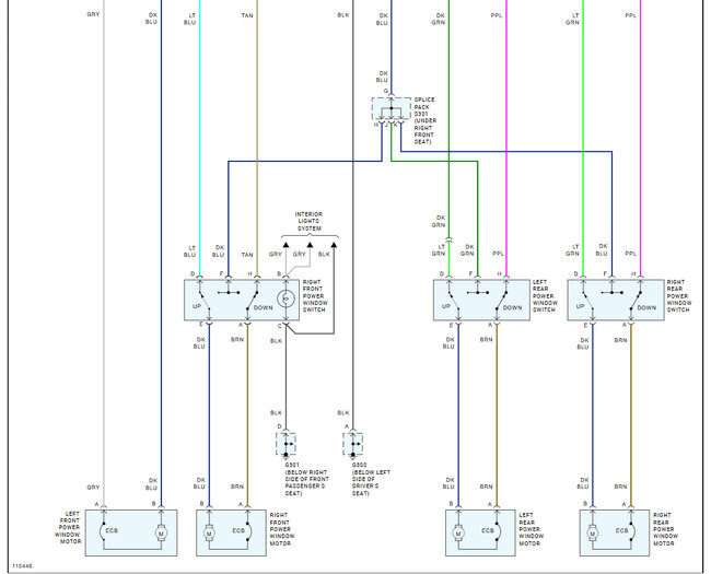

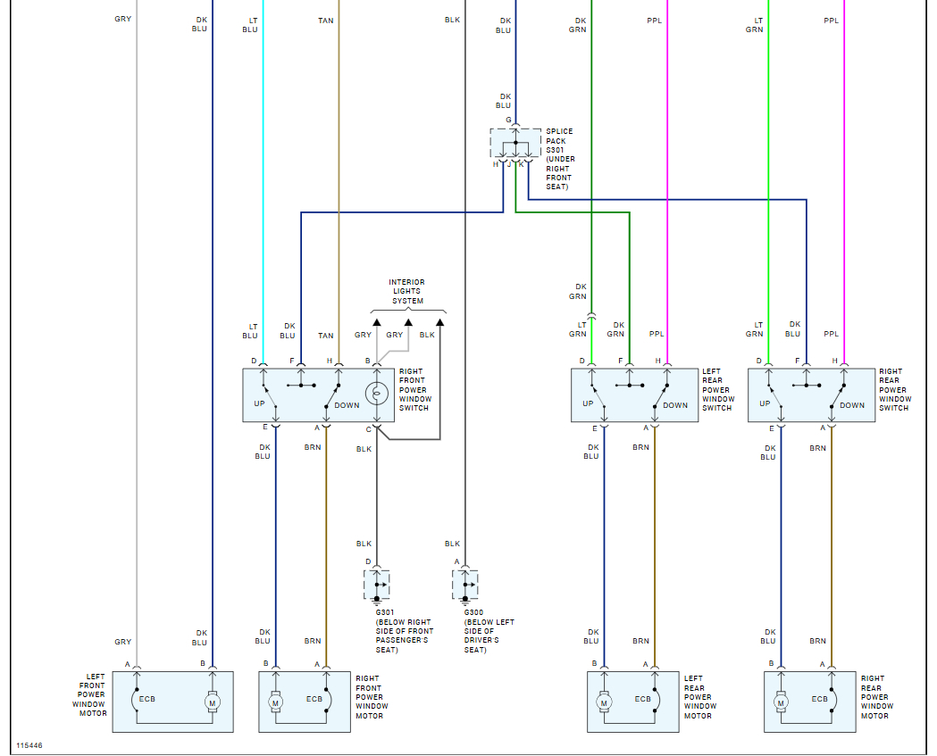

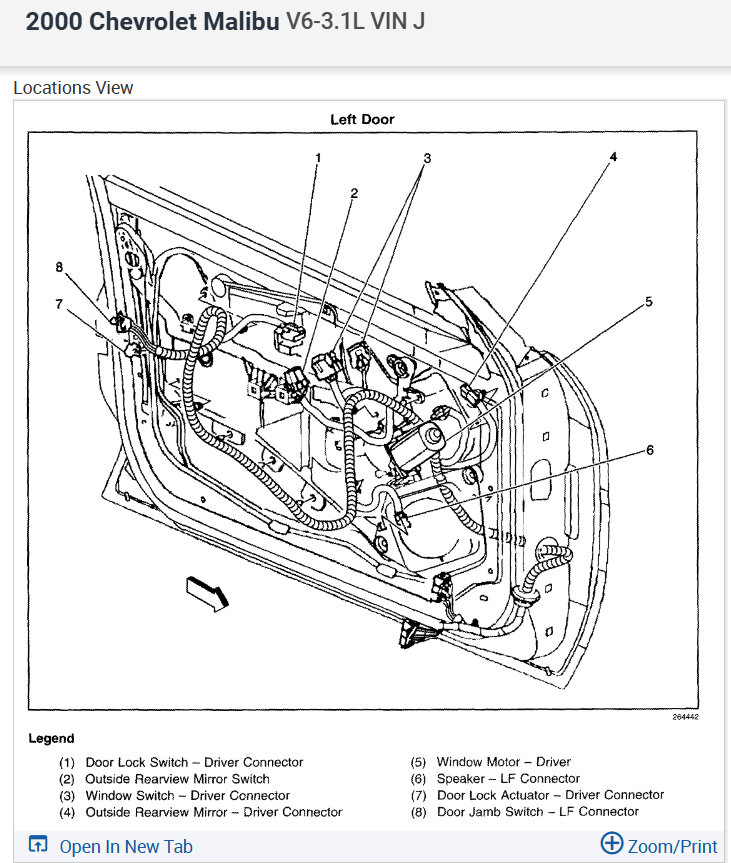

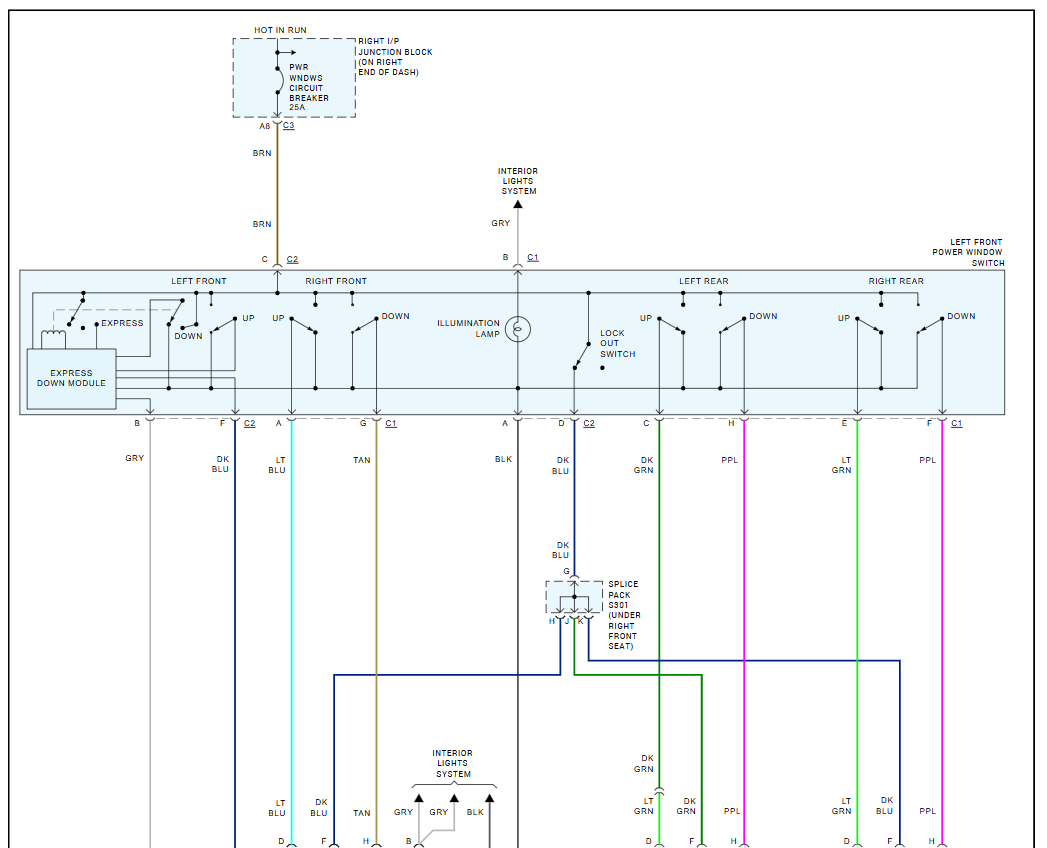

It sounds like the switch or window motor is bad, here are the wiring diagrams so you can check it out and a guide to help you test the system.
https://www.2carpros.com/articles/electric-window-repair
Here are the wiring diagrams and I added a window motor image as well. Check out the images (below). Please let us know what happens.
