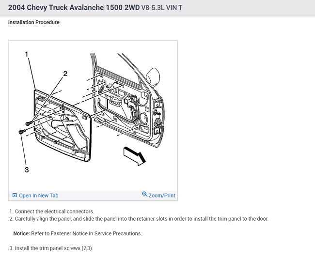

I have checked all fuses and relays. It had started to kind of lose power but just every so often 1 time in 3 months. That was why it wasn't fixed I have lost a lot of my short term memory retention so I'd forget it happened. But then it go where it was on and off rapidly one day and after 20 minutes of driving home, I got out and tried to get back power but no luck. I visually and with meter checked all fuses. I need to fix the door pin it is sagging a little where do I need to check wires for breaks
May 17, 2023 at 2:56 AM
  • 55,743 POSTS

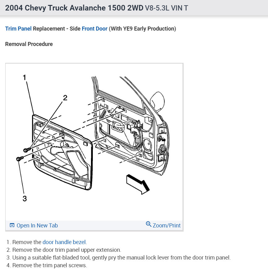

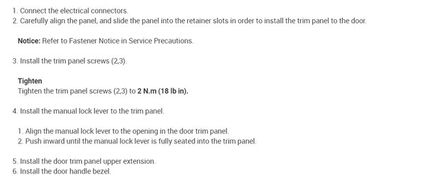

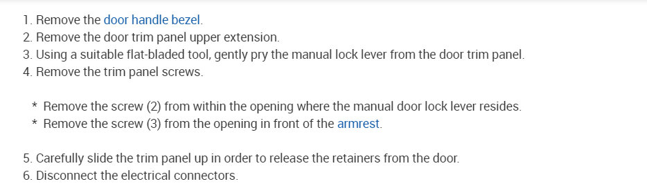

Yep, so what happens is the power wire inside the door and the door jam becomes weak and breaks I would remove the door panel and the rubber boot between the door and the jam to see if you can find the damaged/broken wire. Here is how to remove the door panel in the images below.
