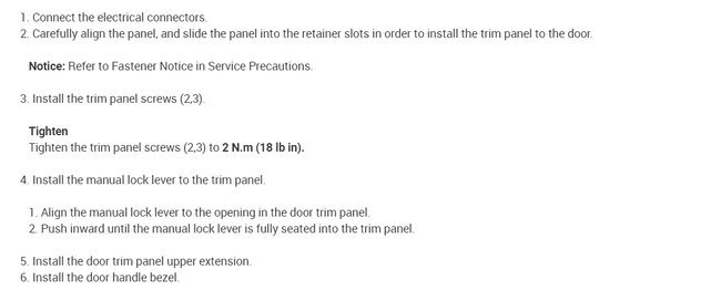

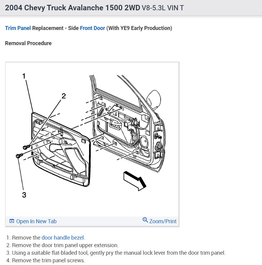

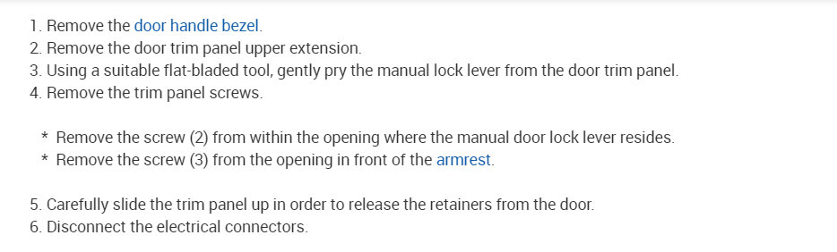

Yep, so what happens is the power wire inside the door and the door jam becomes weak and breaks I would remove the door panel and the rubber boot between the door and the jam to see if you can find the damaged/broken wire. Here is how to remove the door panel in the images below.
