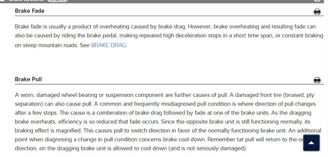

When i hit the brakes quick drive front locks up and pedal has springy spongy feeling. Doesn't matter if how hard i push the pedal just the quickness. Changed caliper pads and rotors. Truck also pulls to that side and i just had it aligned. Only does it the first couple times i use brakes when i first crank it after that brakes work fine.

This could be a problem with the tire on that side having low air pressure or a separated steel belt. Here is a link with plenty of videos for you to go to on the subject. It's a great guide on the subject, and please, get back to us with what you are able to find out after going through this guide and inspecting your vehicle.

Brand new tires before i got an alignment. Had this problem before new tires as well.

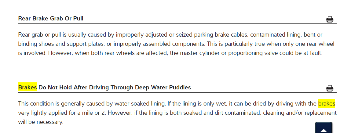

SCGRANTURISMO
  • 4,897 POSTS

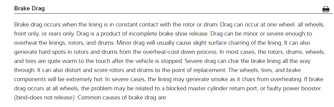

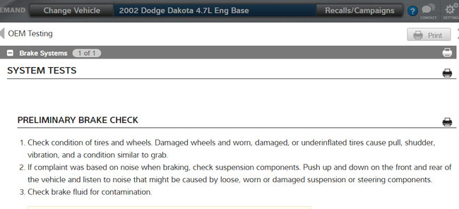

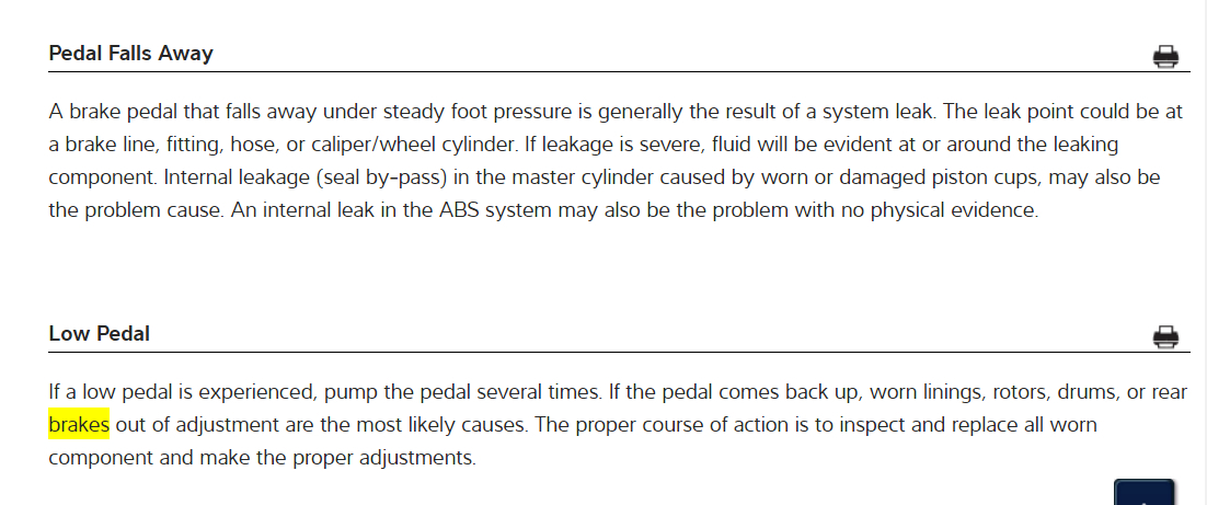

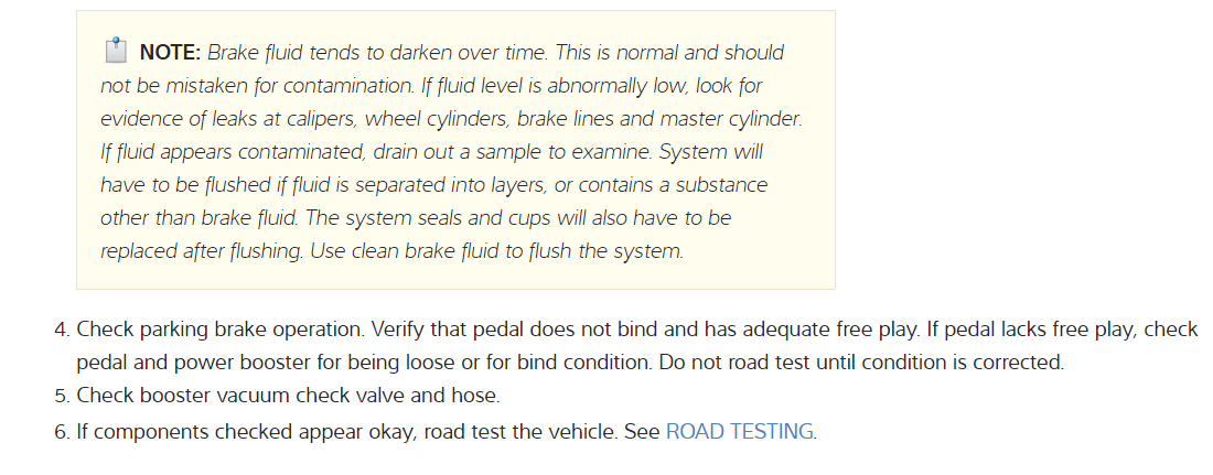

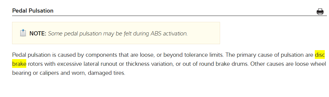

Hello again,

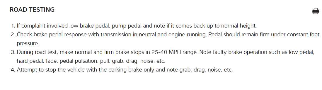

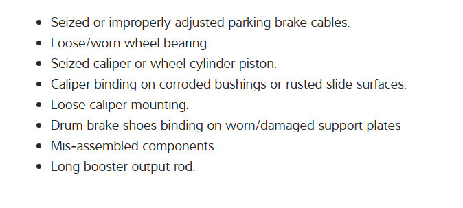

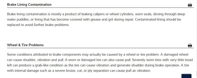

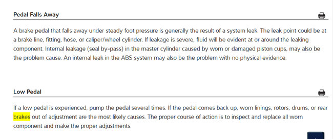

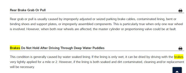

Okay, here is what the factory has to say on all the popular braking problems for your vehicle. Please go through this guide and get back to us with what you are able to find out. We can get more specific from there.
Thanks,
Alex
2CarPros

The third thing to look at is brake fluid contamination. That is a really serious issue if even a drop of petroleum product got into the brake fluid. We used to see this fairly often when someone cleaned and greased the older-style tapered front wheel bearings, they wiped their hands off with a rag, then pressed the rubber bladder seal back into the cap on the brake fluid reservoir. The film of grease on their fingertips was enough to contaminate the fluid. To identify that, look at the rubber seal under the cap of the reservoir, or on the old one if your new master cylinder came with a new reservoir and cap. If that seal is blown up and mushy, you will find it is impossible to poke it back into the cap. All the rubber parts in the hydraulic system that contact brake fluid have to be replaced for that, and the steel lines must be flushed and dried before installing the new parts. If any part with rubber is overlooked, the contamination will leach out of it and re-contaminate the new brake fluid.
To identify the cause of the dragging brakes, stop on a slight incline, shift to neutral, then assuming the truck does not creep downhill on its own, place a block about a foot downhill of one tire so you do not look funny chasing after it if the brakes release. Start by loosening the nuts holding the master cylinder to the power booster. Allow the master cylinder to pull away from the booster a good 1/4". If the brakes release, look at the push rod and the adjustment of the brake light switch. Next, loosen the two line nuts at the master cylinder a half turn or so. If brake fluid spurts out and the brakes release now, suspect contaminated brake fluid. We will need to discuss that further.

There is no air gap between the pads and rotors. I never heard of anyone trying to measure that. There is a square-cut seal in each caliper that goes around the piston. When you apply the brakes, that seal sticks to the piston as the piston moves out to apply the brakes. Because it is sticking to the piston, it bends or deforms a little. When you release the brakes, that seal tries to straighten out. In doing so, that is what retracts the piston very slightly to prevent the pads from dragging. The amount the piston retracts is compared to the thickness of a sheet of paper.
There are two things that jumped out from your comments. The first one is in your very first sentence. You opened the bleeder screws at the calipers and the brakes didn't release. You are done at that point. We are trying to find where the pressurized brake fluid is being trapped and prevented from returning to the reservoir. No matter where that is occurring, opening the bleeder screws would release the fluid pressure and the brakes would release. Since that did not happen, there is no point in going to the master cylinder or its steel lines. There is no pressurized fluid trapped there once the bleeder screws were opened.
That quick test tells us you have a mechanical problem with the calipers, and you verified that when you found the pitted mounting bolts. Do not bother trying to clean them up. Replace them and be sure to lubricate them with high-temperature brake grease. Cleaning those bolts will not solve the problem. The caliper has to be able to slide on those bolts to self-adjust, to apply smoothly, and to release properly. Even if you can slide the caliper in and out by hand, there is tremendous force put on the caliper against those bolts when the spinning rotor tugs on the pads and caliper. With that force applied, the caliper will never slide freely. Once the chrome plating has lifted on those bolts, it is going to become embedded inside the rubber sleeves those bolts go through, so those must also be replaced. They are available as a hardware kit, and they come with rebuilt calipers.
The next thing to look at is the pistons. Very often a ring of dirt or rust builds up around it. You have new rotors and new pads. Both of those are a lot thicker than the old p[arts you took off, so you had to push the piston back into the caliper housing to make room for them. That forces that ring of dirt to go under the square-cut seal, and that will cause that caliper to not apply under light braking, and to not release after normal-to-hard braking. Back in the 1980's we rebuilt calipers as a part of every standard brake job, specifically to address this issue. Today we do not do that because we put miles on faster and go through more brake jobs before that dirt or rust has time to form. When we do need to take care of that, it is much less expensive now to just pop on a pair of professionally-rebuilt calipers. They used to cost around $95.00 each. Today they cost around $20.00 to $30.00 each. If you rebuild the calipers yourself, a ring of dirt on the pistons can be washed off with Brake Parts Cleaner and a rag, then inspect them for signs of lifted chrome plating and rust spots. If you see that, the piston must be replaced. In the 1980's they cost about $20.00. You are better off today just buying the rebuilt calipers.
To identify a sticking piston, use a medium flat-blade screwdriver to pry it back into the housing before you unbolt the caliper. It should slide in fairly easily, then you will have room for those new pads and rotor. If you ever resort to using a c-clamp or you need one to get the piston to retract, you are done. Replace the caliper or rebuild it. Needing a c-clamp means you are pushing the ring of rust or dirt under the square-cut seal, and you are going to have problems. Also, a lot of vehicles use phenolic pistons to reduce weight. Those are easy to crack with a c-clamp. Brake system specialists do not even have a c-clamp in their tool box. Think of it this way. If you need a c-clamp to make the piston move, and flimsy little rubber seal around it is definitely not going to retract it after braking.
Replace the caliper mounting bolts. Be sure to lubricate them. You should have used brake grease on the backs of the pads too and on the three "lands" each rear shoe slides on. Check the pistons. If they are free, you can often retract them with your hands. That is how we put them in when we rebuild the calipers. And be sure to put the power booster push rod back were it was. There is only one correct setting. It is not meant to be an adjustment that makes up for something else.

i have a problem with the rear driver tire locking upand you have to scid to a stop when the breaks are pressed down.
Nov 27, 2020 at 12:55 AM (Merged)
EUGENE123
  • 273 POSTS
suspect a leaking wheel cylinder
CARADIODOC
  • 34,369 POSTS
Suspect a sticking parking brake cable. If no other brake work has been done when this problem started, try flexing the cable in the casing in front of the wheel. You can also try pulling down on the cable in front of the casing, then watching to see if it retracts by itself. If flexing the casing stops the problem, suspect a rusty cable. Over adjustment will do this too.
If the cable doesn't appear to be the cause, remove the brake drum and look at the shoes. Both of them must be against the large anchor pin on the top. If they are, look at the parking brake strut rod between the two shoes. You should be able to push it at least 1/16" to compress the anti-rattle spring. If either of these are not correct, they will cause grabbing brakes. The parking brake cable is still the likely cause, but grossly under-adjusted brakes can cause this condition too if the automatic adjuster cable is broken. You would also notice a lower than normal brake pedal.
Look for contamination from axle grease, and a disconnected or rusted link from the rear axle to the height-sensing proportioning valve.
If work was recently done to the brakes, suspect the wrong shoes in the wrong locations. The shoe towards the front of the truck must be a lot shorter than the one towards the rear.
If this only happens during the first stop of the day, especially on dirt roads, it could be normal rust buildup on the drums overnight from humidity in the air. Not much you can do about that.
