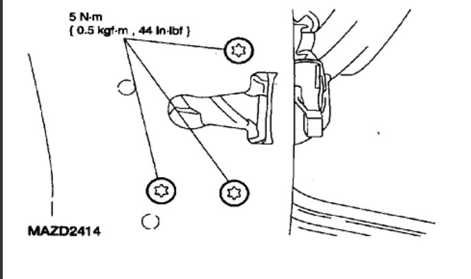

All doors will unlock except the drivers side.
Aug 26, 2017 at 1:58 PM
Experienced Mechanic
55,721 POSTS

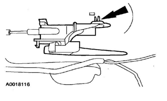

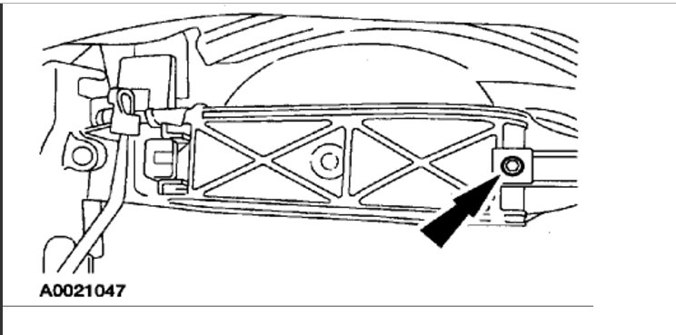

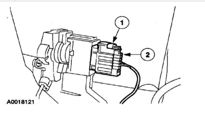

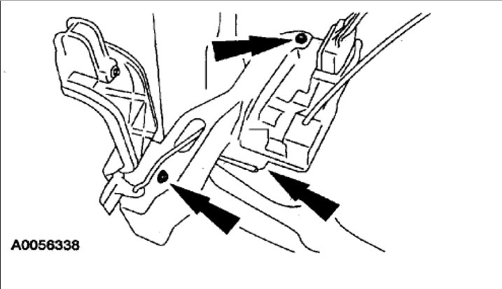

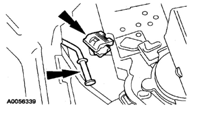

It sounds like the latch has gone bad and needs replacement. Here is a guide and some diagrams (below) to help you get the job done.
https://www.2carpros.com/articles/door-panel-removal
Let me know what happens.
