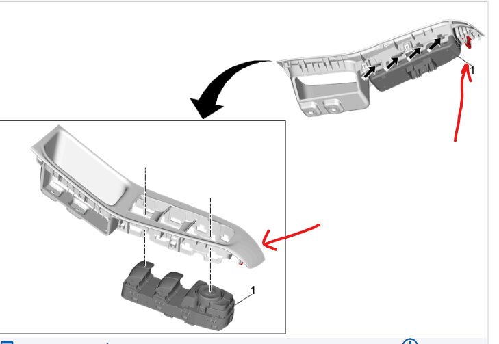

Yep, this is common when the driver door window switch goes out. To remove the switch lift the rear of the window switch retainer which is the large plastic piece around the switch, this will "pop" the plastic piece out and enable you to change the switch out, there is no programming involve. There is a logic broad inside the switch that goes bad Check out the images (below). Please let us know what happens. Ken

Well, I purchased a new switch from O'rileys and installed it, It didn't change anything at all. I have disconnected the door wiring harness and checked every wire end to end to confirm there are no broken wires.

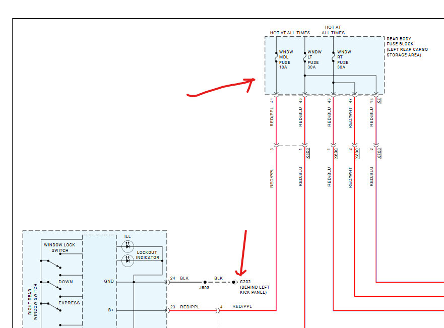

Hmm, does this car have express windows? There is a little output to the BCM for the window system. Lets check the ground behind the left kick panel and the fuses in the images below. Let me know, Ken

Hi Ken, yes I have express windows. Have checked all fuses multiple times and have checked continuity on every wire in the door to the body connector. I'm going to see if I can access the plug where the whole door harness plugs into the body of the car. Can you tell where to get a pinout diagram for the door looks and windows. I went to GM.com and Chevy.com and have had no luck yet.

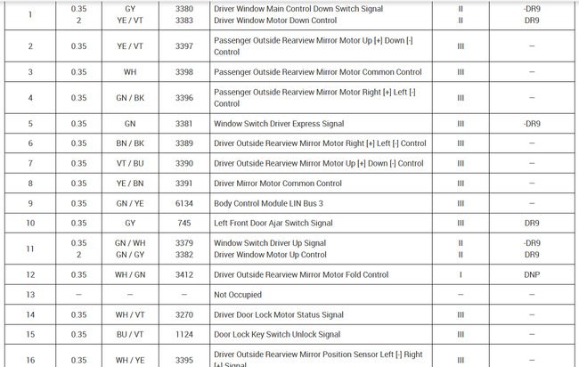

Yep there are many cases where the wiring a the door jam gets broken and causes issues. But this window motor might be out because it has logic in it as well. I was wrong earlier when I said the BCM was no involved, it is. You might want to do a CAN scan
CAN SCAN - https://youtu.be/u-4syLc-ifQ

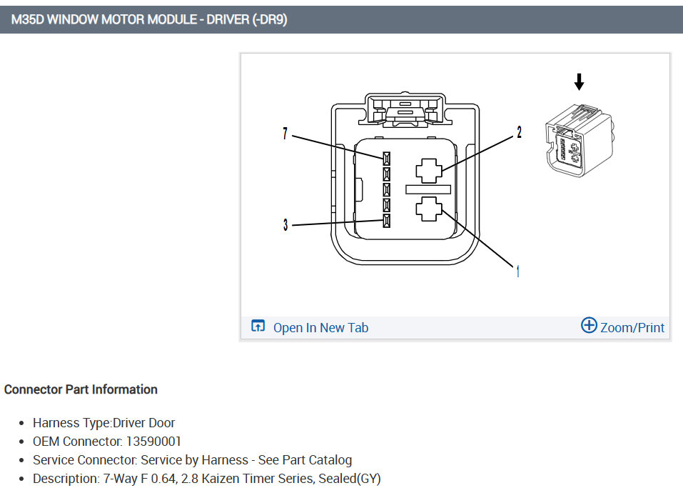

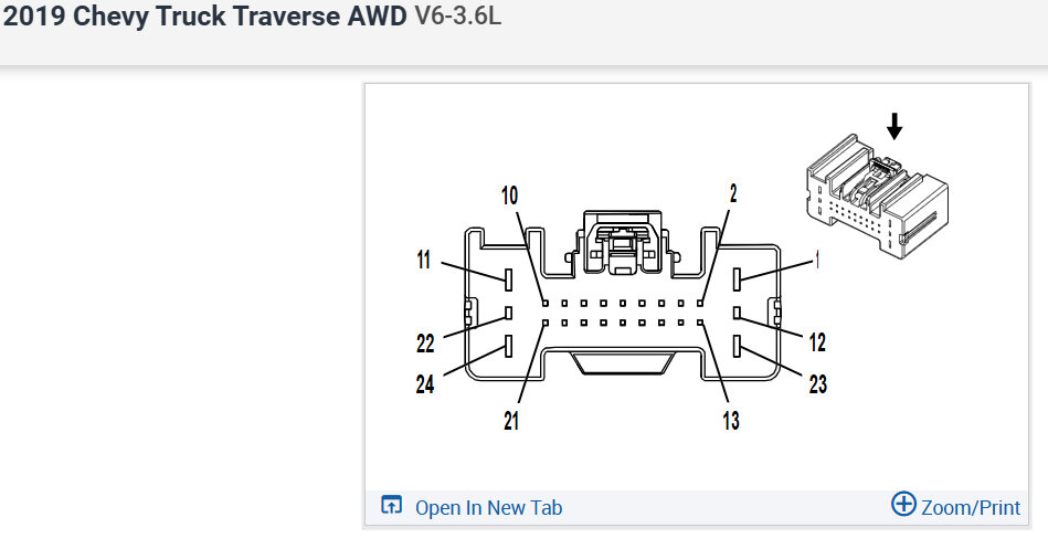

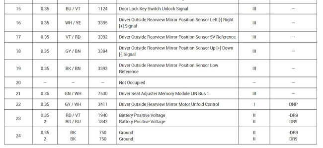

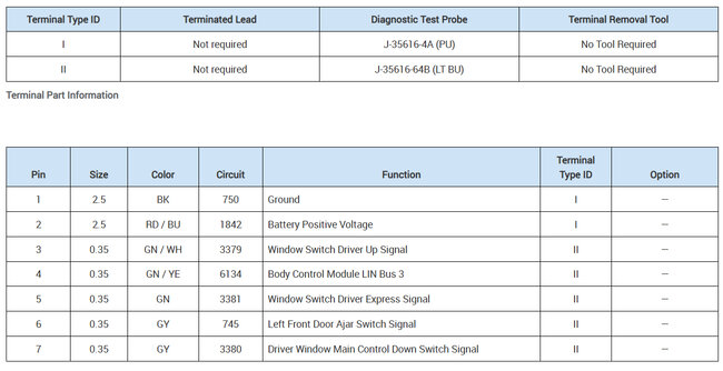

Here are the pin outs for the window motor and main window switch. Check out the images (below). Let us know how it goes

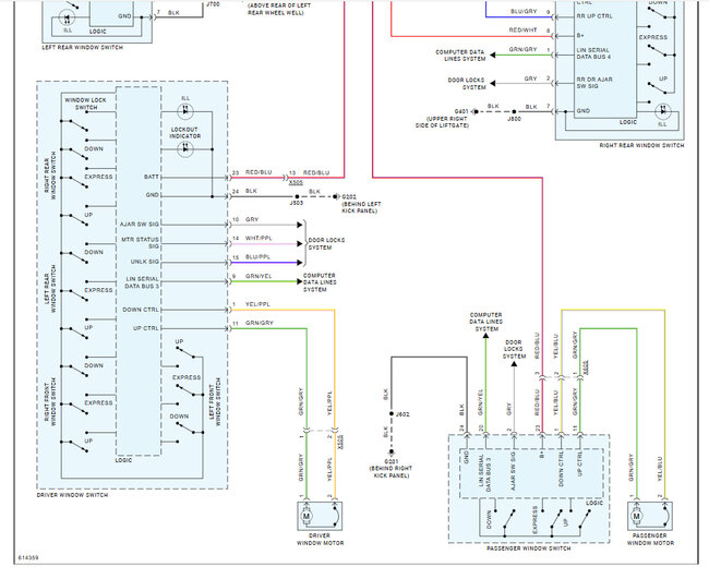

Thank you for the pinout for the window switch, is there anyway to ge a full wiring diagram including the window switch circuit board? I was testing the switch circuit board and saw multiple voltages at different points on the board. So my question is how to bypass the switch circuit board and test the window motor itself? The voltage on pins 1 and 2 is 12V, is the voltage on pins 3 & 7 also 12 volts? If I bypass the switch and apply 12V to pins 1 and 2 will the motor operate? or do I also have to apply a voltage across pins 3 and 7? without a full wiring diagram and knowing how the 3 & 7 pins affect the motor operation I am not sure how to test motor. I do not want to apply 12v to a 3 or 5 volt section of the motor control board and cause another problem.
Thank you for you assistance.
Feb 19, 2026 at 5:50 AM
  • 55,432 POSTS

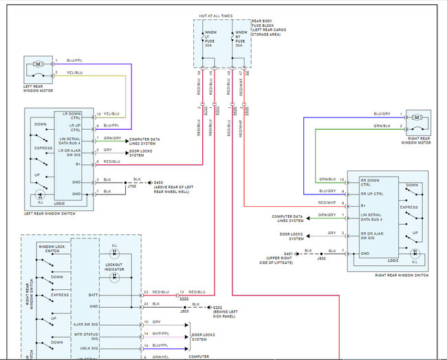

Sure, you can bypass the window motor but make sure to unplug the window switch first. here is the complete window wiring diagrams so you can test the power and grounds, also the motor power and ground as well. This guide may help you as well.
