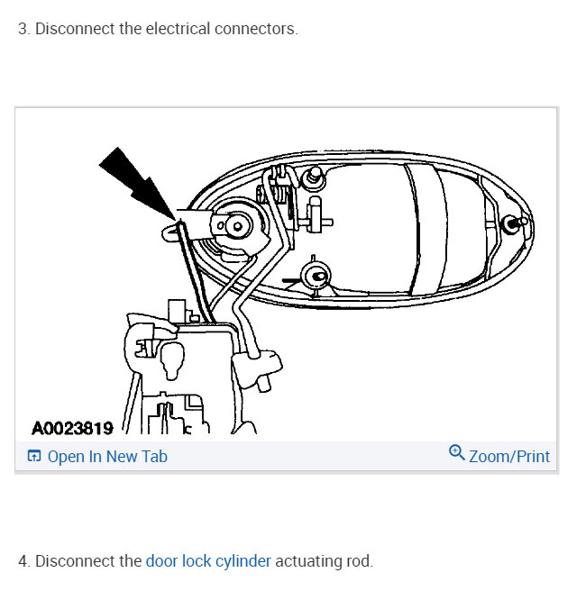

I had to put a new motor for the driver door window. I didn’t remove the old one and had a hard time putting in the new one. I’m not sure it’s in properly because the bolts holding the window to the lifting bar keeps coming off and I have taken it all apart again. This has happened maybe 8 times. So, it’s a continuing problem along with the door not completely closing so the light stays on and kills my battery. What do I do??
Sep 3, 2023 at 1:11 PM
  • 55,456 POSTS

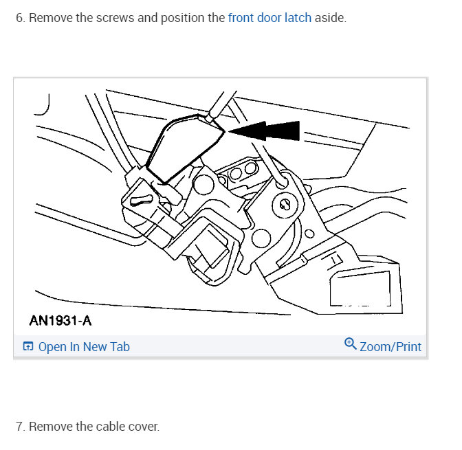

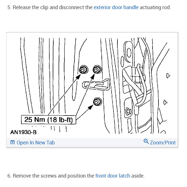

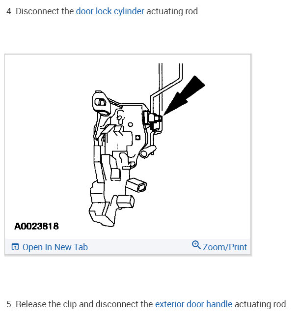

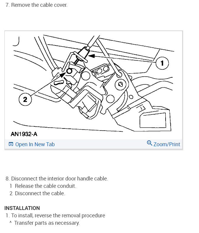

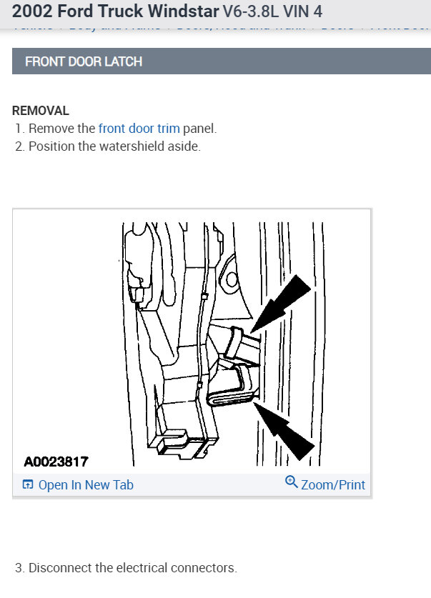

It sounds like the door latch is worn out here is how to switch it out for a new unit. Also, for the window problem please start a new thread. Check out the images (below). Let us know what happens and please upload pictures or videos of the problem so we can see what's going on.
