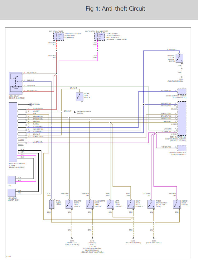

I cannot lock the drivers door with the remote, but can lock/unlock all doors with the key. However, the alarm will not set by doing this and can only lock/unlock the other doors with the remote and activate the alarm.
We replaced the drivers door module, but still no luck.
May 12, 2018 at 10:04 PM
  • 55,748 POSTS

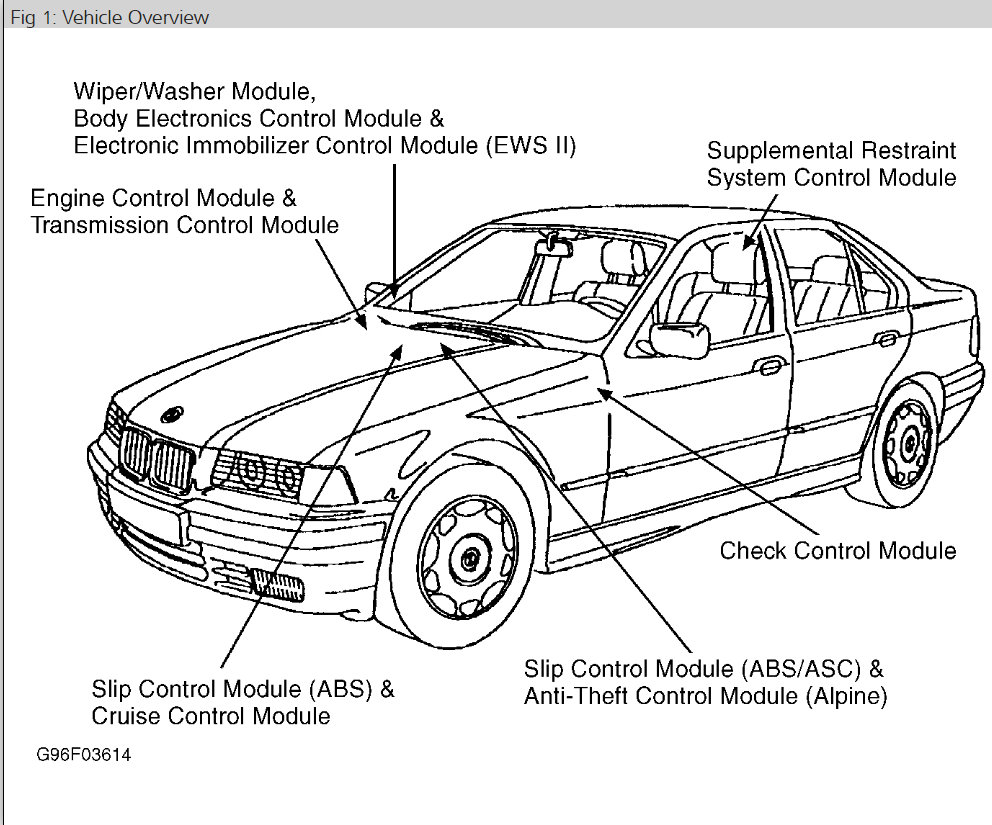

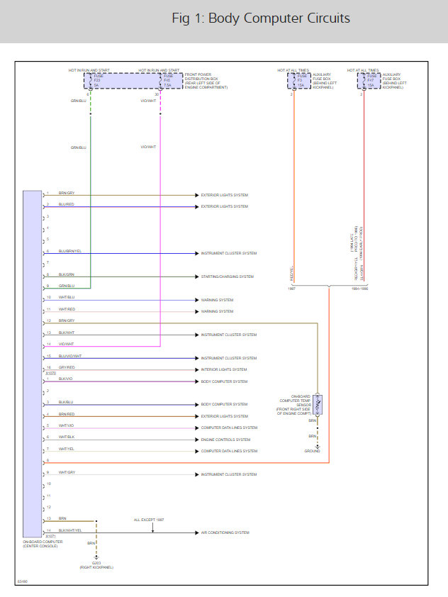

It sounds like the driver door lock driver is out in the security module. Here is a wiring diagrams and a guide to confirm the issue. Check for an output signal from the module.
Check out the diagrams (below). Please let us know what you find.
