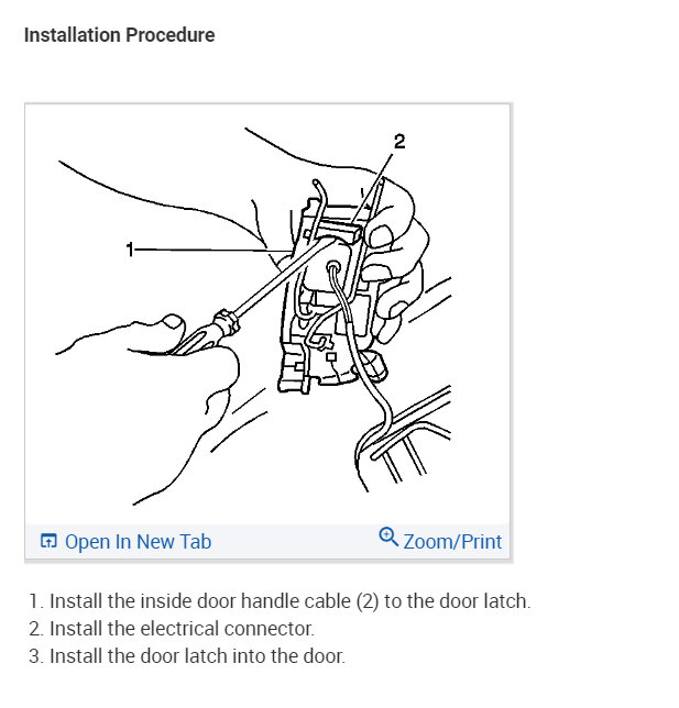

I managed to get the door panel off and tried releasing the latch manually but didn’t get anywhere. I don’t know how I would go about opening the door. I feel like Uber tried everything. I have the new actuator, so I just need to get the door open.

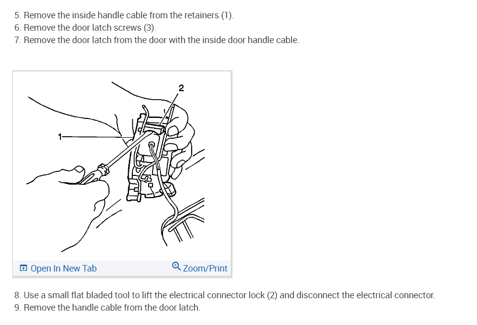

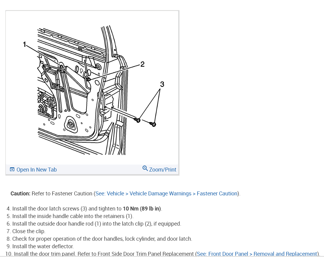

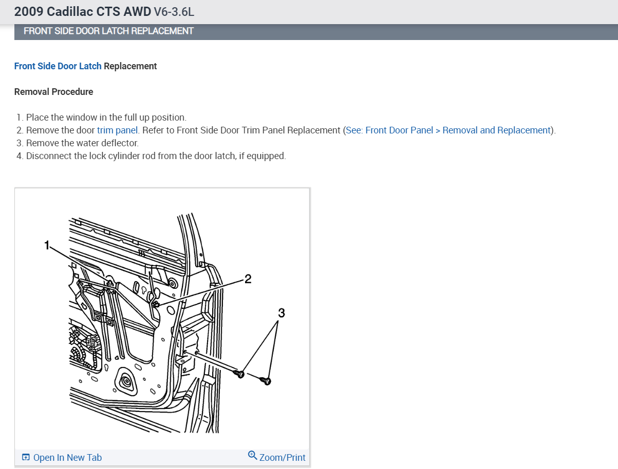

This happens when the latch lock control rod falls off the door latch. You must move the lock control arm on the latch. You can see the lock rod in the images below #2 try to follow it down to the latch to discover the lock arm for the latch. Check out the images (below). Let us know what happens and please upload pictures or videos of the problem.
