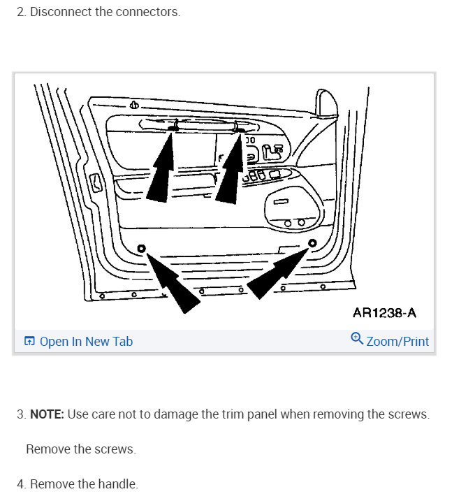

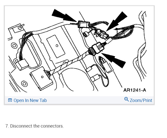

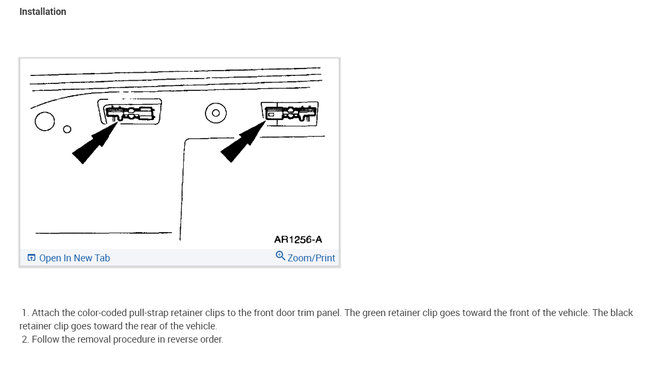

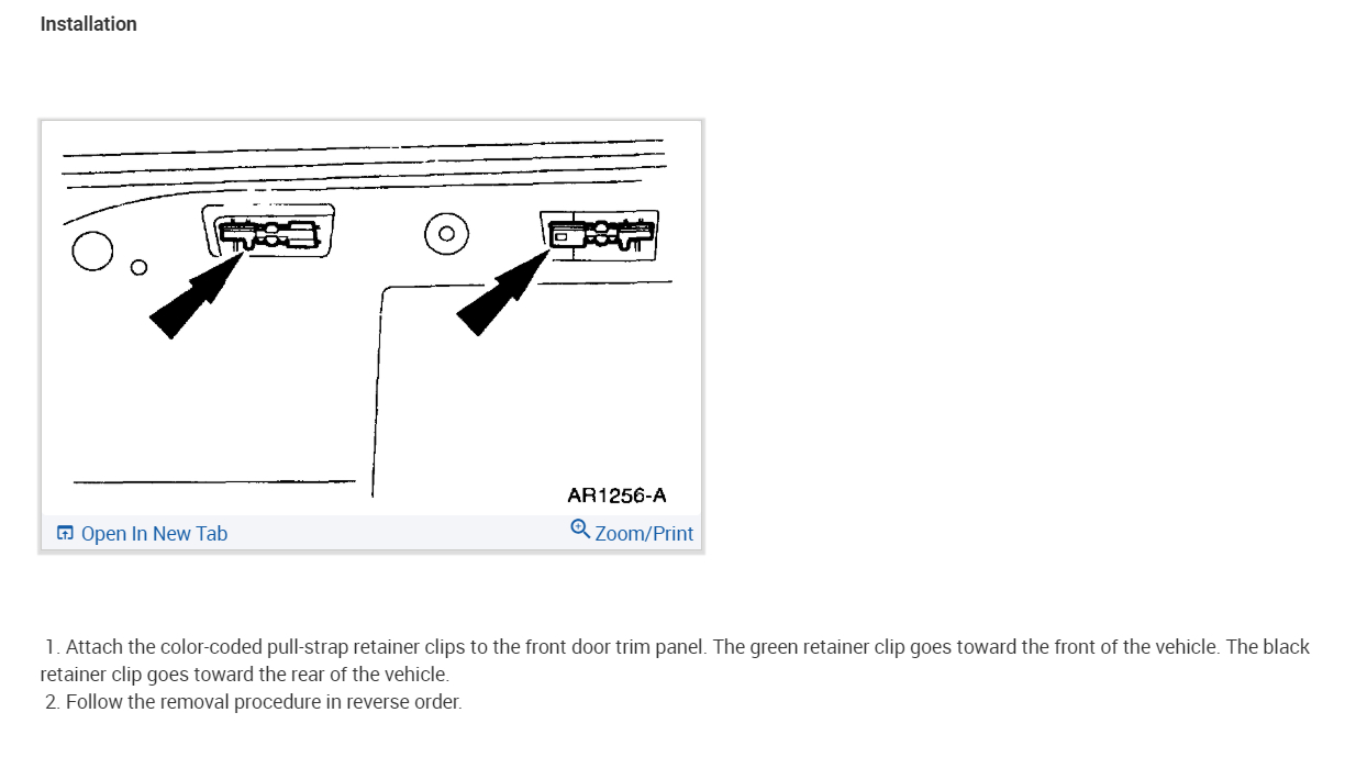

Fasteners (3) for armrest are no longer in place. any way to make repairs without having to remove the door panel?
Aug 7, 2019 at 1:05 AM
  • 55,423 POSTS

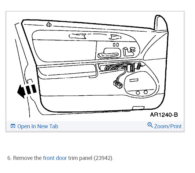

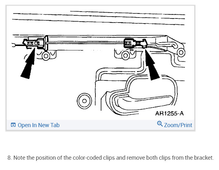

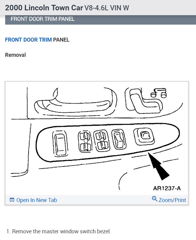

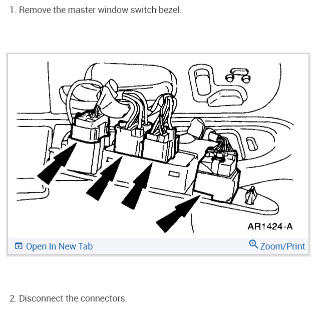

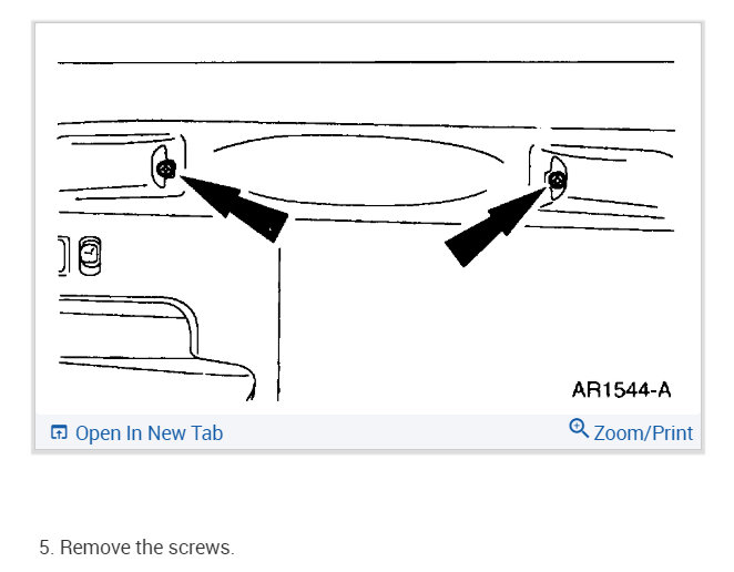

Not really, you must remove the panel to reattach the arm rest. Here is a guide to help you with diagrams below to show you how on your car:
https://www.2carpros.com/articles/door-panel-removal
