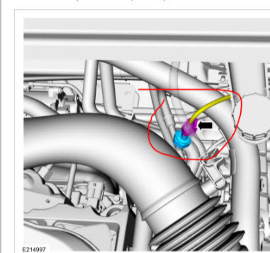

Hi, I have the car listed above that is hard starting, seems to idle okay and at idle, the fuel numbers (live data from autel MaxiSys906) are all in spec. (Code P0087 is present) However with acceleration, the car misfires, lacks power, and the high pressure fuel numbers drop to 150-300psi. The low side numbers are around 100-104. I would like to properly diagnose the car before I put a $200.00 high pressure fuel pump in it. Can you give me a test procedure to isolate the sensors and pumps to make sure I change the right part?

P0087, my first step is to replace the low side pressure sensor. The pressure should be cycling from 90-60 ish. When the sensor fails it will be stuck at one pressure, like 100 or 90-something. The sensor is mounted on the fuel line between the engine and firewall/bulkhead. The Ford basic part number is 9F972.

So, I was planning to replace the high pressure injection pump, but because it didn’t arrive today, i thought i would try your suggestion of changing the low pressure sensor. I replaced it to no avail. So i removed the fuel injection high pressure fuel pump and found a failed cam follower and high wear on the pump as well. Some minor marring of the cam, so i suspect it will go out in the future as well. I’m not sure if this is what you had in mind for next steps, but this is where I am. Any suggestions as to why the B1S1 sensor is stuck rich?

Okay. Mystery solved. Low pressure sensor changed, no result. Snap on software says pump failure is the most probable cause. They were right. Upon removal of the high pressure pump, I discovered that the cam follower was worn through, and the pump actuator was riding on the cam. No Bueno. Owner didn’t agree with my opinion that the flattened lobe on the cam and the missing cam follower parts were ruining the engine and that the only responsible repair was a rebuild. Showed him the known issue documentation from Ford, and so I have to guess the bad news was just hard to accept. Anyway, installed new cam follower with assembly lube, new high pressure pump, and it runs well and all issues resolved. The time bomb went out with a clear and fair warning to the owner that the car was no longer reliable. We can only hope he doesn’t trade it in with this issue disguised by my repair.
