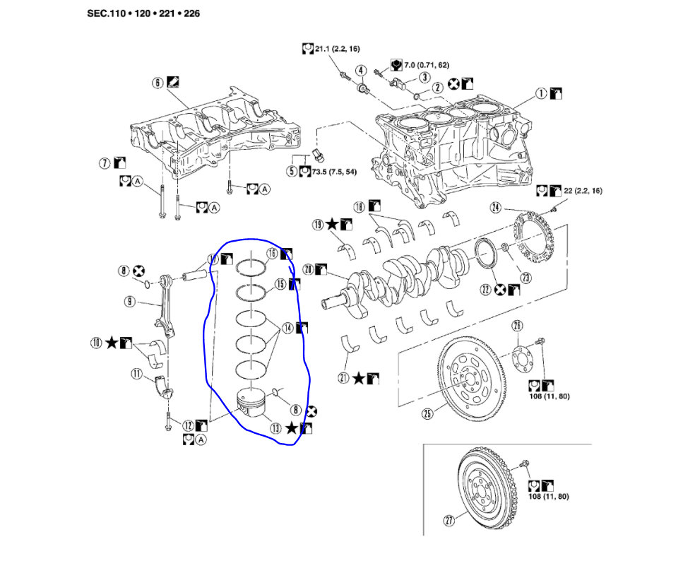

The piston ring for the fourth cylinder is damaged, meaning it gives a (pressure) bigger than the other cylinders, but it does not have blue smoke from the exhaust and has a leak of (coolant) from one of the freeze plug. Is it good and safe to drive it for 400 km or more in a Hight way road? please answer..
Mar 18, 2021 at 3:23 PM
Good morning,
I would not drive it that distance at all. It could very well cause more damage and end up leaving you stranded on the road.
I attached a picture for you of the breakdown of the piston below.
CAUTION:
Apply new engine oil to parts marked in illustration before installation.

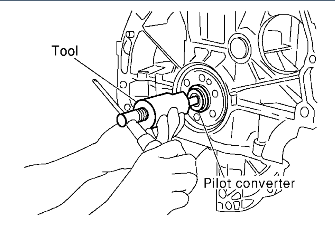

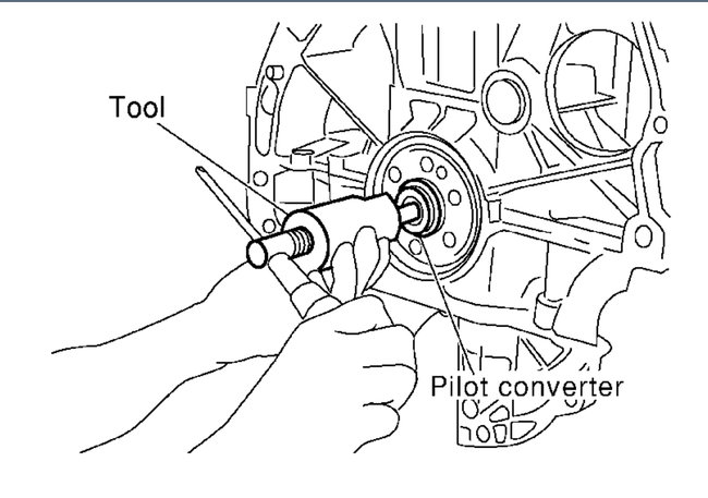

8. Remove pilot converter using Tool (CVT models).
Tool Number : ST16610001 (J-23907)

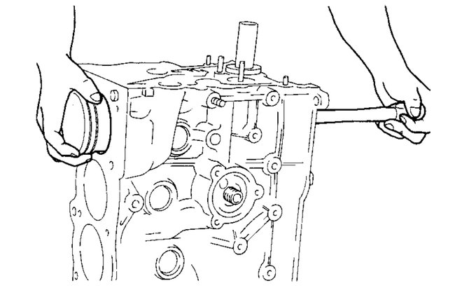

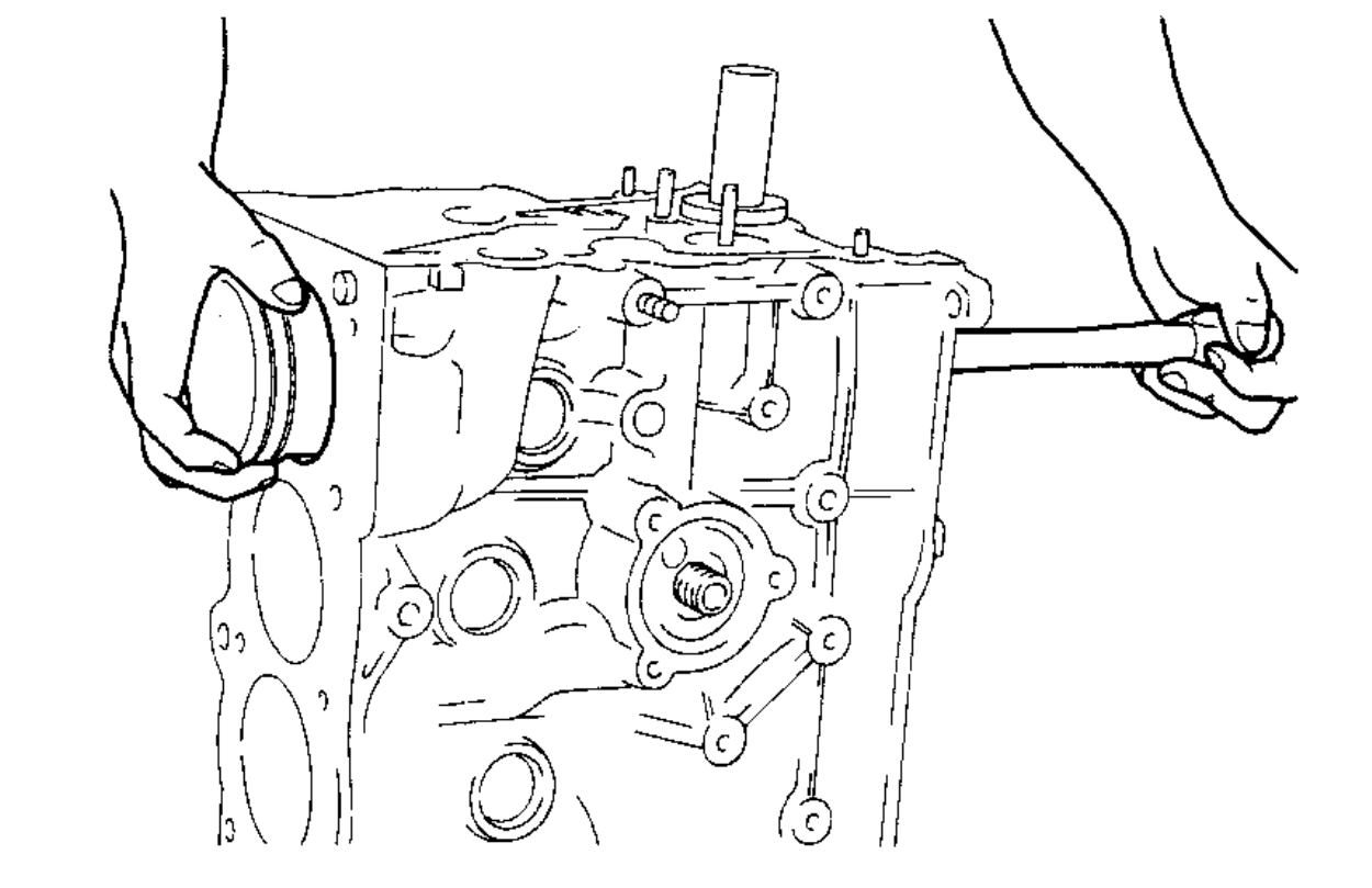

9. Remove the piston and connecting rod assemblies.
a. Position the crankshaft and corresponding connecting rod, to be removed, to the bottom dead center stroke.
b. Remove the connecting rod cap. Number the cap so it can be assembled in the same position.
c. Using a hammer handle or similar tool, push the piston and connecting rod assembly out of the top of the cylinder block. Number the piston and rod so it can be assembled in the same position.

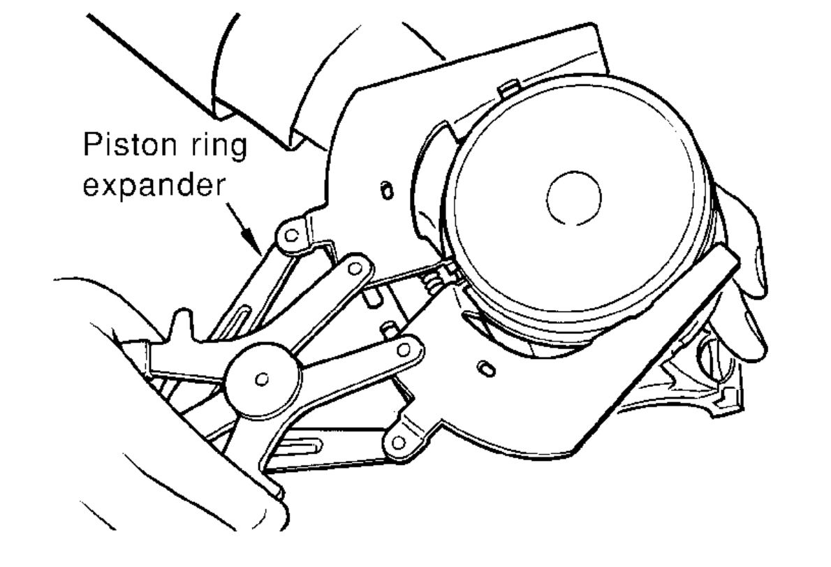

11. Remove the piston rings from the piston.
- Use a piston ring expander.
- Before removing the piston rings, check the piston ring side clearance. Refer to See: Cylinder Block Assembly > Overhaul > Inspection.
CAUTION:
- When removing the piston rings, be careful not to damage the piston.
- Be careful not to damage piston rings by expanding them excessively, if reusing them.

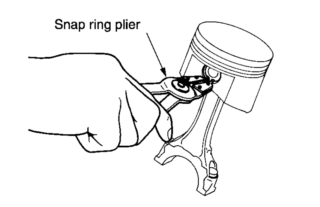

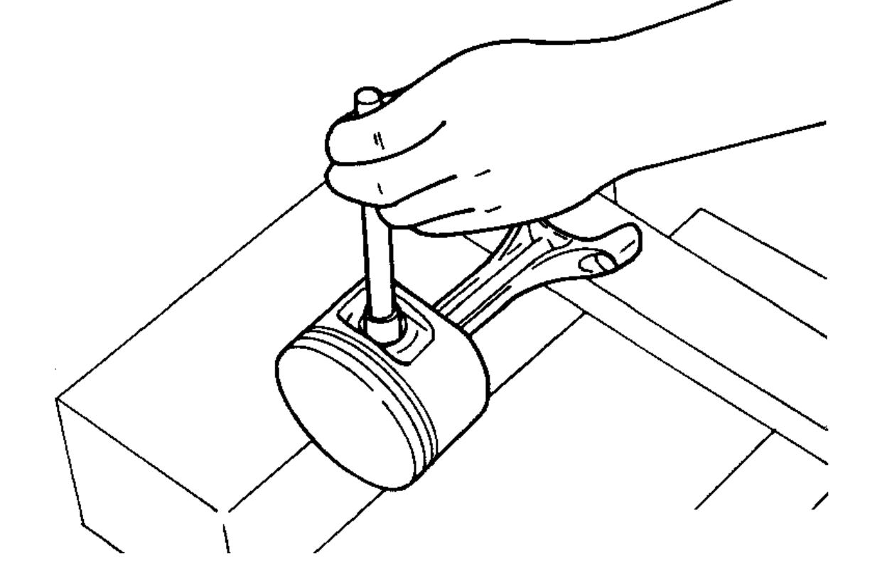

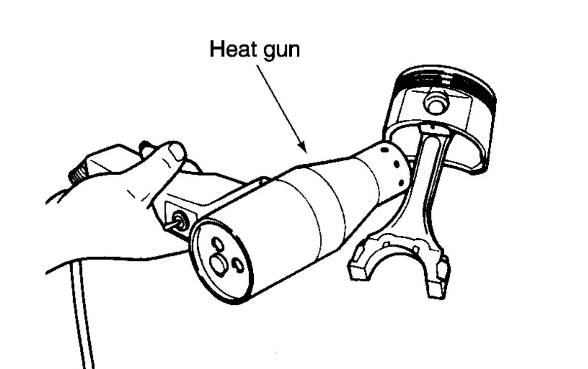

12. Remove the piston from the connecting rod as follows.
a. Using a snap ring pliers, remove the two snap rings.
b. Heat the piston to 60 - 70 C (140 - 158 F) with a heat gun, or equivalent.
c. Push out piston pin with a punch of an outer diameter of approximately 19 mm (0.75 in).

what kind of damage? can you explain more please?
Mar 19, 2021 at 3:53 AM
To the engine block itself. The piston could fracture and seize the engine.
Mar 19, 2021 at 4:08 AM
PORTGAS D ACE
  • 28 POSTS
what if I drive slowly and at low rpm??? please answer.
Mar 19, 2021 at 4:19 AM
Same answer. Any type of driving can cause catastrophic damage.
