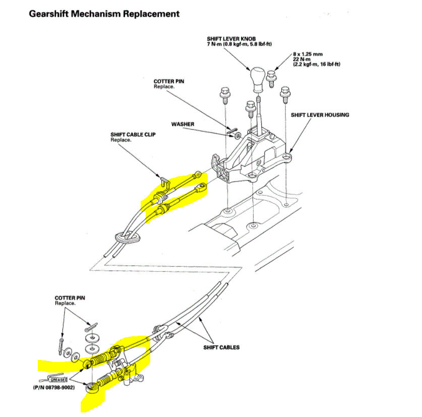

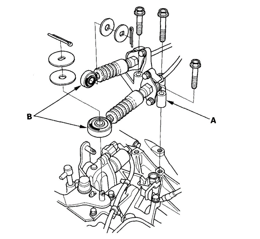

My stick shift is stuck in second gear when you drive, but the shifter moves back and forth still like its broke.
Dec 29, 2021 at 12:13 PM
  • 110,241 POSTS
It sounds like one of the shift cables came disconnected or has broken. Do me a favor. Have a helper shift through the gears while you watch at the transmission to see if the cables are moving the shift levers. Note: There is a mount that holds the cables in place at the transmission and clips at the shifter itself.
See pics 1 and 2 to help identify parts.
