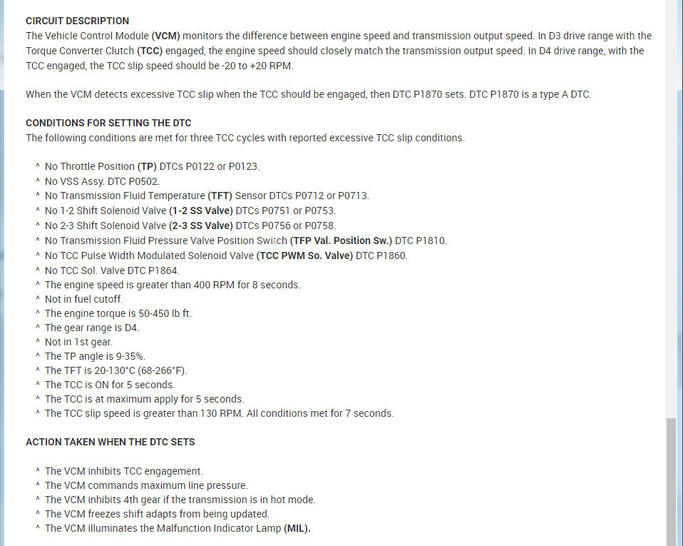

Hi thanks for the reply! I was in 2wd when I heard the bang! However I noticed the 4wd didn't work before that. I hear the 4wd low engage and indicator lights work appropriately! But front wheels do not spin with my rear ones in the mud!? Concerning the bang and slipping I have a po1870 code. Along with po 171 and 174 now! I don't think they are related to the transmission slipping!? I'm looking at a master solenoid replacement kit right now for the slipping!? All gears work just sluggish slipping into first!? Thank you!

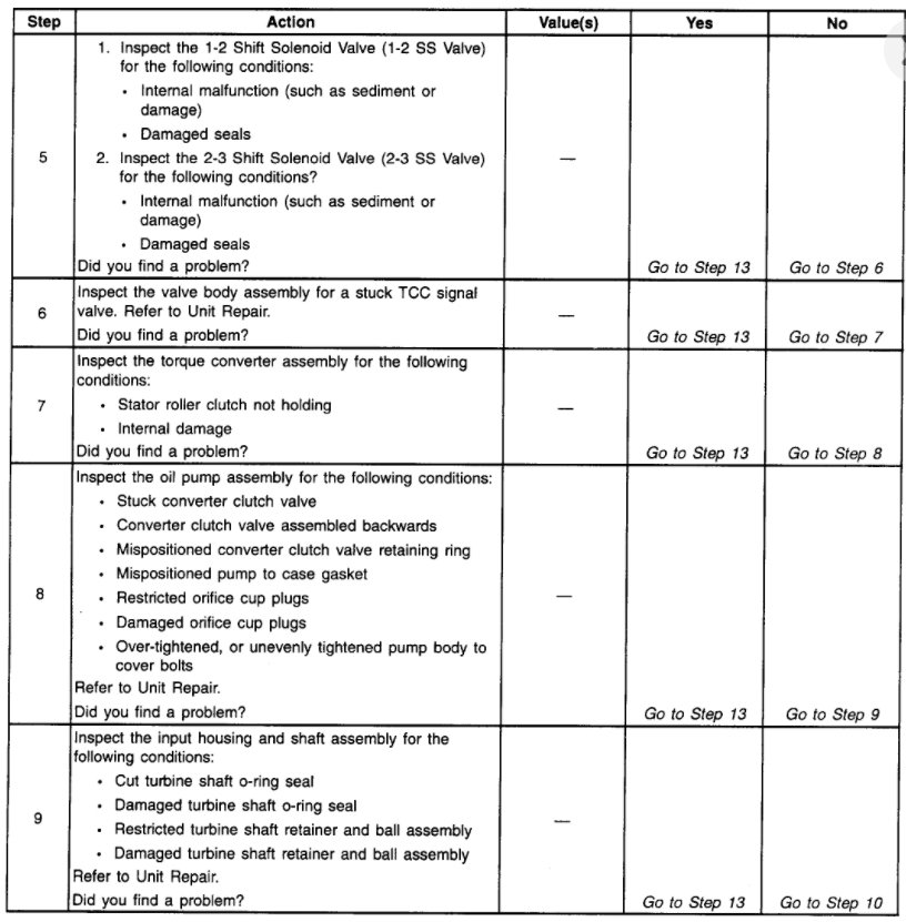

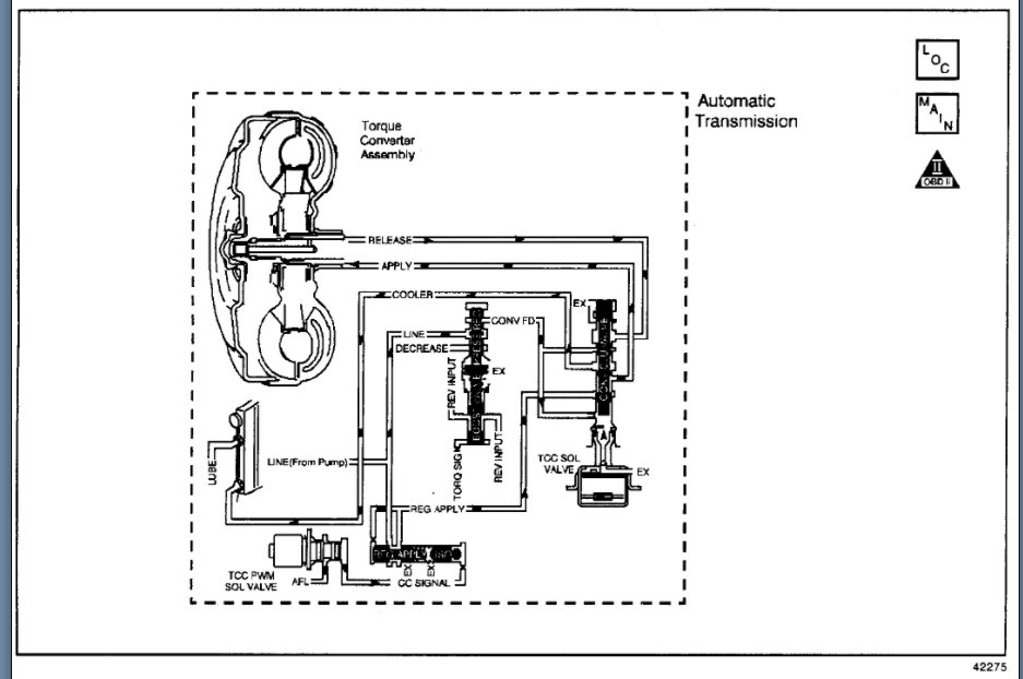

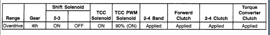

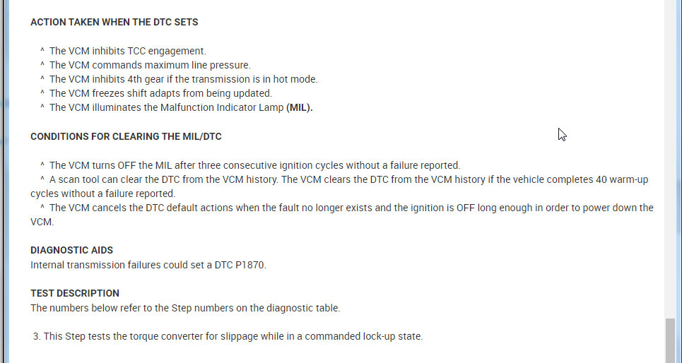

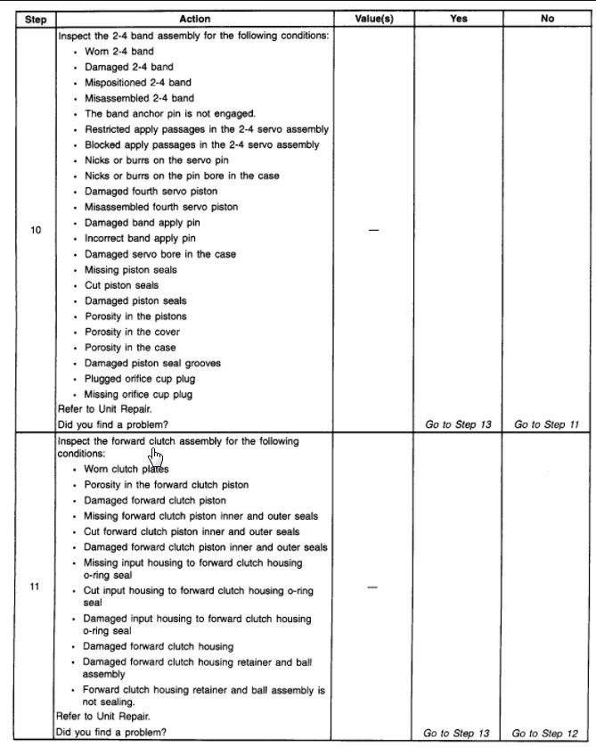

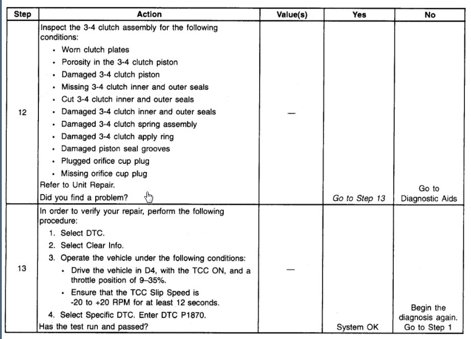

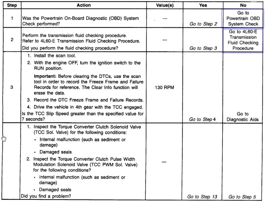

The P1870 would cause the issue in the transmission but the lean codes would not.
I attached the info below of the P1870 code for your review. Please let us know if you have questions on working through this. Also, the 4WD issue is most likely the encoder motor but would not be related to the shifting issue so let's focus on that one here and then get new posts started for the other issues as we need to keep each issue to one topic.
