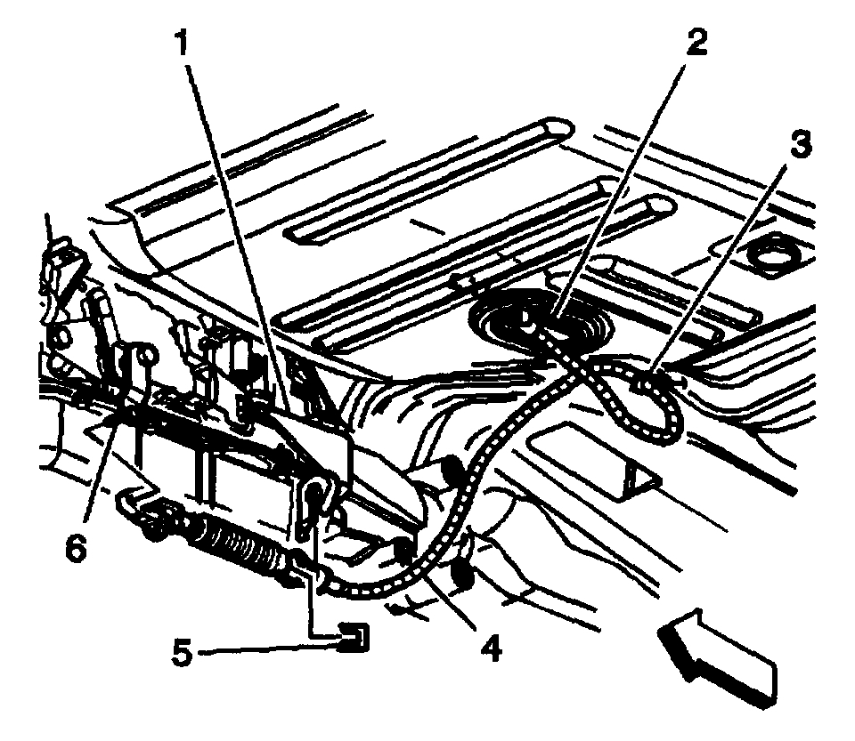

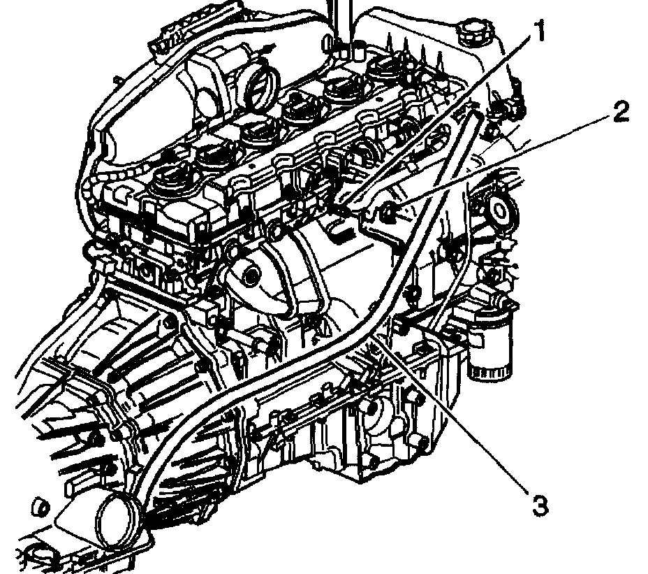

I am attempting to replace the transmission, and I cannot be sure the car is in neutral. However, I know it is in all other gears but park. I have also manually shifted the car into all shifts and the drive shafts wont move throughout all of the shifts.
Jun 21, 2020 at 6:30 PM
  • 110,194 POSTS
If that is the case, something has broken internally in the transmission and preventing it from turning. It could be the actual parking pawl linkage in the transmission isn't disengaging it.

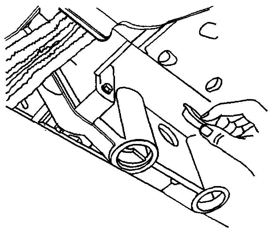

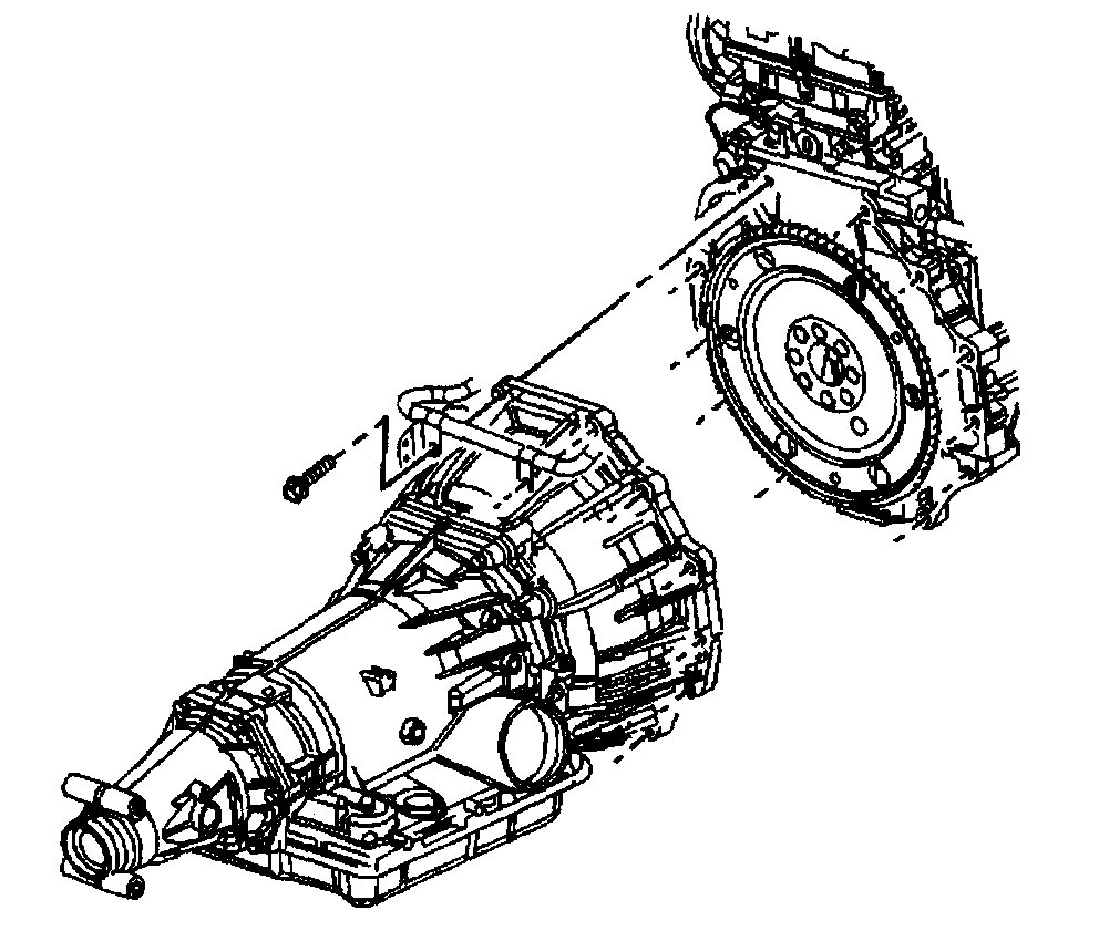

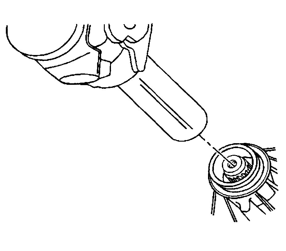

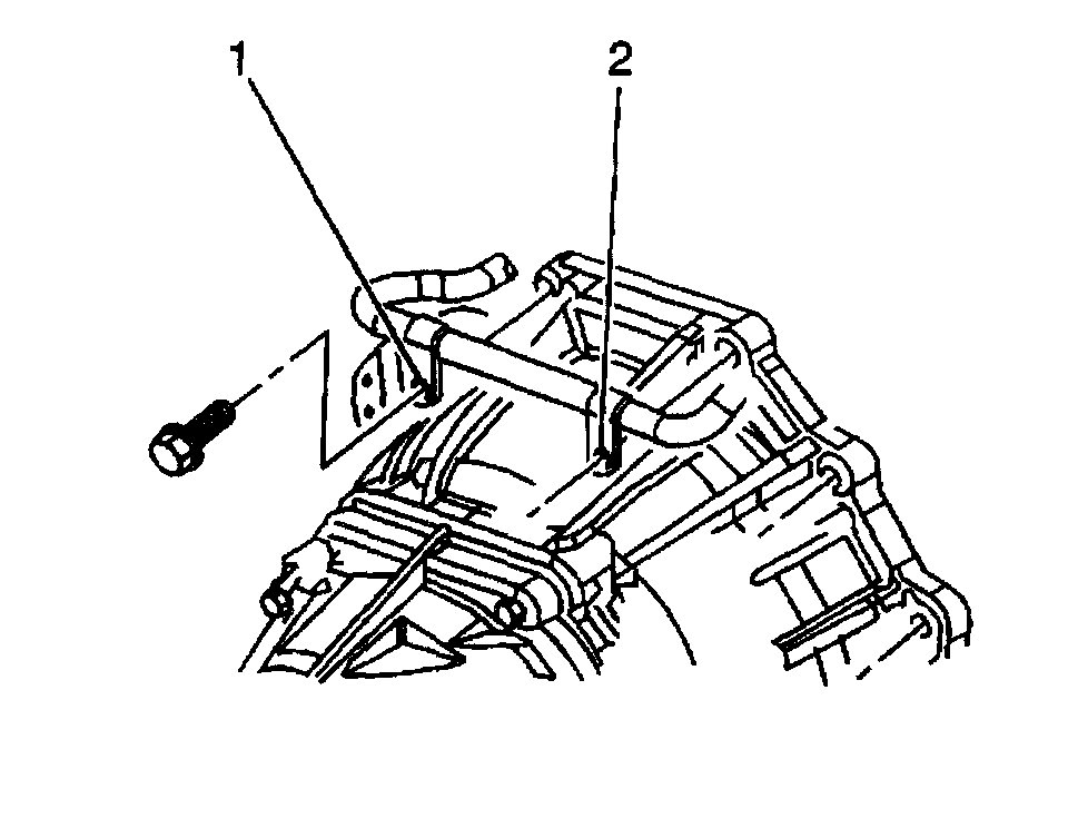

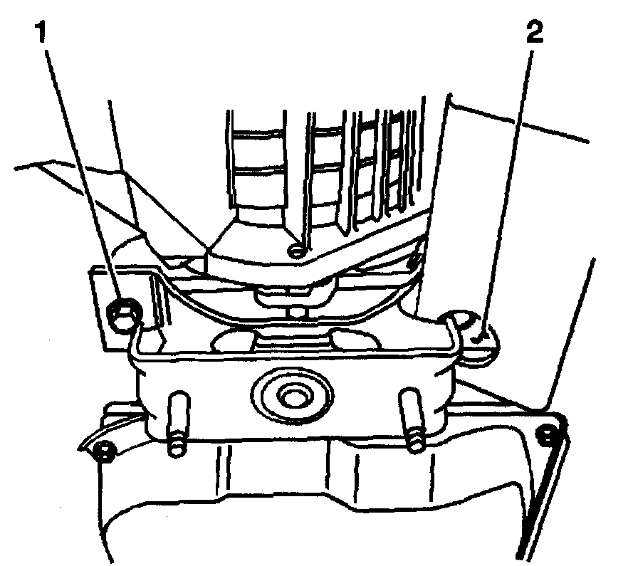

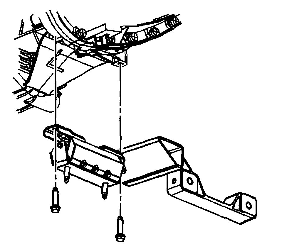

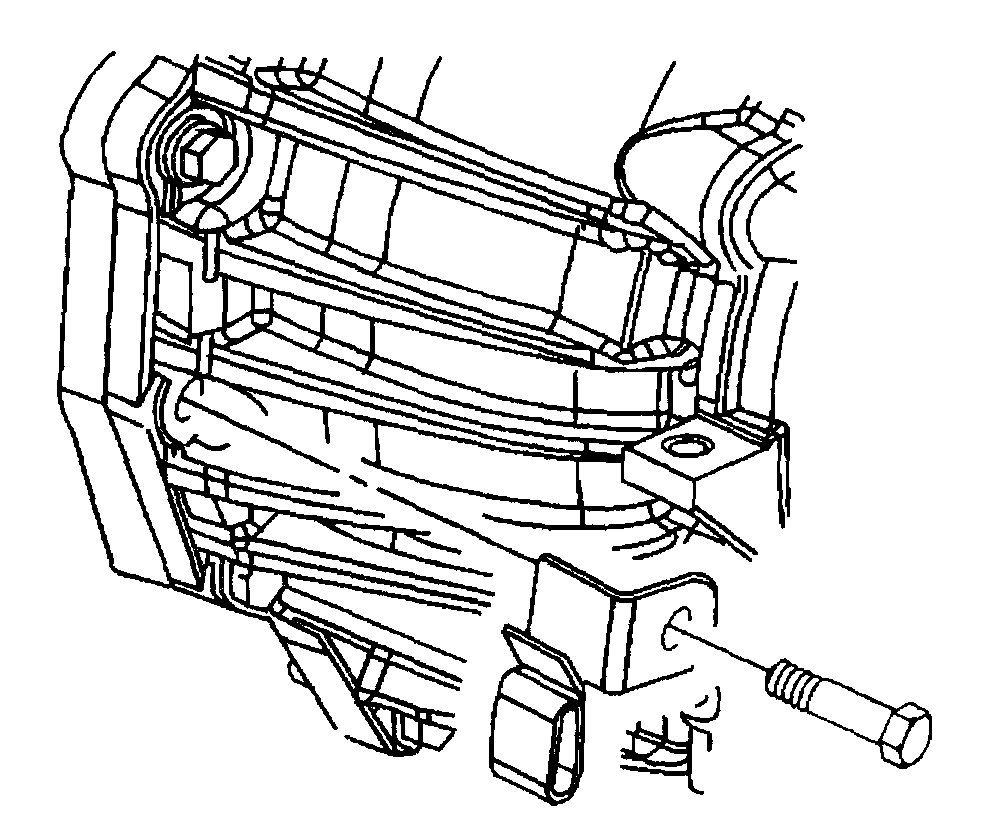

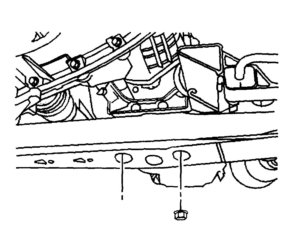

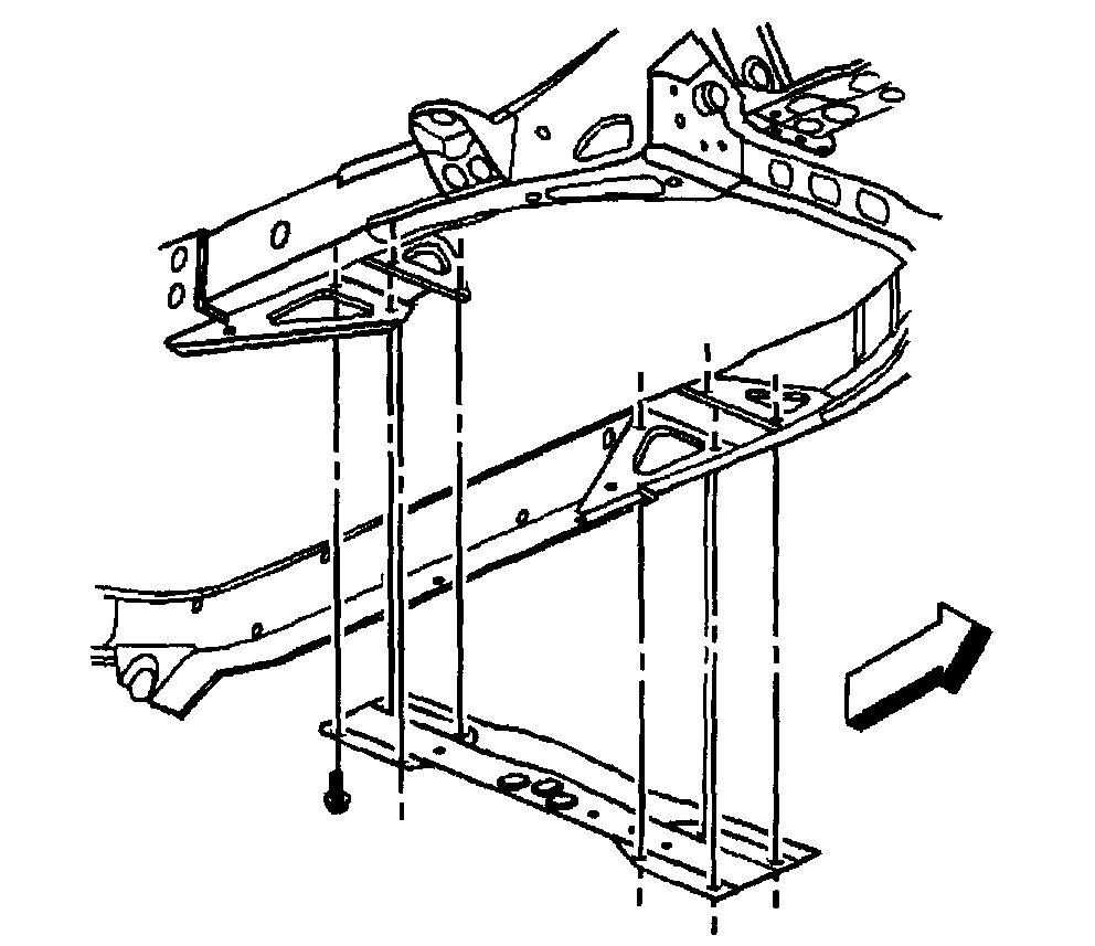

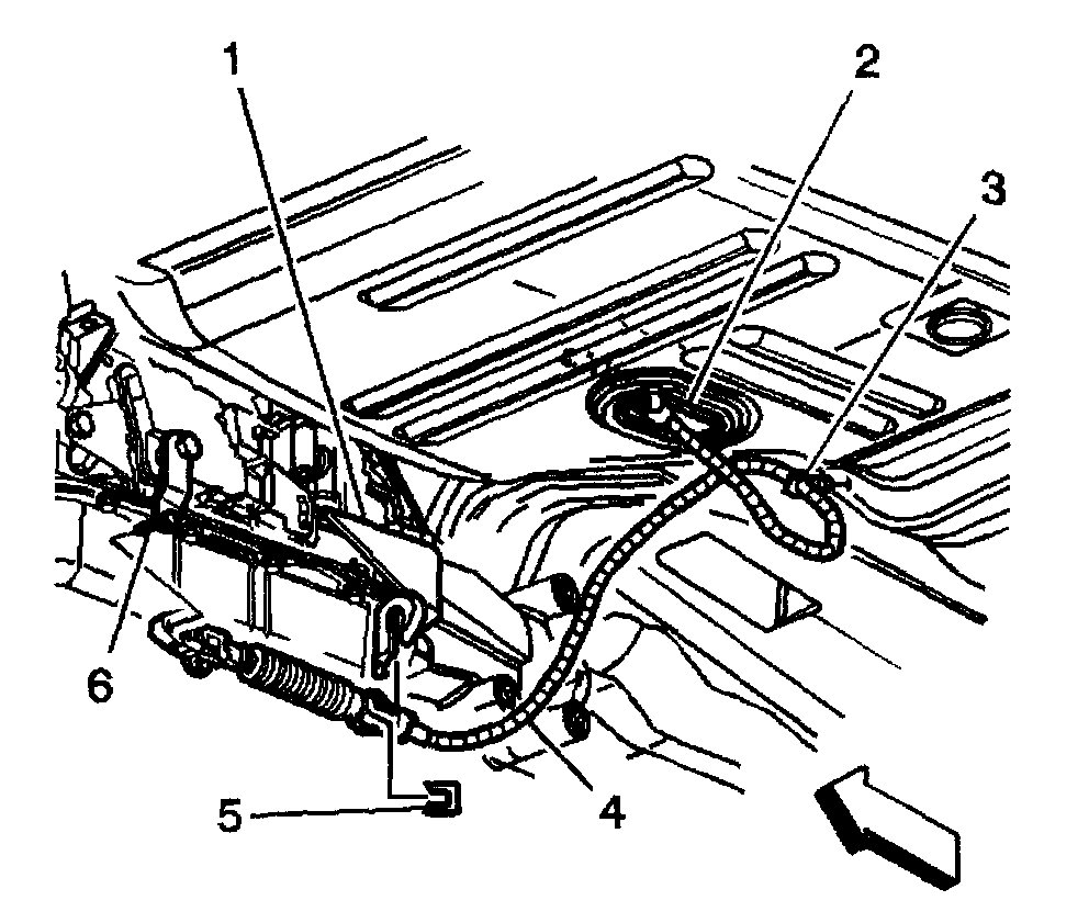

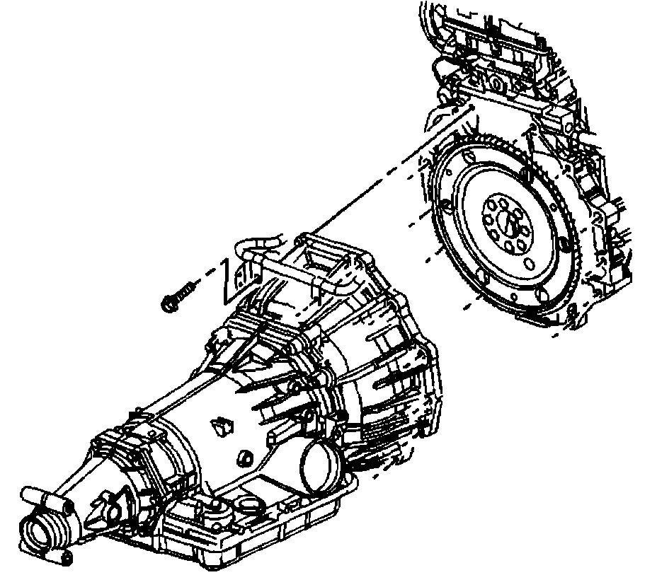

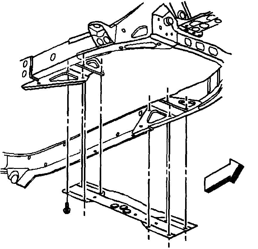

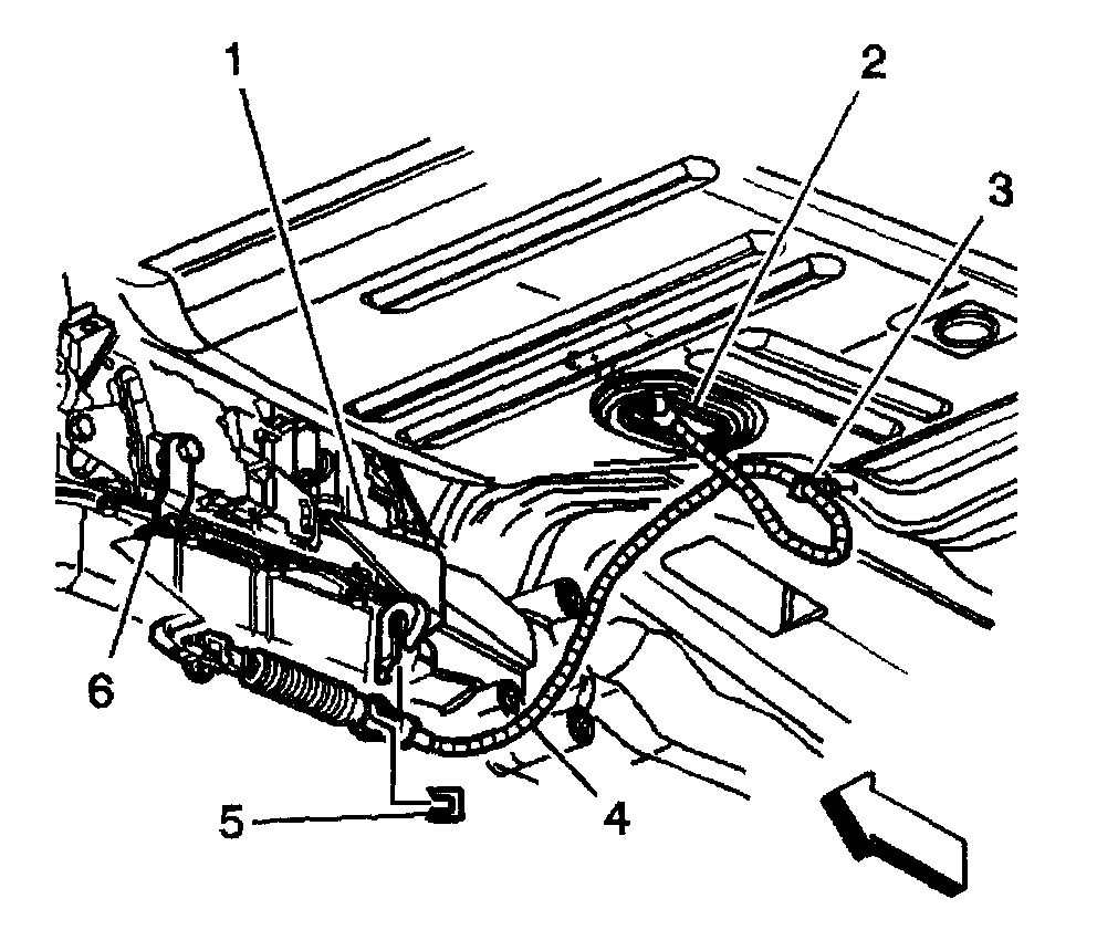

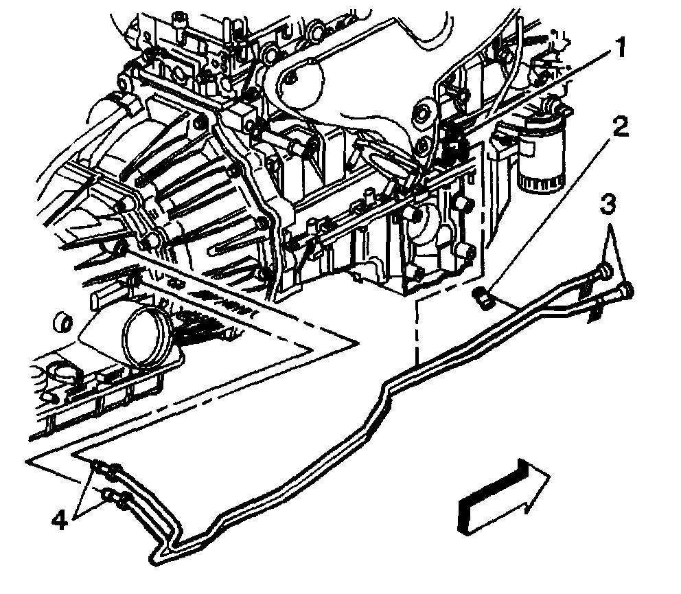

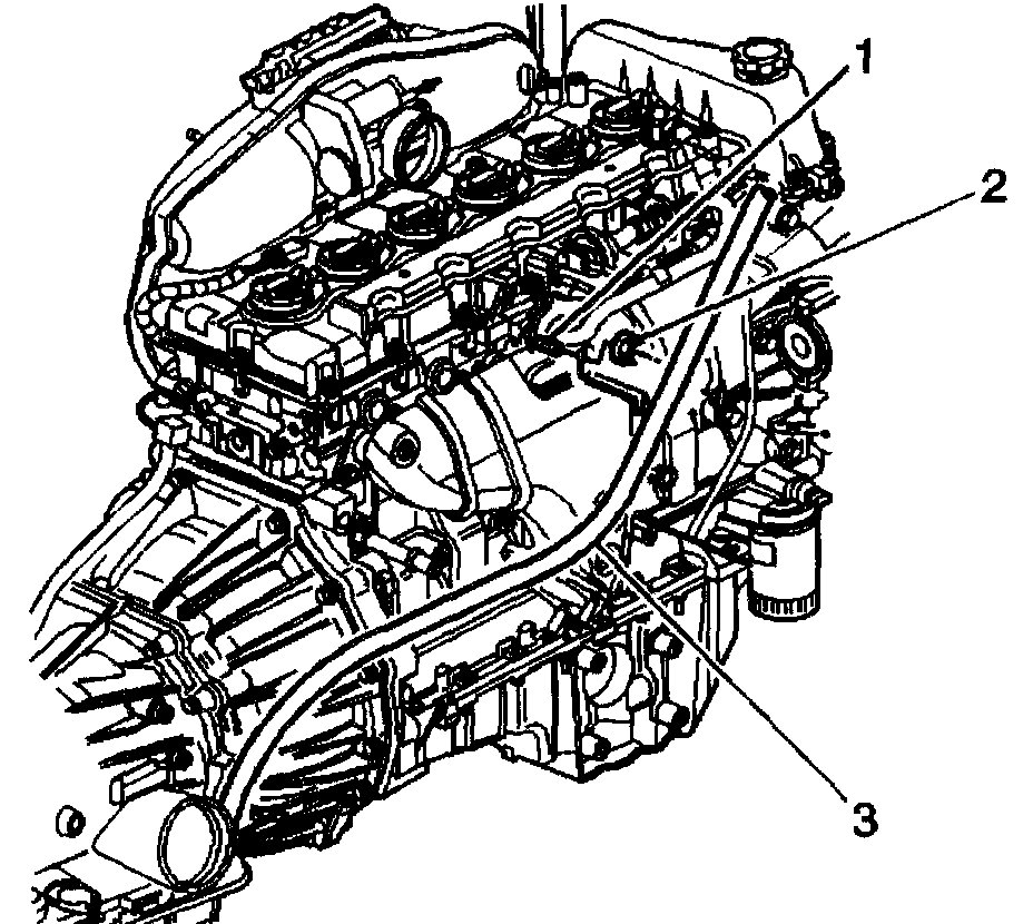

Since you are removing the transmission, here are the directions. The attached pics correlate with the directions.

TRANSMISSION REPLACEMENT

pic 1
1. Disconnect the battery.
2. Remove the filler tube nut (2) located on the right side of the engine.

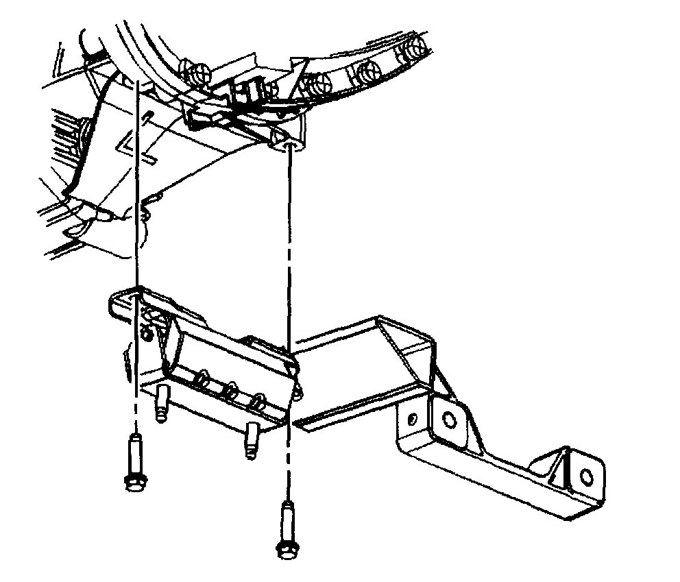

pic 2
7. Remove the nuts securing the transmission mount to the transmission support.

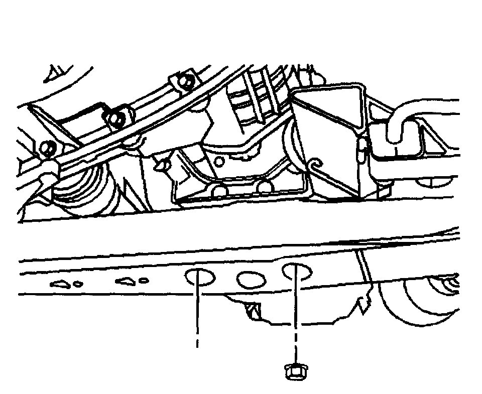

pic 3
8. Remove the Evaporative Emission (EVAP) canister from its mounting bracket on the left inside of the frame to gain access to the transmission support bolts. Do not disconnect the canister lines.
10. Remove the transmission support from the vehicle.
pic 4
11. Remove the transmission mount bolts (1,2).

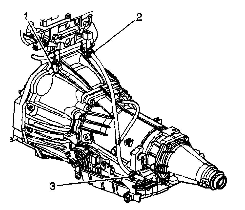

pic 6
16. Remove the range selector cable end from the transmission range selector lever ball stud (6) and the bracket (1).
18. Disconnect the transmission vent hose, the park/neutral position switch connector, and the main electrical connector from the transmission.
19. Remove the bolt that secures the fuel line bracket to the left side of the transmission.
pic 7
20. Remove the torque converter access plug.
21. Mark the flywheel and torque converter orientation for reassembly.
22. Remove the flywheel to torque converter bolts. Use care not to drop the bolts into the bell housing.
23. Disconnect the transmission oil cooler lines from the transmission.
24. Plug the transmission oil cooler line connectors in the transmission case.
25. Install a safety chain around the transmission.
pic 8
26. Remove the bolt that secures the fuel line bracket to the bell housing.
pic 9
27. Remove the bolts (1,2) that secure the coolant pipe to the bell housing.
pic 10
28. Remove the remaining nuts, studs and/or bolts that secure the transmission to the engine.
29. Install the J21366 onto the transmission bell housing to retain the torque converter.
30. Pull the transmission straight back.
31. Remove the transmission from the vehicle.

14. Install the transmission mount to the vehicle.
15. Install the bolts (1,2) securing the transmission mount to the transmission.
Tighten the bolts to 25 Nm (18 ft. lbs.).

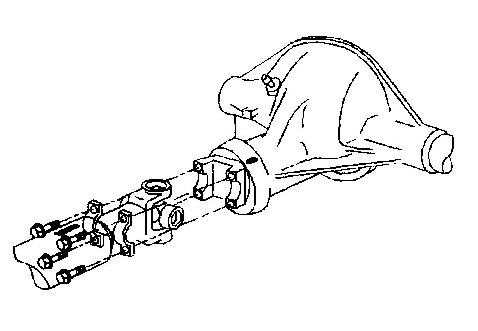

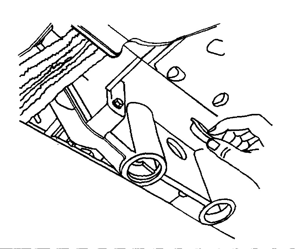

This definitely helps. Thank you. I still have a few questions though. I am not sure. Is the filler tube nut accessed from the hood? How am I supposed to get the rear drive shaft to turn so I can remove it? Do I not need to remove the front drive shaft as well? Also, I know I need to to crank the engine manually to remove the torque converter bolts, but where is the engine crank? I don't understand disconnecting the oil cooler lines from the transmission and plugging them back into the transmission case either. Why disconnect then reconnect? Am I draining fluids from them? I know I have a lot of questions. Thank you for all your help. I appreciate it.
Jun 23, 2020 at 3:43 PM
  • 110,194 POSTS
As far as the dipstick tube, you should be able to access it from the top. Now, the cooling lines need disconnected from the transmission for the trans to be removed. They want you to plug the openings to prevent spillage and to prevent dirt from getting in. In your case, be more concerned about the lines themselves and not the trans since you are replacing it.

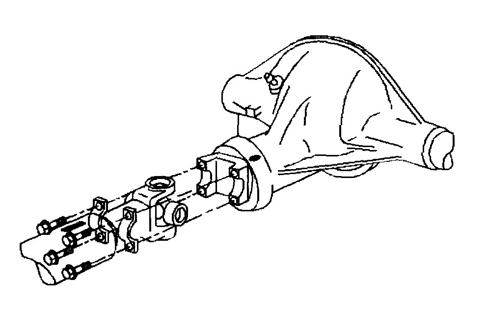

Now for the drive shaft that won't turn where it bolts to the rear differential, you will see there are two U bolts which hold a universal joint on the differential. Remove the four bolts from the two u bolts and disconnect the rear of the drive shaft from the differential. Then, the drive shaft will slide out of the rear of the transfer case. It isn't bolted there. Here are the directions specific for your vehicle's rear drive shaft removal. The attached pics correlate with the directions.

pic 1
1. Raise the vehicle. Refer to Vehicle Lifting.
2. Reference mark the propeller shaft to the rear axle pinion yoke.
3. Reference mark the propeller shaft to the transmission or transfer case.
4. Remove the bolts and the yoke retainers from the rear axle pinion yoke.
Notice: When removing the propeller shaft, do not attempt to remove the shaft by pounding on the yoke ears or using a tool between the yoke and the universal joint. If the propeller shaft is removed by using such means, the injection joints may fracture and lead to premature failure of the joint.

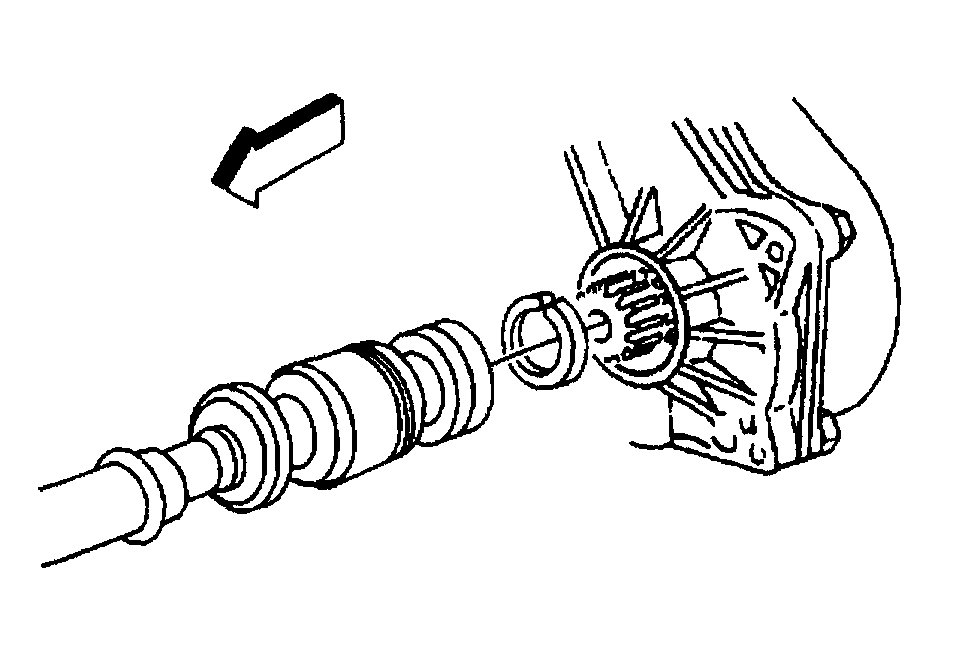

5. Slide the propeller shaft forward in order to disconnect the propeller shaft from the rear axle pinion yoke.
pic 2
6. Slide the propeller shaft rearward in order to disconnect the propeller shaft from the transmission or transfer case.
7. Remove the propeller shaft.

pic 3
1. Inspect the splines of the slip yoke for a sufficient coating of grease. If the splines of the slip yoke does not have a sufficient coating of grease lubricate the shaft with grease (GM P/N 12377985 or equivalent).
2. Install the propeller shaft into the transmission or transfer case.
Align the reference marks made during removal.

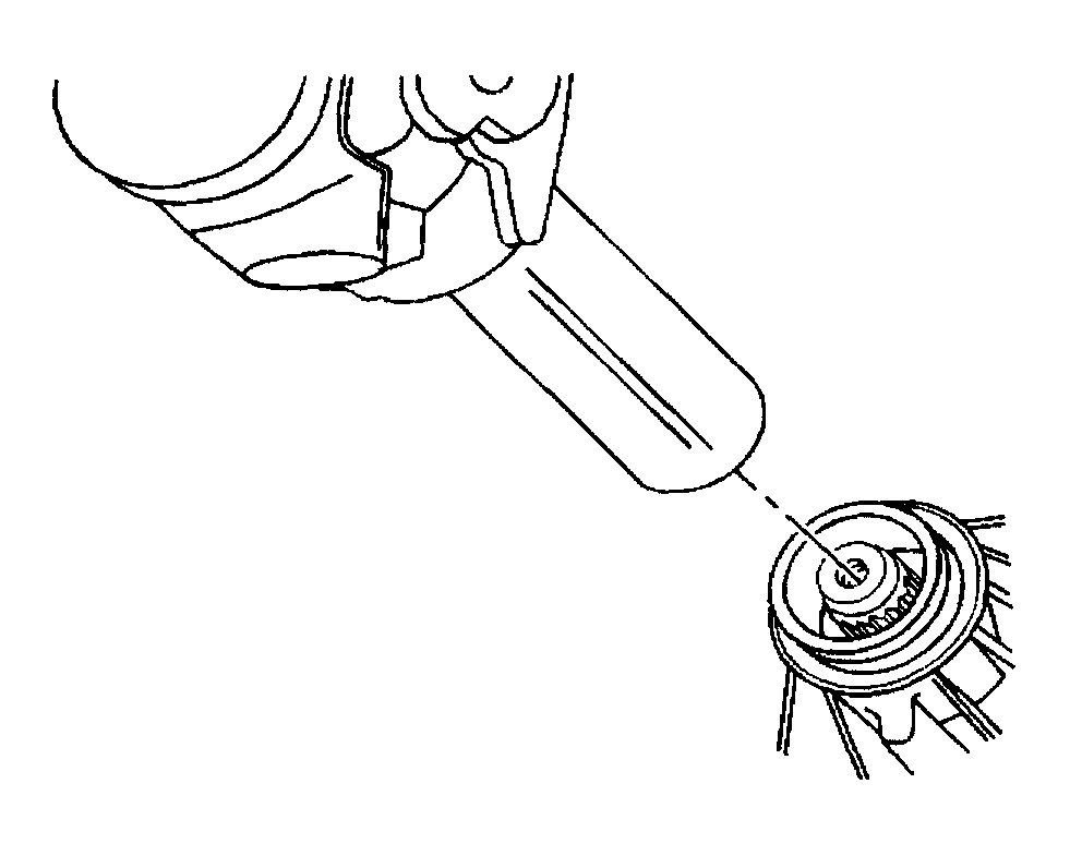

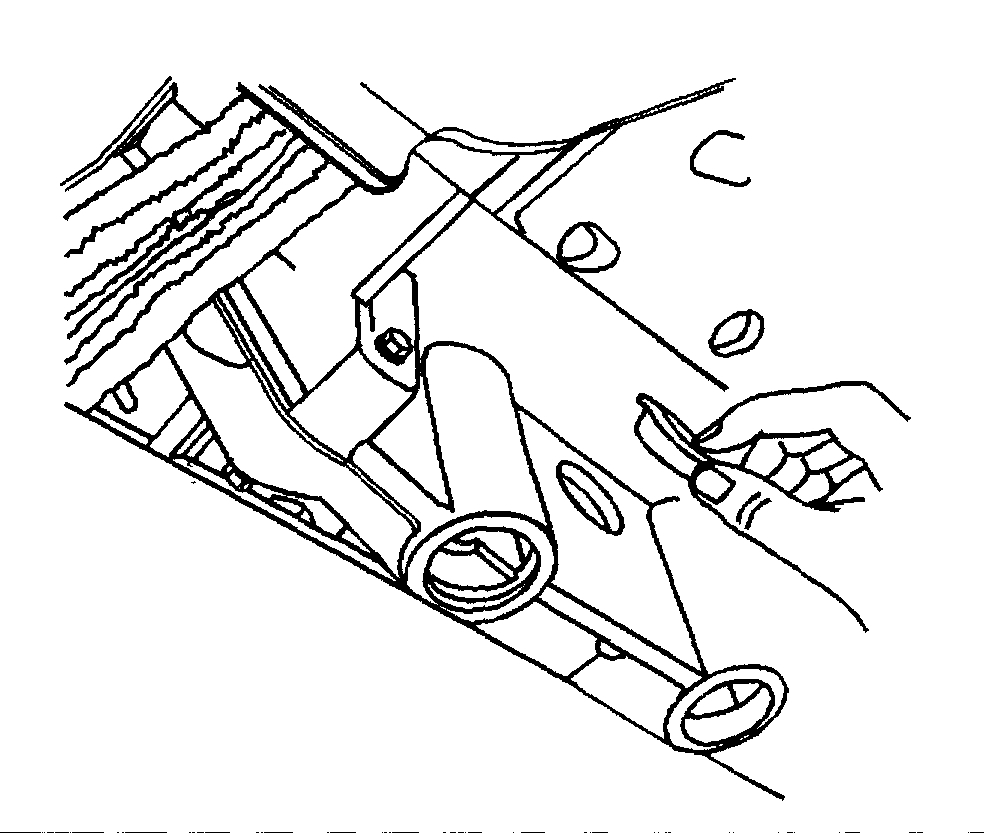

pic 5
2. Reference mark the relationship of the propeller shaft to the front axle pinion yoke.
3. Remove the yoke retainer bolts and yoke retainers from the front axle pinion yoke.
4. Disconnect the propeller shaft from the front axle pinion yoke.
Wrap the bearing caps with tape in order to prevent the loss of bearing rollers.
5. Remove the propeller shaft from the transfer case.

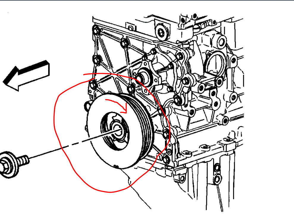

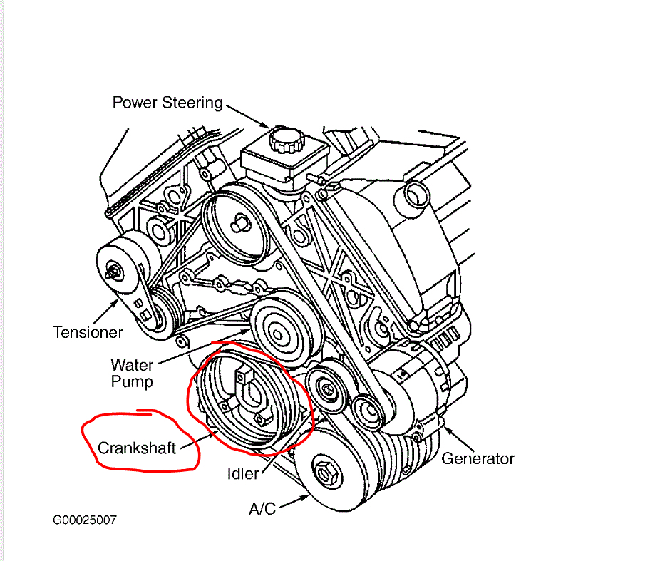

As far as turning the crankshaft, at the front of the engine at the bottom is the crankshaft pulley. It is what the serpentine belt rides on. If you look at the last pic below, I circled it. That is what you will turn. It will not be easy to turn, so you may need to put a socket on the center bolt holding it on to the crankshaft and then a long handled ratchet or breaker bar to actually turn the engine. Please make sure the battery is disconnected before doing any of this work and make sure the ignition key is in the off position.
Let me know if this helps.

Absolutely you can tap in the driveshaft with a plastic hammer. As far as the upper bolts, can you get them with a box end wrench rather than a socket?
As far as the crankshaft, open the hood and follow the serpentine belt. It will be at the bottom of the engine. Take a look at the pic I attached and let me know if that helps. As far as access, you can get to it from top or bottom, but it would be easier from the bottom.

Jun 28, 2020 at 12:39 PM
  • 110,194 POSTS
The U-joint requires the driveshaft to be removed. If you need to use something heavier to remove it, just plan to replace it. Also, is it possible to get a pic of the u-joint? I would like to be more helpful and if I could see what you are dealing with, I may be able to.
Jun 28, 2020 at 9:48 PM
